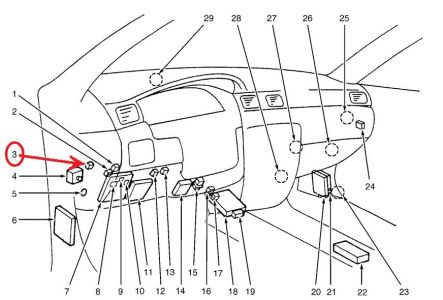

where is the relay for cruise control on 98 nissan sentra. Can't find any thing marked cruise control. How is it marked and what color and pin configuration. And please where is it located. Thanks in advance.

The ASCD hold relay is the relay with the cruise system on circuit. This relay is located behind the left side of the dash, pictured below.
https://images.2carpros.com/forum/automotive_pictures/261618_Noname_2483.jpg
