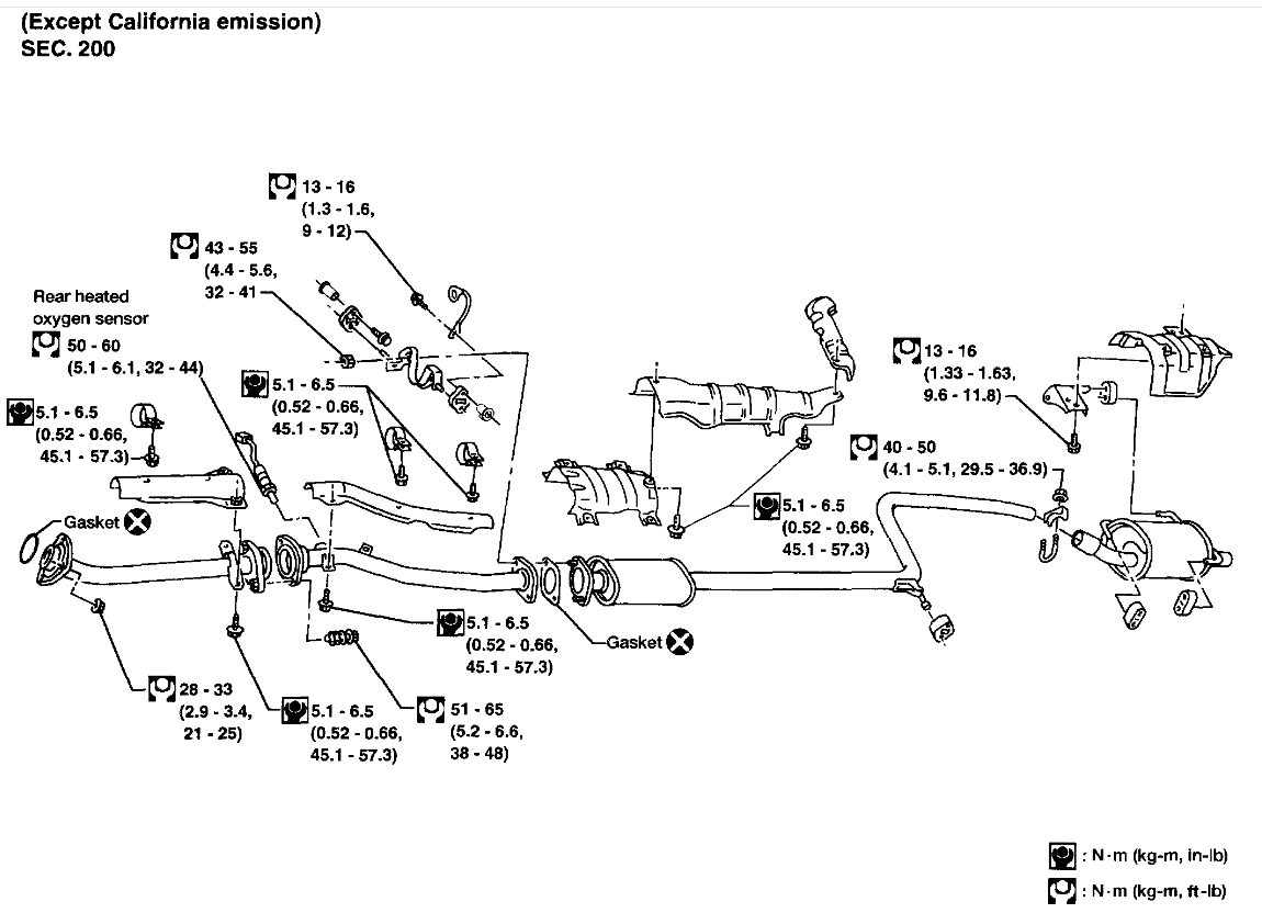

Have the exhaust system inspected could be the catalytic converter is clogged-up, also the fuel pressure.
Wednesday, December 12th, 2007 AT 7:49 PM
KEN L
  • MASTER CERTIFIED MECHANIC
  • 47,651 POSTS
I agree with RASMATAZ, it sounds like the catalytic converter is starting to clog up but to be sure please use this guide below to confirm the issue.
and this guide can help as well
https://www.2carpros.com/articles/engine-has-low-power-output
Here is an images of the exhaust system so you can see where the catalytic converter is for testing. It is in the middle of the system. Check out the images (below). Let us know how it goes
