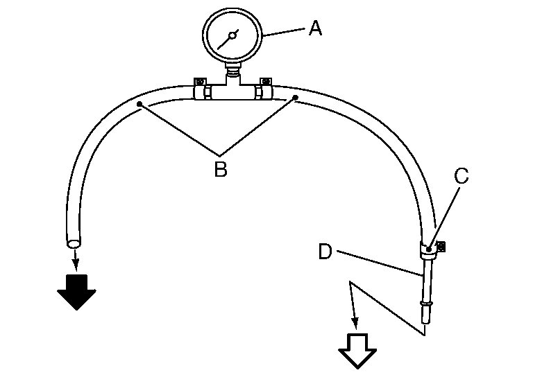

Picture 1
2.Prepare fuel hose for fuel pressure check (B) and fuel tube adapter [SST: KV1011840] (D), then connect fuel pressure gauge (A).
Picture 2

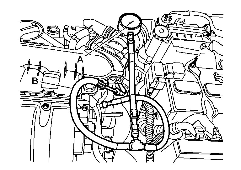

3.Remove fuel hose.
CAUTION:
Do not twist or kink fuel hose because it is plastic hose.

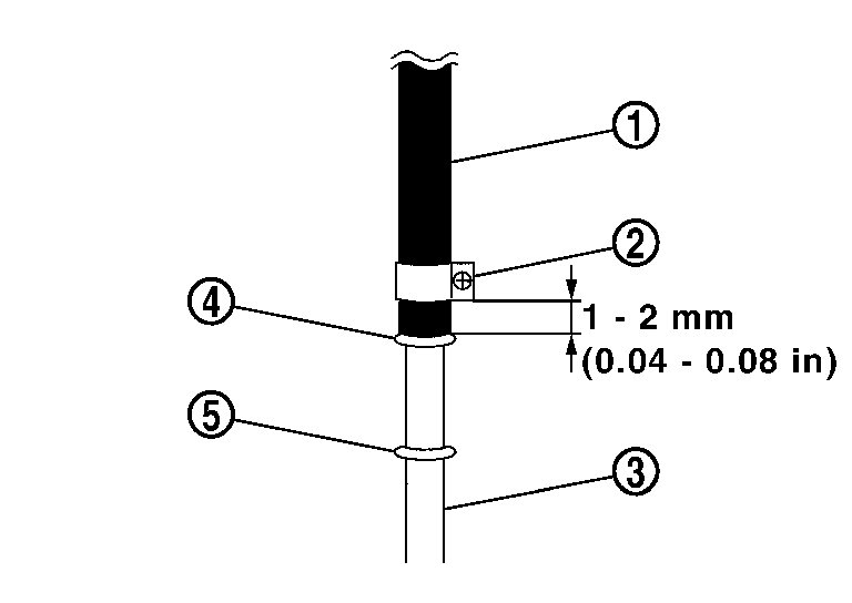

Picture 3
4.Connect fuel hose for fuel pressure check to fuel tube with clamp as shown in the figure.
Picture 4
CAUTION:
- Wipe off oil or dirt from hose insertion part using cloth moistened with gasoline.
- Apply proper amount of gasoline between top of the fuel tube and No. 1 spool .
- Insert fuel hose for fuel pressure check until it touches the No. 1 spool on fuel tube.
- Use NISSAN genuine hose clamp (part number: 16439
N4710 or 16439 40U00).
- When reconnecting fuel line, always use new clamps.
- Use a torque driver to tighten clamps.
Tightening 1 - 1.5 Nm (0.1 - 0.15 kg-m, 9 - 13 in-lb)
torque:
- Install hose clamp to the position within 1 - 2 mm (0.04 - 0.08 in).
- Make sure that clamp screw does not contact adjacent parts.

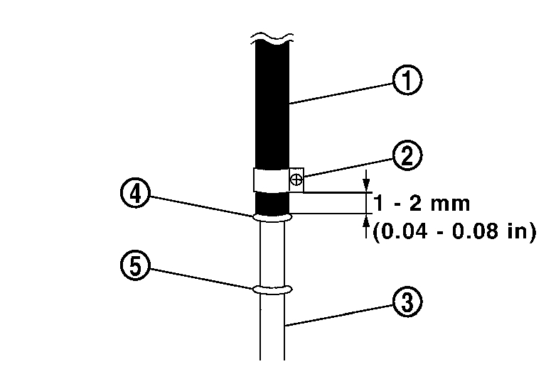

Picture 5

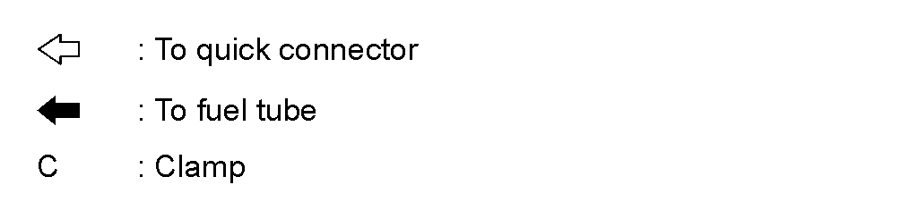

5.Connect fuel tube adapter to quick connector.
Picture 6
After connecting fuel hose for fuel pressure check, pull the hose with a force of approximately 98 N (10 kg, 22 lb) to confirm high pressure fuel pump does not come off.
