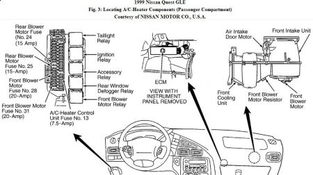

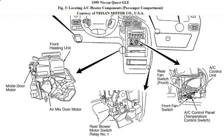

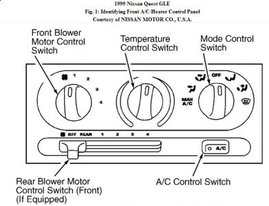

Seems there is a fault with the air mode door. I have the diagnostics for the manual HAVC system and hope it is the correct one.
Confirm Mode Door Operation
1. Turn ignition on. Turn front fan speed control switch to position "4".
https://www.2carpros.com/forum/automotive_pictures/192750_AirMode99QuestFig01_1.jpg
Turn mode control switch to each mode position and check for proper air distribution.
https://www.2carpros.com/forum/automotive_pictures/192750_AirMode99Quest_1.jpg
https://www.2carpros.com/forum/automotive_pictures/192750_AirMode99QuestFig03a_1.jpg
https://www.2carpros.com/forum/automotive_pictures/192750_AirMode99QuestFig03b_1.jpg
Tuesday, July 7th, 2009 AT 1:53 PM

Hi, Very good, Thank you very much, It worked now. I replaced both Mode control switch and Mode door motor, They moved smooth as they are all the air blowed on top now.
