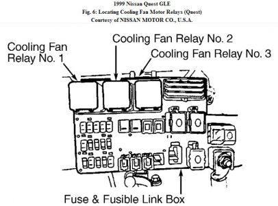

I have Nissan Quest mini van 1999, 100:000 miles .
I have problem with Radiator fan did not turn on low speed when engine warm . The fan turn on only on high speed , or A/c or heat on .
1) I tested the Fan by Jumped the hot wire directed from battery to the fan , It worked .
2) I tested all three relay . apply power to each invidual , all three clicked
03) I checked power of three terminal , all they have power , when inigtion key was on position .
The problem is there is 7.5 am RAD not power at all . Engine off , or run , the fuse checked ok . there is no power , even engine ran ,
The raw of Fan relay A is low speed , B is high 1 , C is high 2,
4) I switched relay by one at the time , both B and C high speed worked .
The problem is A relay position not work at all . runing engine to hot . But relay did not click to close curcuit , so the low speed can turn .
I moved same relay to the other place B and C high speed fan , it worked high speed fan .
The theomastart worked Ok , Coolant sensor worked , It send signal to turn high speed fan on .
Please , Tell me How do you think ? Thank yoiu

Hi vicauto2,
Thank you for the donation.
Your problem seems to be Fuse J ( 7.5 or 10 A ) no power supply. It should be hot at all times. Power to it comes from the 140 A fusible link. It could be a fault in the fuse box internal connections.
Try attaching a remote wire to the the fuse and apply battery voltage to test if the slow speed works.
Check the # 44 Fuse. It also works the fans.

7.5 A fuse is beside of relay A as low speed fan relay. It was same box of 3 Fan relay in engine comparment

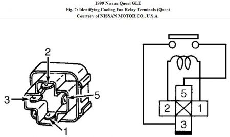

After some research I managed to get the testing procedures for the cooling fan circuits. COOLING FAN CONTROL TEST (QUEST) 1. Check Low Speed Fan Operation Ensure coolant level is okay. Turn ignition off. Disconnect cooling fan relays No. 2 and 3. See Fig. 6 . Start engine. Set A/C temperature control lever to full cold position. Turn A/C switch and blower fan switch on. Run engine at idle for several minutes. Cooling fan should operate at low speed. If cooling fan does not operate, go to next step.
https://images.2carpros.com/forum/automotive_pictures/192750_CoolingFanRelays99Quest06_1.jpg
2. Check Power Supply (Low Speed) Turn ignition off. Disconnect cooling fan relay No. 1. Turn ignition on. Measure voltage between cooling fan relay No. 1 harness connector terminals No. 1 (Blue wire) and ground, and terminal No. 5 (White/Blue wire) and ground. See Fig. 7 . If battery voltage is present, go to next step. If battery voltage is not present, check fuse No. 29 (10-amp) and fusible link (75- amp). If fuse and fusible link are okay, check open in circuit between fuse block and relay.
https://images.2carpros.com/forum/automotive_pictures/192750_CoolingFanRelays99Quest07_1.jpg
3. Check Ground Circuit (Low Speed) Turn ignition off. Disconnect cooling fan motor harness connector. Using ohmmeter, check for continuity between fan motor harness connector terminal No. 2 and fan relay No. 1 harness connector terminal No. 3 (Blue/White wire). If continuity does not exist, repair open in Blue/White wire. If continuity exists, check for continuity between fan motor harness connector terminal No. 3 (Black wire) and ground. If continuity exists, go to next step. If continuity does not exist, repair open or short in Black wire. 4. Check Output Signal Circuit (Low Speed) Disconnect ECM harness connector. Check for continuity between ECM harness connector terminal No. 38 and fan relay No. 1 connector terminal No. 2 (Blue/Orange wire). If continuity does not exist, check repair open in Blue/Orange wire. If continuity exists, go to next step. 5. Checking Cooling Fan Relay (Low Speed) Remove cooling fan relay No. 1. Apply 12 volts and ground to relay terminals No. 1 and 2. See Fig. 7 . Check for continuity between relay terminals No. 3 and 5. If continuity does not exist, replace relay. If continuity exists, go to next step. 6. Test Cooling Fan Motor (Low & High Speed) Disconnect cooling fan motor harness connectors. Connect positive battery voltage to fan motor terminal No. 2 and ground to fan motor terminal No. 3. Fan motor should operate at low speed. Connect battery positive to fan motor terminal No. 1 and negative lead to fan motor terminal No. 3. Fan motor should operate at high speed. If fan motor does not operate as described, replace fan motor. If fan motor is okay, check ECM pin terminals and/or wiring harness connectors for corrosion and damage. Repair or replace as necessary. Do the above test and see what you come up with. You mentioned the fuse was ok but did not have power to it. It should not have shorted. For testing of circuits, it is best to test with intermittent touching the contacts to confirm if it is horting first and the point of contact should be at the power source and not the component side.

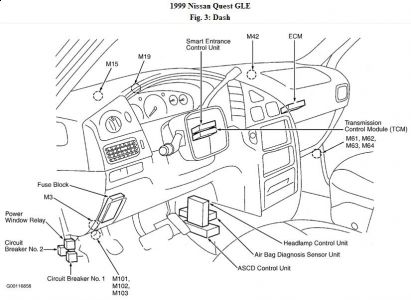

There are diagnostic equipment that can be plugged in test the various circuits but these are rather expensive items. The ECM is located behind right side of dash. Removal of the ECM would facilitate testing and AC components need not be removed.

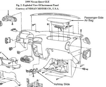

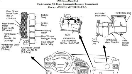

https://images.2carpros.com/forum/automotive_pictures/192750_DashComp99Quest_1.jpg

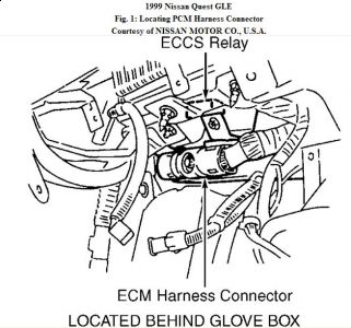

Removing the glove box should allow you to access the ECM. I do not have much info on the ECM removal except the view of the instrument panel.
https://images.2carpros.com/forum/automotive_pictures/192750_GloveBox99Quest_2.jpg
May 31, 2009 at 4:43 AM

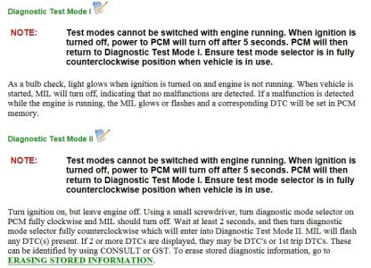

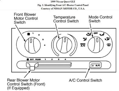

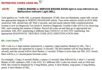

Lets try to see if you can get a manual reading of the MIL.
https://images.2carpros.com/forum/automotive_pictures/192750_MILCheck99Quest01a_1.jpg
https://images.2carpros.com/forum/automotive_pictures/192750_MILCheck99Quest01b_1.jpg
https://images.2carpros.com/forum/automotive_pictures/192750_MILCheck99Quest01c_1.jpg
Jun 11, 2009 at 3:28 AM
VICAUTO2
  • 41 POSTS
Hi , The service engine light is not on, and Nissan quest 1999 did not have a retrieve MIL box under driver seat as early nissan maxima or so , could not retrieve MIL

MIL reading data is for Quest and you need to check the ECM for the slots required to activate it.
Test the OBD-II terminal # 16 for battery voltage at all times. Nissan should be compatible with generic OBD-II scanners.
There is a possibility a power supply or ground is missing causing the problem.
Did you recheck all the fuses, especially those in Power Distribution Centre under hood?

hi , Thank you for quick responding , I have completed to remove ECM from the van , I have to remove A/C evapertor and blower in order to pull ECM out .
Please , Tell me some more How to test ECM on pin 38 . Do you have diagram ECM ? How do I know which pin is 38 ? Also tell me instruction how to test ECM ? the way I see test it in the van is extremly tight room . the better way is test out side vihecle , otherwise burn up again,destroy all work and the van is going salvage yard
It's size is about PC hard drive

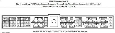

Here is the PCM identification.
https://images.2carpros.com/forum/automotive_pictures/192750_PCMConnector99Quest_1.jpg
There are no recommended PCM testing except by substituting. Sensors and circuits can be tested but not the PCM.

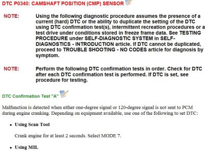

Hi , I cleand up some and put ECM back it's place and hooked all connection , then plug scan OBD II scaned ECM , Scan read code P0340 as Camshaft position sensor A bank 1 Malfunction .
Engine still did not start , there was not ignition in spark plus ,
I removed distributor cap and checked voltage in camshaft sensor , there are voltage present in three connector to the sensor ,when key is on position ,
I could not find ignition relay on quest , Do you know camshaft sensor held on tranaxle bellhousing .
I wonder why it've got this problem ,Is it because removing EMC ?
Any helps will be great . thank you
Jun 13, 2009 at 1:29 PM

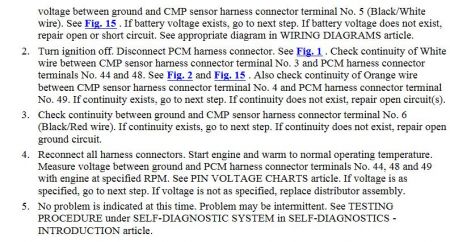

Removing the ECM should not cause any problem with the sensors. I would suspect a loose connection somewhere.

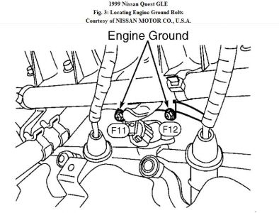

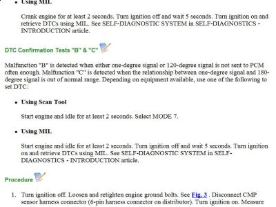

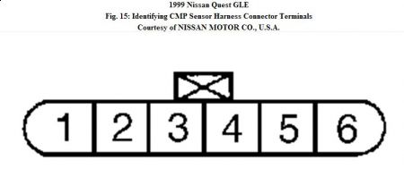

https://images.2carpros.com/forum/automotive_pictures/192750_P0340Quest99a01_1.jpg
https://images.2carpros.com/forum/automotive_pictures/192750_P0340Quest99a02_1.jpg
https://images.2carpros.com/forum/automotive_pictures/192750_P0340Quest99a03_1.jpg
https://images.2carpros.com/forum/automotive_pictures/192750_P0340Quest99aFig01_1.jpg
https://images.2carpros.com/forum/automotive_pictures/192750_P0340Quest99aFig03_1.jpg
https://images.2carpros.com/forum/automotive_pictures/192750_P0340Quest99aFig15_1.jpg
The sensor on the bell housing is known as crank sensor but for quest it is located at crank pulley side.

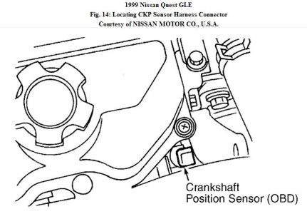

Hi , thank you quick responding , I removed ECM connection again and checked continuity the White No 3 on ditributor connector and ECM connector , There is only continuity on 48 pin on ECM , all the rest is none . I also checked continuity of orange wire , but got none . After that I put ECM Back it's place , Then test OBD II , It pass no and code , I also used MIL mode retrieve code , but it pass no code , no any sensor malfunction . But the engind is still not any ignition at all , I also checked distributor connector # 4 , that connected to distributor , There is battery voltge on that , I hooked up light test to positve battery and light probe to ground in the plug and crank engine , the is not any spark . that could mean crank sensor . How do you think ?
I used OBD II scaned ECM several time at difference hour , tried to deteted some thing in ECM , But no any code .
Bottom line is no spark was send to distributor , It could be crank sensor or ECM .
It is my home van , thus , I have to jack it up and craw underneat to find crank sensor , and test resistance. I don't know why ECM did not detect these thing , or it is bad .
Do you know what pin # on ECM connector to crank sensor I 'm goning to check the continuity from crank sensor and ECM connector .
Right now could not tell problem is distributor , because the no signal was send to the distributor connector . How do you think ? Any help wiill be great .
Jun 14, 2009 at 9:37 PM

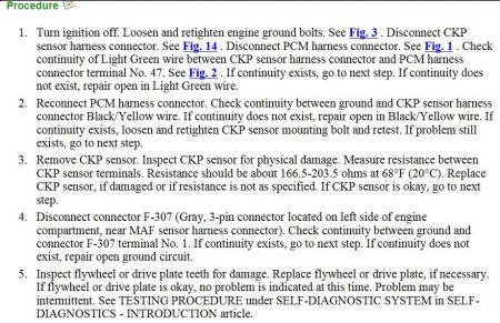

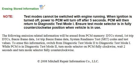

When ECM is disconnected, faults would be erased and it would require some cranking ( 15 seconds) for the crank or cam sensors to register. Some codes needs the ignition to be turned off and on again to crank for them to register as they are require 2 trips to set the code. Sorry I made a mistake when refering to the cranksensor location. It should be on the bell housing.
https://images.2carpros.com/forum/automotive_pictures/192750_P0335Crank99Quest01_1.jpg
https://images.2carpros.com/forum/automotive_pictures/192750_P0335Crank99QuestFig14_1.jpg

I scaned OBD II ECM gain , It still deteted Camshaft sensor position A bank 1 malfunction , I removed distributor and test .
1) I back probe square connector with 2 wire that connected to distributor , have power battery present ,
2) I back probe the 6 wire connector to 6 pins of distributor , when I backed probe each one with ginition key on and positive lead tachommetter to the back proble and negative to good ground and slowly turn distributor shaft to see any voltage zero to 5. valtage , the # 5 wire got 11.86 volt , that from battery volt , and the other 5 wire , some got none , some .18 volt , none of them got close to 5 volt.
I decided and order new distributor from California $ 164:00, I'll recive it some time nex week.
Please, Can you tell me instruction How to test distributor ? to tell If the camshaft position sensor bad or not , Once again Thank you 2carpro support teams .
Jun 17, 2009 at 12:32 PM
KHLOW2008
  • 41,812 POSTS
Our aim is to help the world repair cars:)
For camsensor testing, refer to previous reply in page 2 of this post. DTC P0340.
It explains how to test the CMP

Hi !
I'm back , after 2 weeks waitting parts , I had to replace new distributor ,and used ECM ,too .
distributor only is not working , ECM is malfunction , I have to replace both . Engine started right up after installation completed , and running fine , I'm lucky , I worked on my own van , so this happen to my van is ok for me , I understand electronic could happen bad any time , But If I work for some oneelse in auto shop and this happen , I'm in deep trouble .....
Back to primary issue The low speed fan not work .
I checked the fan motor as your intruction , It turned on low speed and high speed fan by jumped directly to battery lead to fan connector pin 1 and 2 ground pin 3 .
Some thing open between fan relay 1 to fan connector , I will work over again and will let you know later . Thank you 2 carpro team work supprort

Cheers, finally we have some positive results.
Yes, that is the risk we have to face, sometimes we do not know how to explain to customers when electronic components of their vehicles fails in our shop.
Wires seldom goes bad unless they have been subjected to impact or stress damages. Check harness connectors, especially under the fuse box. If there had been any impact damage repairs, those are the areas to look for.

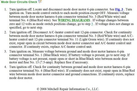

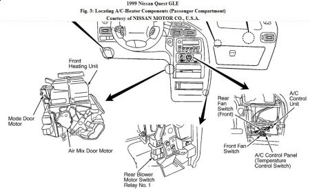

Hi , I'm sorry to tell you , I have anather problem during A/C installation . The Air blower motor turned on and blow the air , But Air blowed to two vent down on the floor only, whatever switch turned the air to top dash did not work , I removed any thing in the front and both side of central vent blow . I saw two small motor with some linket on them at bottom of heater housing.
I need some one helps , the electronic air nob selector select position of the blow and motor switch the vent direct the air blow , some thing is about like this .
Any helps will be great of my apreciations
Jul 6, 2009 at 12:50 PM
KHLOW2008
  • 41,812 POSTS
Seems there is a fault with the air mode door. I have the diagnostics for the manual HAVC system and hope it is the correct one. Confirm Mode Door Operation 1. Turn ignition on. Turn front fan speed control switch to position "4".
https://images.2carpros.com/forum/automotive_pictures/192750_AirMode99QuestFig01_1.jpg
Turn mode control switch to each mode position and check for proper air distribution.
https://images.2carpros.com/forum/automotive_pictures/192750_AirMode99Quest_1.jpg
https://images.2carpros.com/forum/automotive_pictures/192750_AirMode99QuestFig03a_1.jpg
https://images.2carpros.com/forum/automotive_pictures/192750_AirMode99QuestFig03b_1.jpg
Jul 7, 2009 at 6:53 AM
VICAUTO2
  • 41 POSTS
Hi, Very good , Thank you very much, It worked now. I replaced both Mode control switch and Mode door motor , They moved smooth as they are all the air blowed on top now.
Once again Thank you very much 2carpro support team , without your helps my van is going Junk yard at 112,000 miles ...
