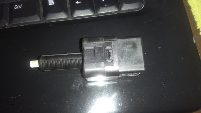

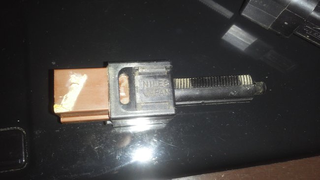

MIKE H R
  • 3,094 POSTS

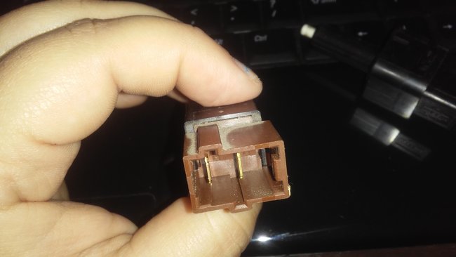

There is a switch on the brake pedal arm that controls that locking mechanism.
Apr 1, 2018 at 12:35 AM
CIARA VANLANDINGHAM
  • 25 POSTS

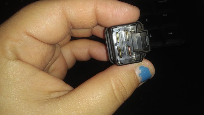

This is what I found.
Apr 1, 2018 at 4:19 AM
  • 55,746 POSTS

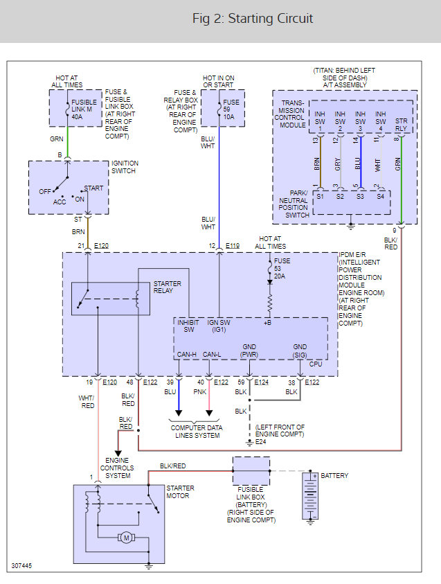

The transmission range sensor is located at the transmission. Here is a wiring diagram and a guide so you can test to see where you are losing power. The range sensor is on the transmission where the link cable connects.
There is a starter relay I would check as well.
Here is the starter relay location (below).
Please run down these guides and report back

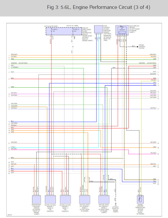

  • 55,746 POSTS

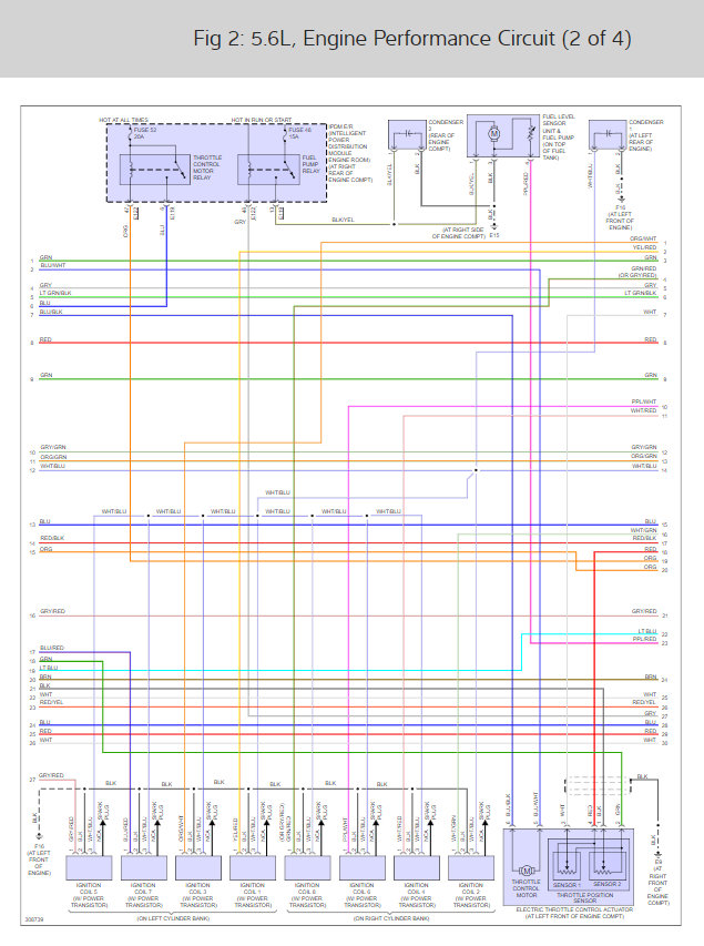

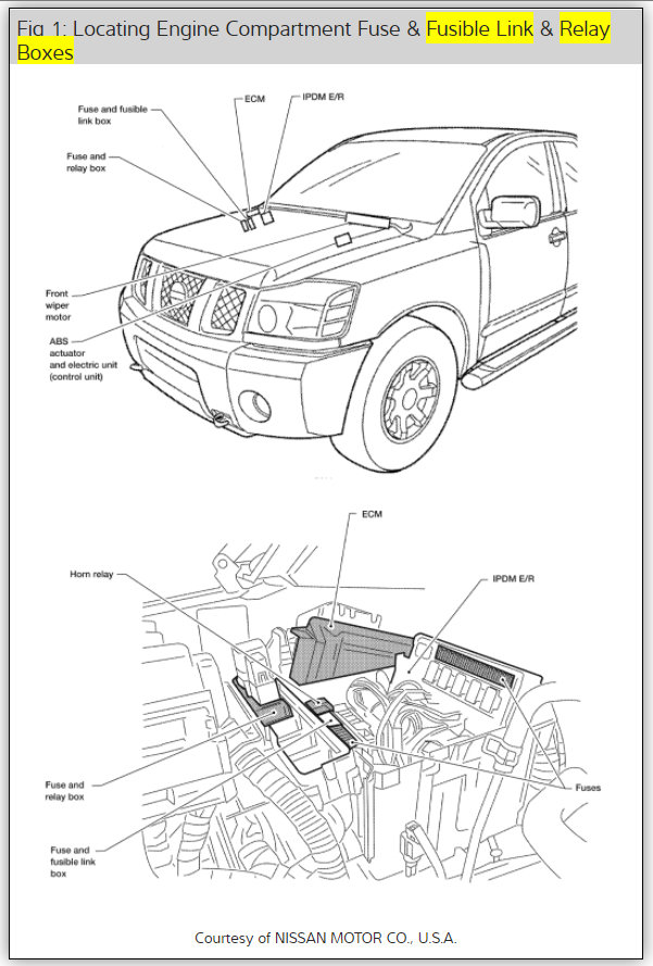

Good then it sounds like you have a fuel pump relay or you lost power to the relay. Here are the engine and fuel pump wiring diagrams so we can test for power. The fuel pump relay is located in the IPDM under the hood.
Apr 16, 2018 at 2:42 AM

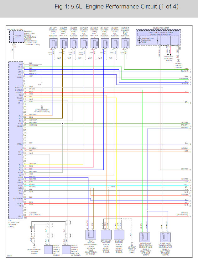

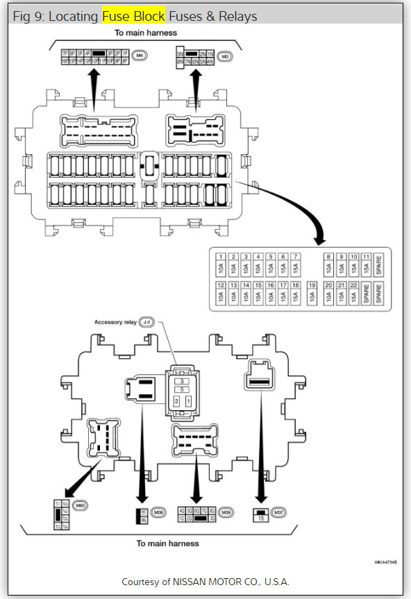

  • 55,746 POSTS

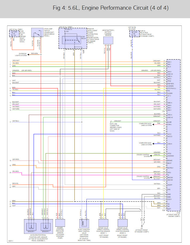

Okay, we are getting closer. When you run the codes did any come up? Also, lets check the fuses #12 and #19 to see if they have power with the key on?
Here is a wiring diagram to help you see how the ALDL is wired
Check out the diagrams (below). Please run this test and get back to us.

  • 55,746 POSTS
Did you check the fuses #12 and #19 with the key on to see if they have power?
May 17, 2018 at 3:14 AM
CIARA VANLANDINGHAM
  • 25 POSTS
I am trying to find them.

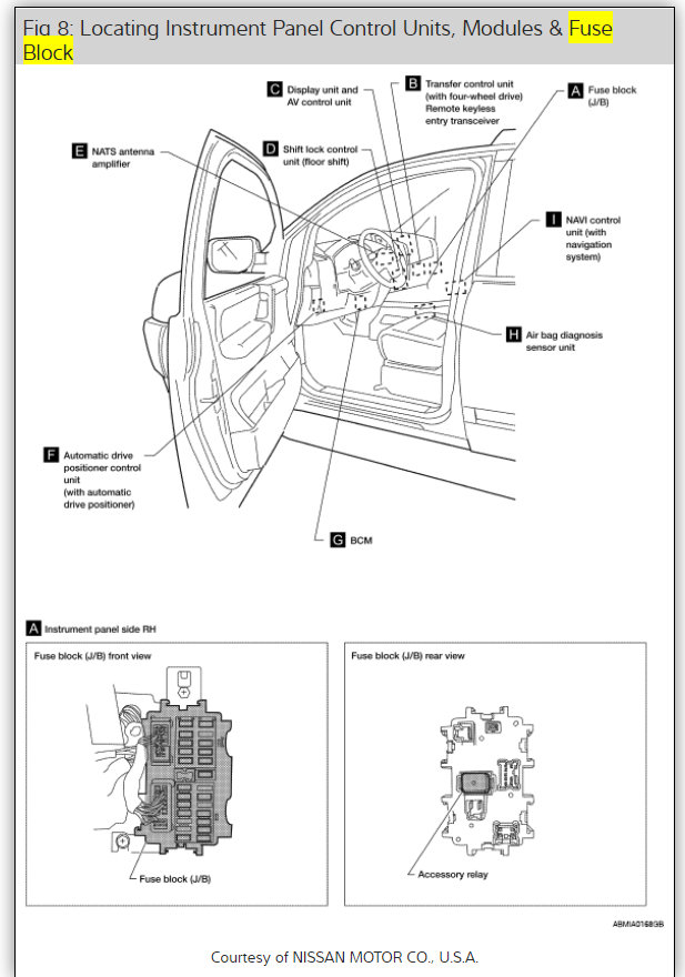

May 17, 2018 at 3:15 AM
  • 55,746 POSTS
There are in the under dash fuse panel check out the fuse location and ID in the post on the previous page.
May 17, 2018 at 3:22 AM

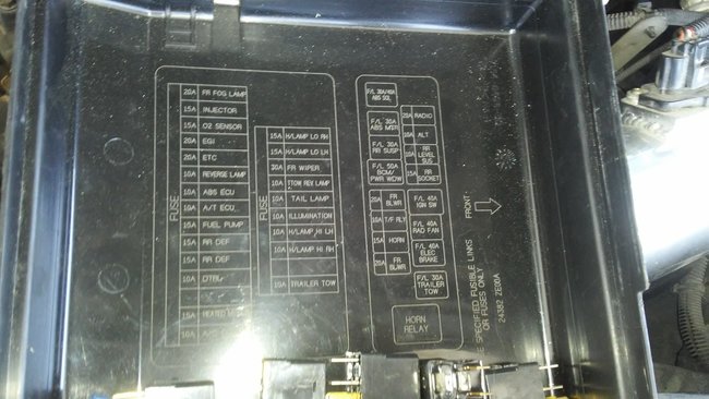

CIARA VANLANDINGHAM
  • 25 POSTS

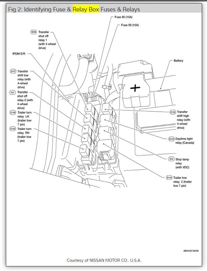

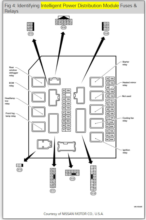

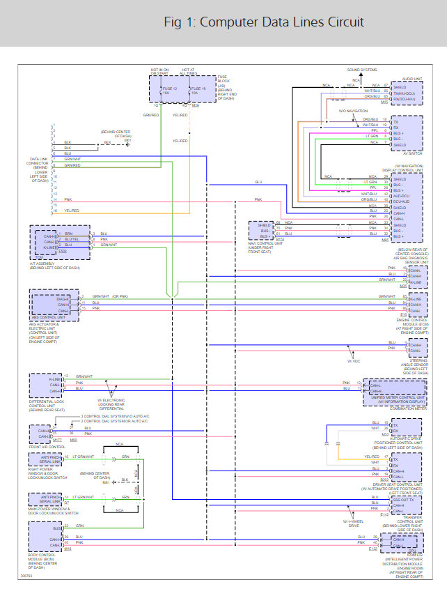

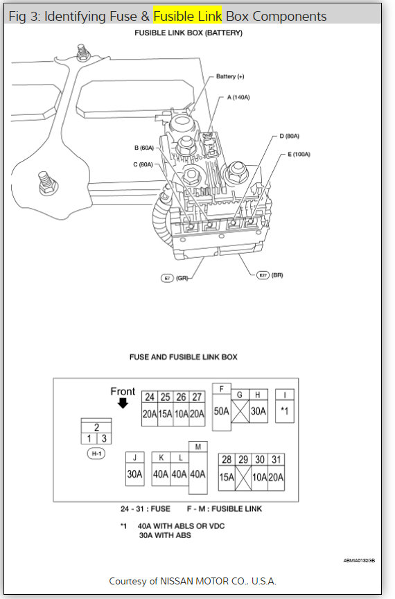

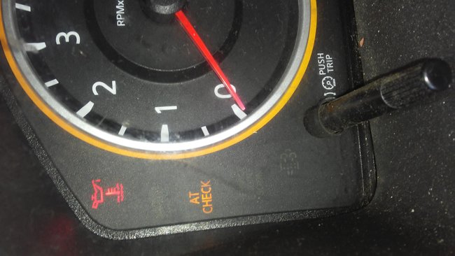

Okay, I checked those two fuses and they were fine, I am sending you a diagram of what my fuse panel looks like and also I never noticed this before but when I went to start the truck after this sign flashed saying at engine and then it went away.
May 17, 2018 at 3:53 AM
CIARA VANLANDINGHAM
  • 25 POSTS
These are the images.
May 17, 2018 at 4:00 AM
  • 55,746 POSTS

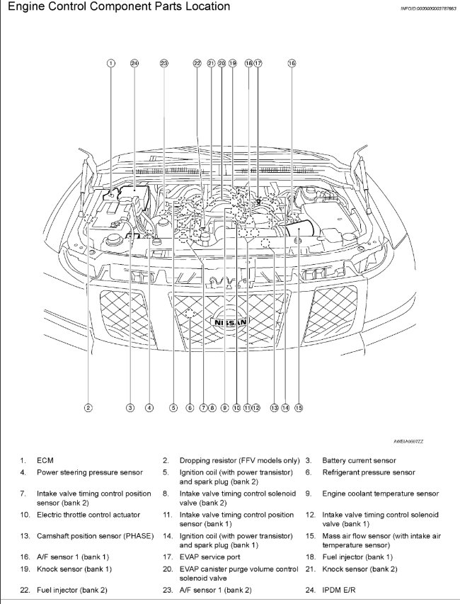

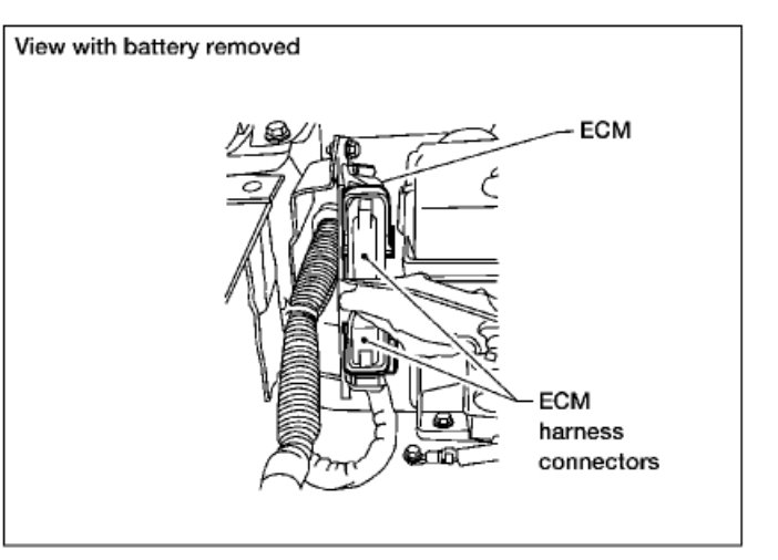

Was this truck in a flood by chance? It sounds like the PCM is bad. I would do a pin to pin check on the wiring and then try a new PCM a shop may need to program it for you. I would try a used one to see what happens you can get one from a wrecking yard.
May 18, 2018 at 2:29 AM
CIARA VANLANDINGHAM
  • 25 POSTS
Never flooded. What PCM?
May 18, 2018 at 2:41 AM
  • 55,746 POSTS
The PCM (ECM same thing ) is the engine computer. Here is the location.
May 18, 2018 at 2:55 AM
