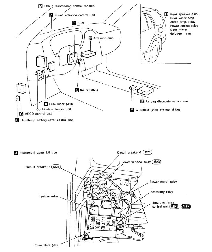

I have consulted several online manuals and no one seems to agree on where the relay is located. I have no turn signals or hazard flashers. I have checked the related fuses and they are fine, so I am guessing it is the flasher.
Jul 8, 2007 at 3:52 PM
2CARPRO JACK
  • 11,533 POSTS

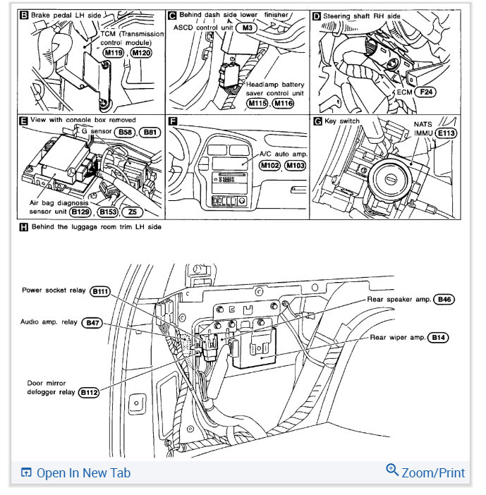

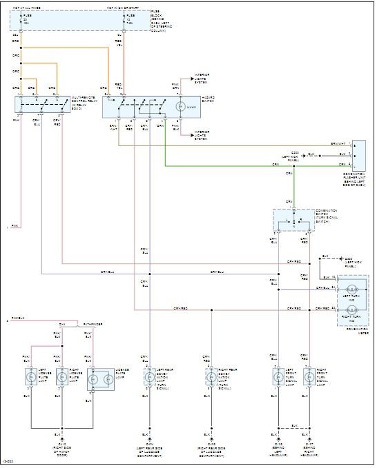

THe turn signal flasher is called a Combo flasher unit is behind left side of dash, behind fuse block. Wiring diagram for the turn signals is attached below
Read this article on turn signal issues, it will help
https://www.2carpros.com/articles/turn-signals-not-working-blinker
