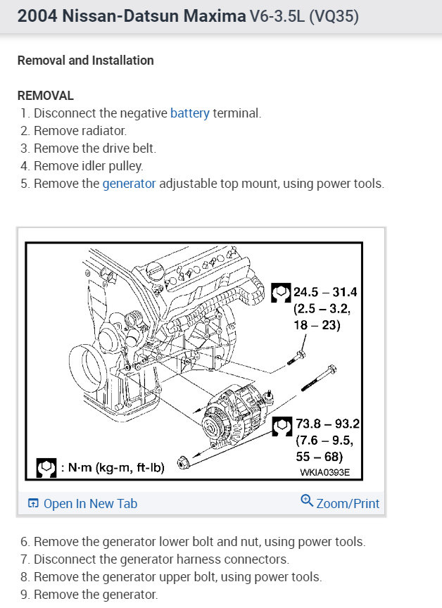

It still sounds like the alternator is bad which is common to work sometimes and then fail. here is a guided to help you walk through the repair with diagrams below to show you how on your car.
https://www.2carpros.com/articles/how-to-replace-an-alternator
