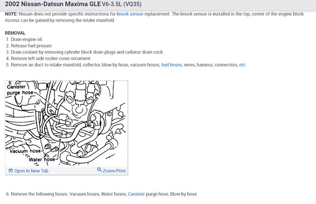

Hi Sir/Madam,
I have a 2002 Nissan Maxima SE(3.5L SFI DOHC 6cyl). The "Service Engine Soon" light is always on. The mechanic told me that it was caused by the broken knock sensor. The vehicle has 105K miles and I think is out of warranty. Where should I repair it (my zip code is 70112)? Could you please give me some suggestions? Approximately how much will it cost? Thank you very much!
czfy110
Jul 15, 2009 at 9:04 AM
BLUELIGHTNIN6
  • 16,542 POSTS

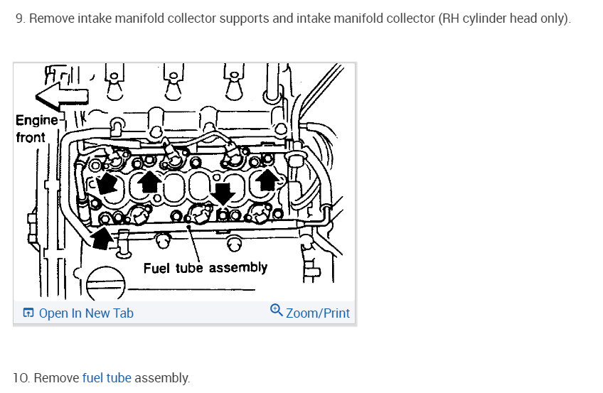

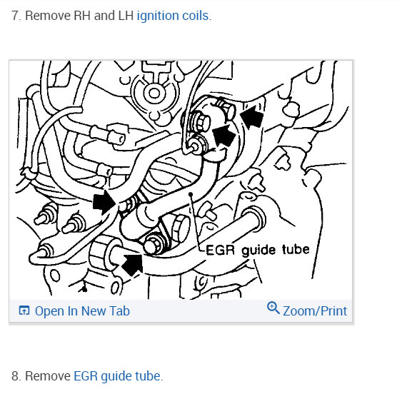

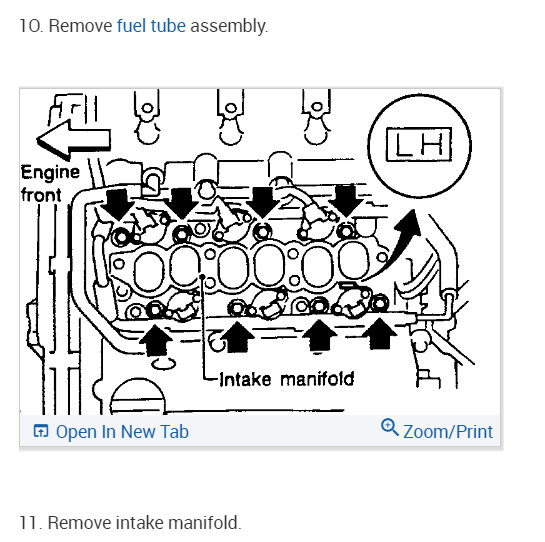

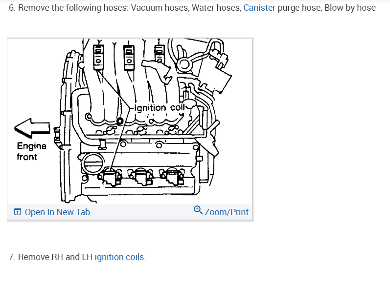

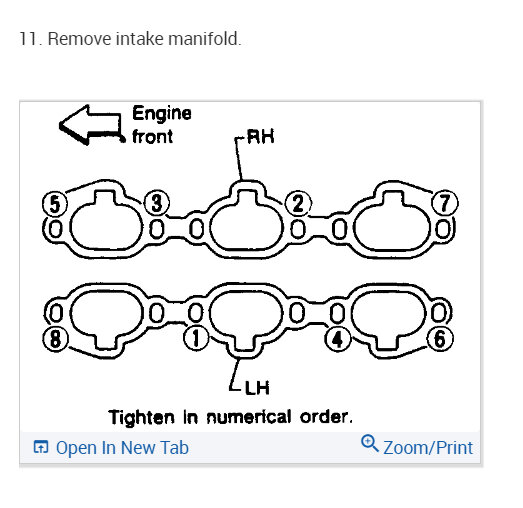

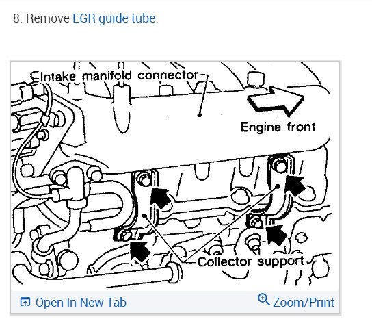

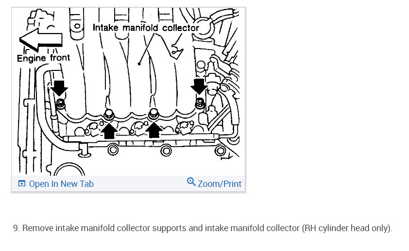

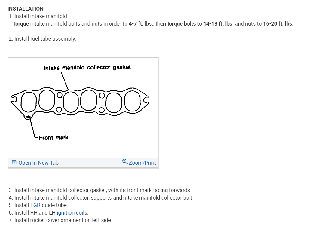

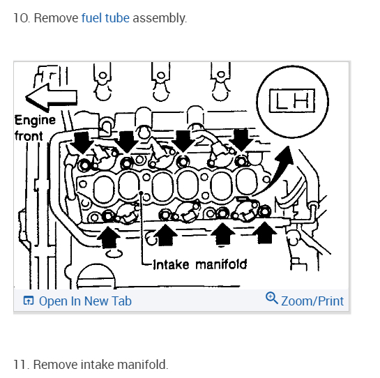

The knock sensor is installed in the top, center of the engine block. Access can be gained by removing the intake manifold.
Knock Sensor, R&R 3.5 HRS @ shop rate.
Knock Sensor #220602Y000 $293.18
Here is how the job is done. Check out the images (Below). Please let us know what happens.

The knock sensor is located under the intake manifold.

Yeah , a local shop can do it for you. Any local repair shop will use your own part you bring in. Just go to a local part store (AutoZone, Advance Auto Parts etc..) and order the knock sensor. Then take the sensor to a local reputable repair shop and ask them how much they charge to replace it. The sensor will be around $125 at part stores compared to the nearly $200 at the dealer.

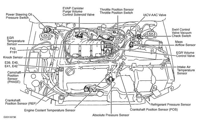

I have a code for a knock sensor circuit code. I think it was p0325 or something like that. I'm looking on google and youtube to try to find a video on how to replace this because I'm being told I can replace it without removing the intake manifold but every car I see online has an aluminum manifold and mine is plastic. I can not find the right video or pictures to show me with the right motor as mine. Can anyone please help me?
Aug 6, 2019 at 8:23 AM (Merged)
  • 110,240 POSTS
You shouldn't have to remove the intake. It is mounted on the top of the engine block. See attached pic.

I need to replace the knock sensor but I do not know where it is located in the engine. I have the part ready and I took the engine apart but I still can not find the location of the knock sensor. Please help!
Aug 6, 2019 at 8:24 AM (Merged)
  • 75,992 POSTS
Location of knock sensor-see below:
https://images.2carpros.com/forum/automotive_pictures/12900_k_5.gif
