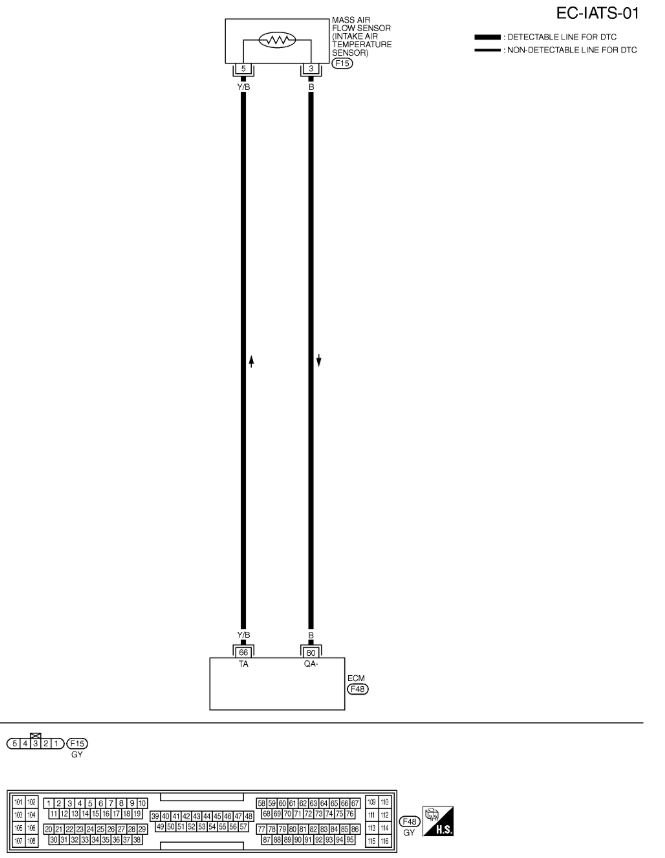

I am trying to figure out where my intake air temp. snsor is on my nissan. It is the 3.5 DOHC motor. I just like to clean them up once in a while and cannot find it. Usually i have no problem, but this one stumped me. Thanks for your help guys.
Dec 5, 2007 at 7:57 PM
BLACKOP555
  • 10,386 POSTS
It looks as though it is integrated into the Mass Airflow Sensor.
See the diagram below
