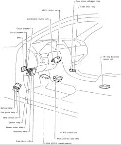

where is the blinker module located on a 1997 nissan maxima
Nov 2, 2008 at 6:52 AM
IMPALASS
  • 3,112 POSTS

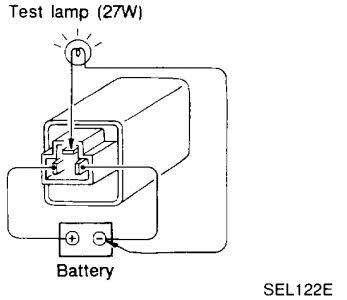

Hello If I understand you correctly, you want to know where the turn signal, emergency flasher relay is. I have attached the location and how you can check it.
https://images.2carpros.com/forum/automotive_pictures/248015_Flasher_1_1.jpg
https://images.2carpros.com/forum/automotive_pictures/248015_Flasher_2_1.jpg
Before checking, ensure that bulbs meet specifications. Connect a battery and test lamp to the combination flasher unit, as shown. combination flasher unit is properly functioning if it blinks when power is supplied to the circuit

thanks for you answer but I cant read the names on the diagram when I try to enlarge it is it a way to make it bigger
Nov 2, 2008 at 9:40 AM
IMPALASS
  • 3,112 POSTS
Hello –
Did you try to right click on the pic, the save it to your computer. Then open it in picture viewer and that has + an – on it to make it bigger and smaller. If that doesn’t work provide your email address and I will try sending it that way.
Nov 2, 2008 at 10:32 AM
WELCHWELCH
yes I did save on my computer and tried to zoom in but it is not readable, thank you
Nov 3, 2008 at 7:55 AM
IMPALASS
  • 3,112 POSTS
I sent a couple of different pics to you....Lord willing one will work.
