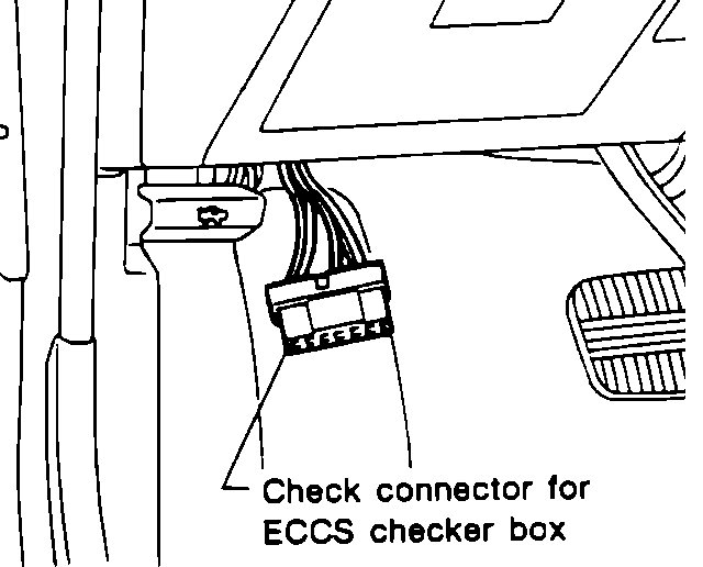

I can't locate OBD1 relay. Tried to find in all mentioned places cant find it.

As far as the data link connector, it's located just above the hood release handle. See picture 1.
Let me know if this helps.
