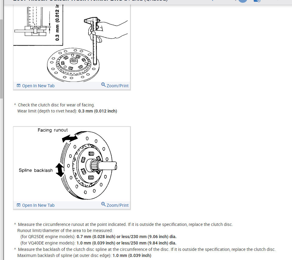

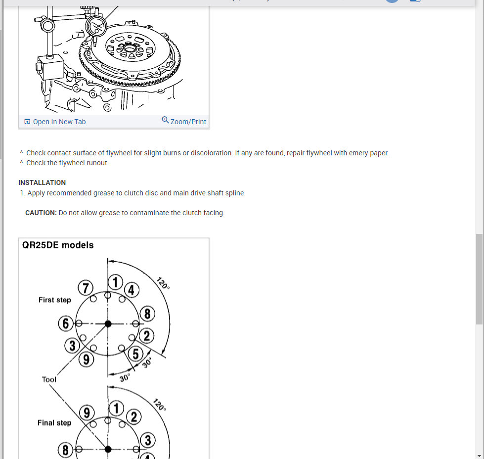

My clutch stopped working I commute with the truck and hall yard waste. What could make this happen?
Mar 24, 2008 at 6:57 PM

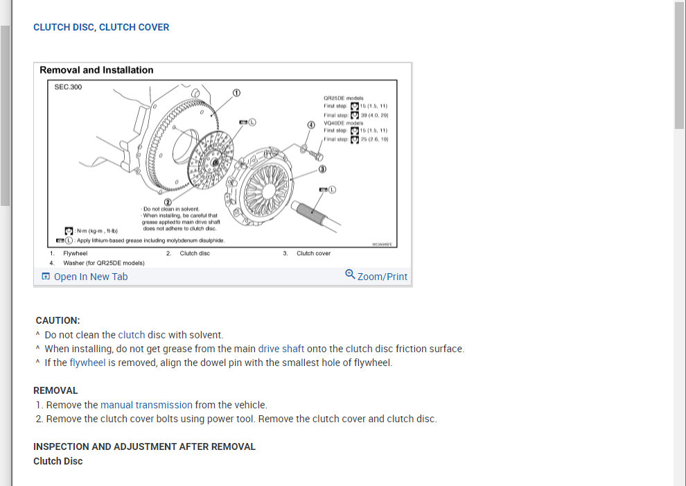

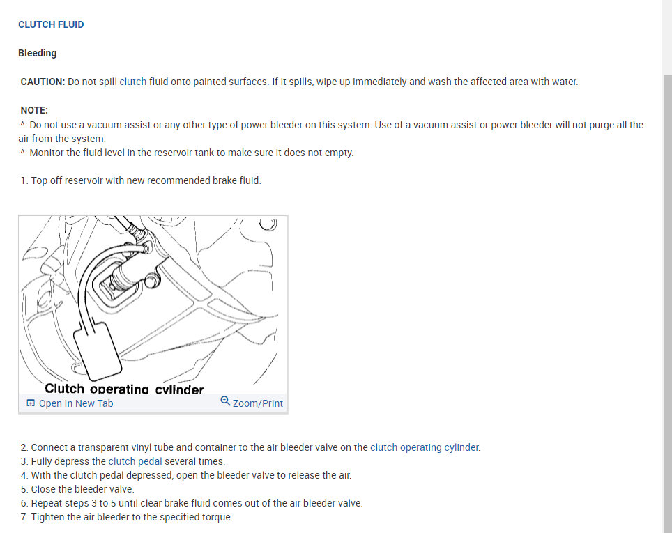

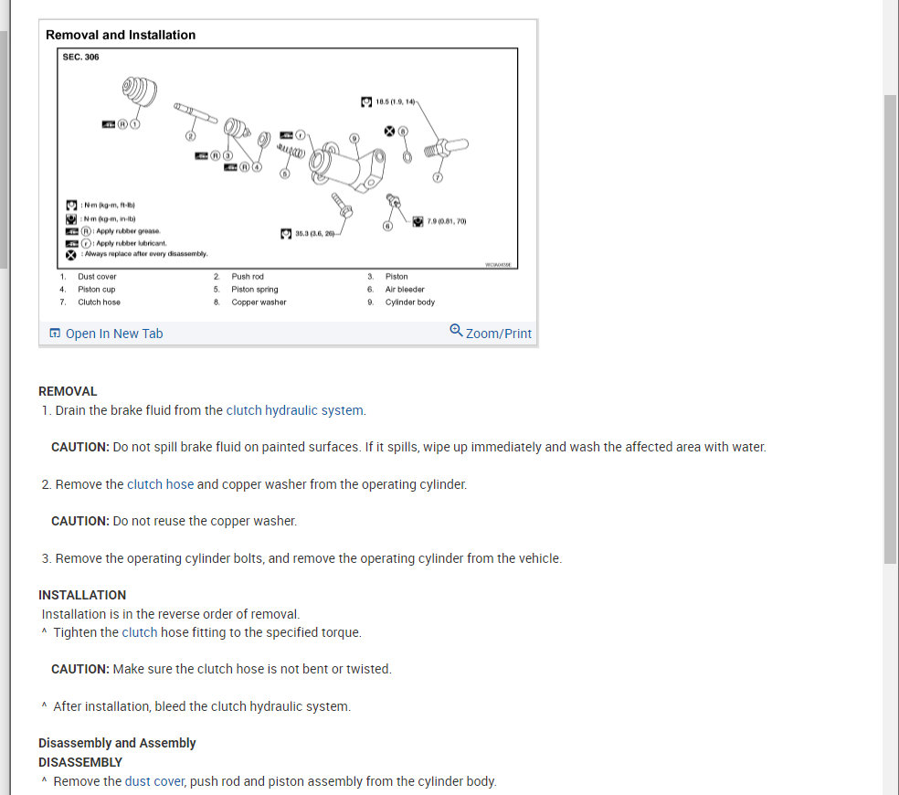

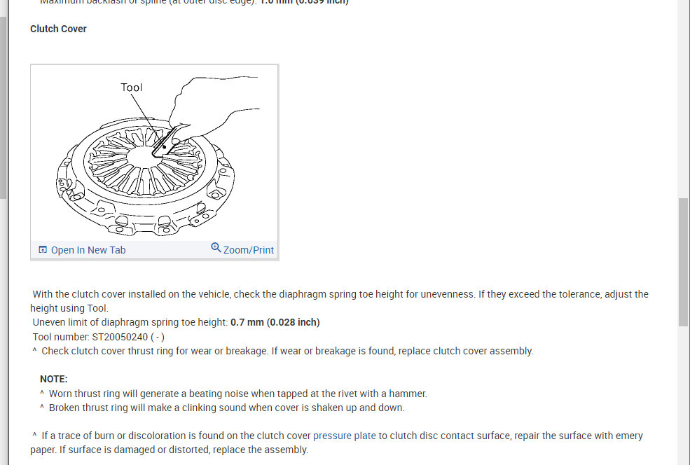

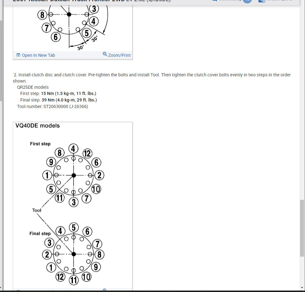

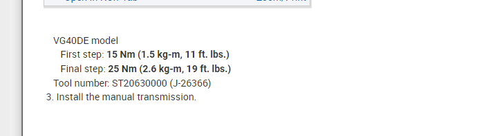

Normally this is just a leak in the hydraulic system so we need to run through this and replace the slave cylinder but if it were me, I would just go ahead and replace the entire system.
Here are guides that will help with this entire process:
https://www.2carpros.com/articles/clutch-doesnt-work-sometimes-or-not-at-all
https://www.2carpros.com/articles/pilot-bearing-replacement
https://www.2carpros.com/articles/throw-out-bearing-replacement
https://www.2carpros.com/articles/flywheel-remove-replace
Below you will find the process from the manual to do all this and bleed the clutch after you are finished.
Please let us know if you have other questions. Thanks
