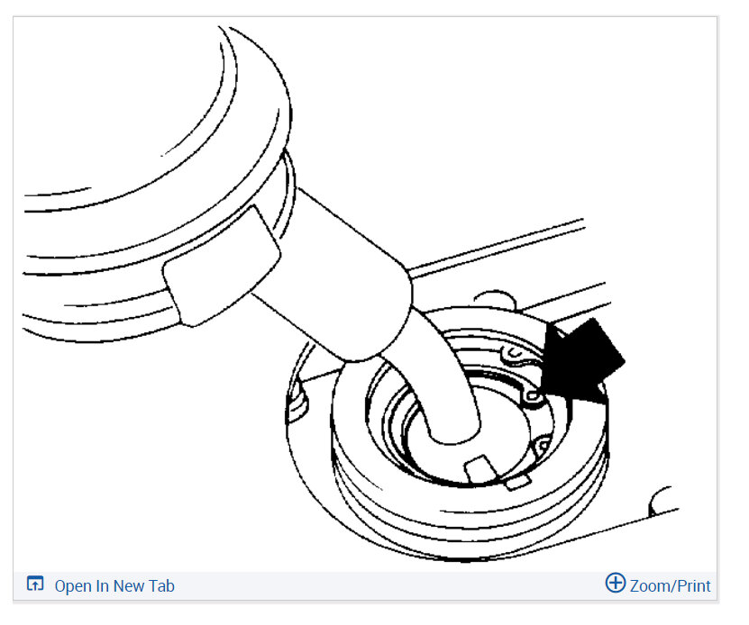

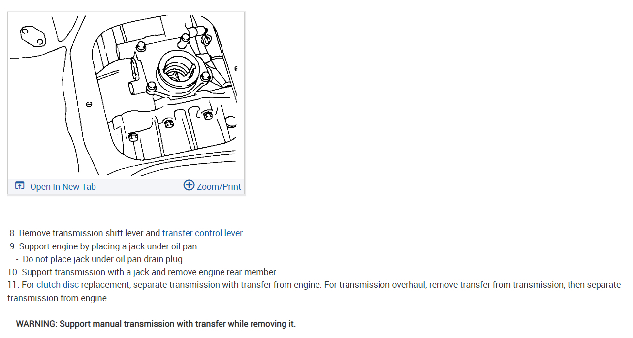

Opps! Nope the main shaft stops spinning when the clutch is pressed in, the problem is the throwout bearing, here is a video to help show you how you can tell for sure.
https://youtu.be/EpBMj5ZY_bo?si=OW6MvktZoLoz4OKZ

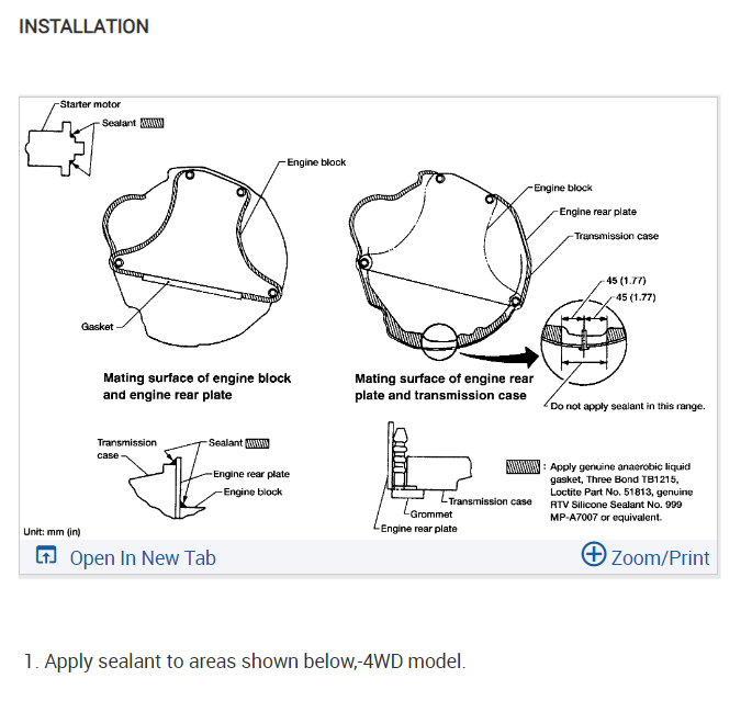

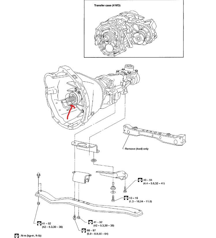

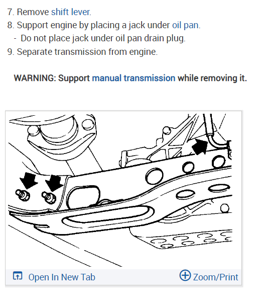

To change the throw out bearing you will need to remove the transmission so you might as well do a clutch at the same time FYI.

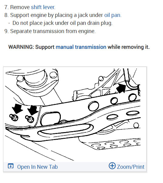

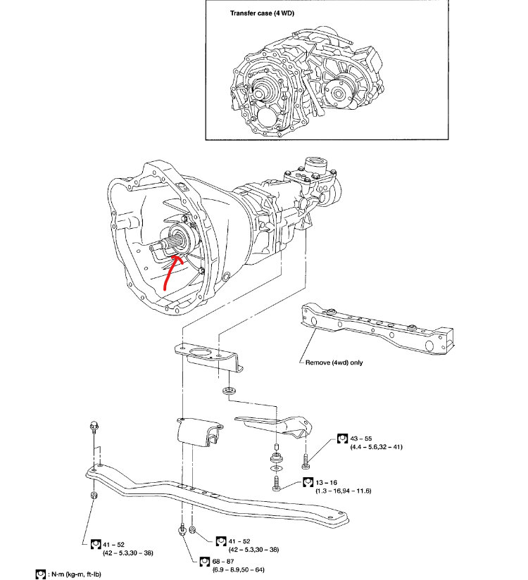

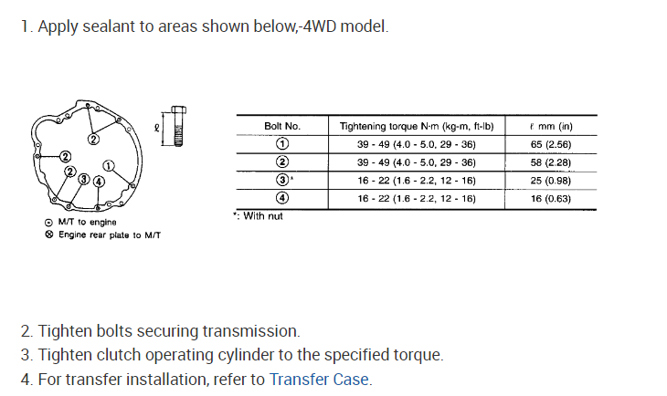

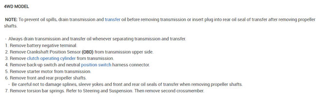

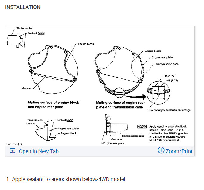

This guide can help you replace the clutch and I included how to remove the transmission in the images below.
https://www.2carpros.com/articles/how-to-replace-a-clutch
