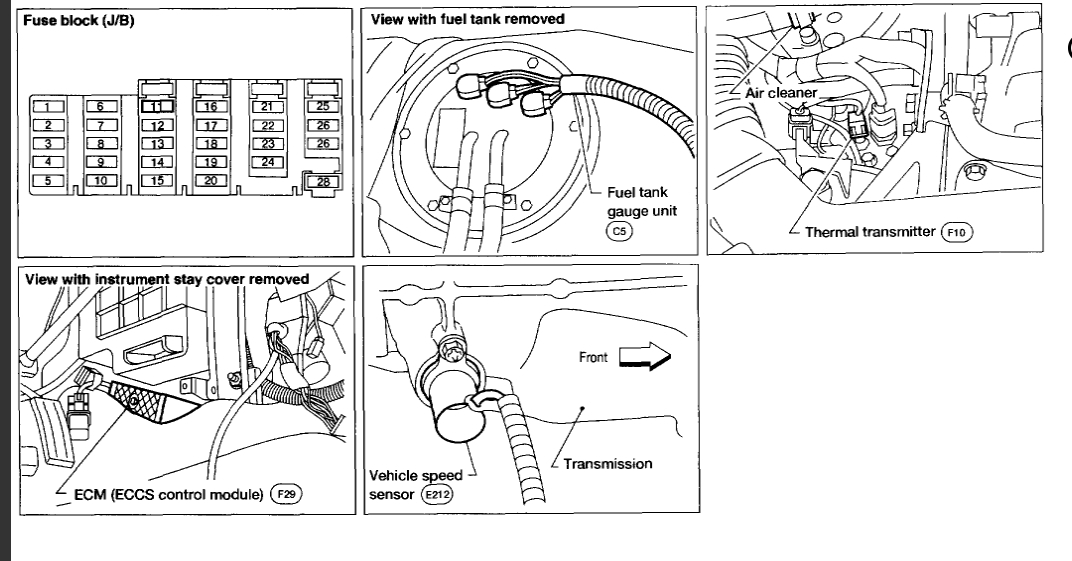

This sounds like a the VSS is going out. Here is the location.
May 9, 2018 at 1:45 PM
