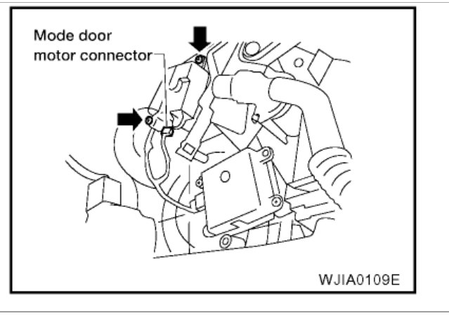

My heat works on and off. It'll blow hot air for awhile and then turn ice cold as if the air conditioning is on, what is the cause of this? The mechanic told me I need a new water pump but I don't see any coolant leaking or have any engine overheating issues.
Thursday, October 21st, 2010 AT 2:34 PM
KEN L
  • MASTER CERTIFIED MECHANIC
  • 48,356 POSTS

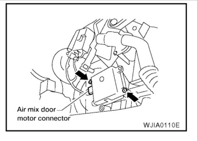

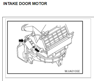

This sounds like you have a temperature blend door actuator that is out. Here is a guide that will give you an idea of what you are in for when changing the actuator out.
This guide can help as well.
Here is the locations of the temperature blend door actuator for your car. (below)
