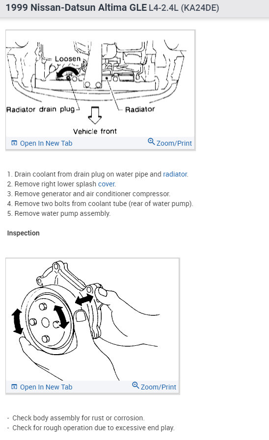

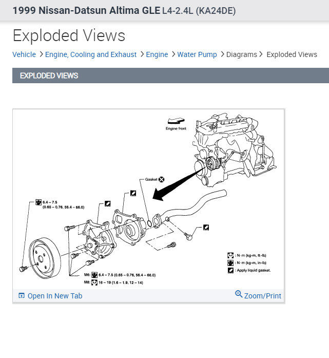

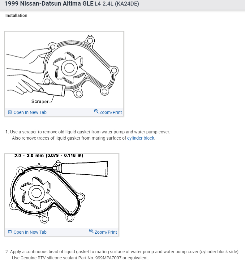

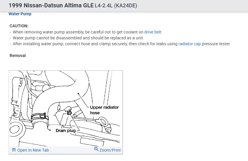

If the water pump is leaking, then it will be best to replace it. As any leak can become much bigger and cause other issues.
What you don't want is the leak to become excessive and the engine to lose too much coolant and overheat then damage the engine.
https://www.2carpros.com/articles/symptoms-of-a-bad-water-pump
https://www.2carpros.com/articles/water-pump-replacement
