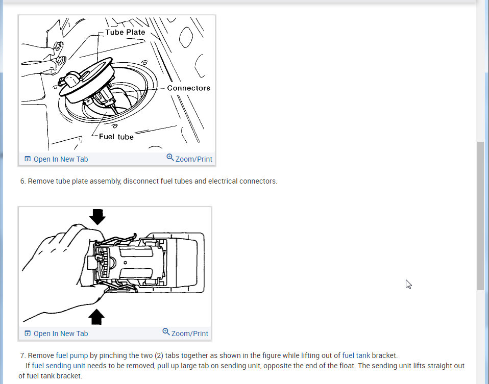

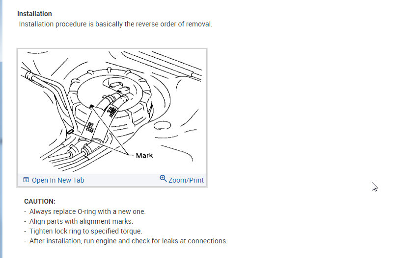

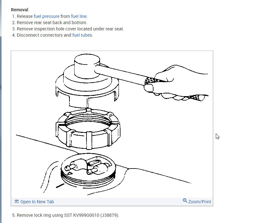

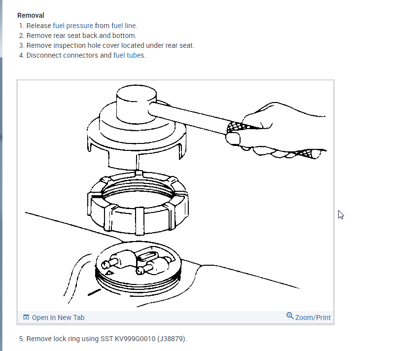

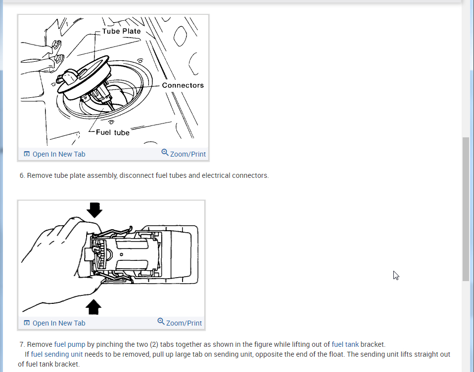

Where is the fuel pump located on the car listed above? What is the best way to access it so it can be replaced?
Sunday, July 6th, 2008 AT 8:29 PM
MECHANIC
18,907 POSTS
This is located in the fuel tank but in your vehicle you can access the pump from under the rear seat. I attached the process from the manual on how to replace it. It is pretty straight forward.
