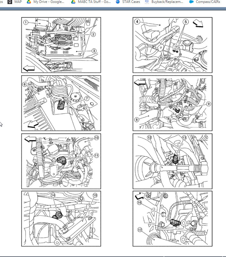

I am attaching the information on how to replace this and its location.
Also, here are some guides that will give more information:
Let us know what questions you have and we can go from there. Thanks

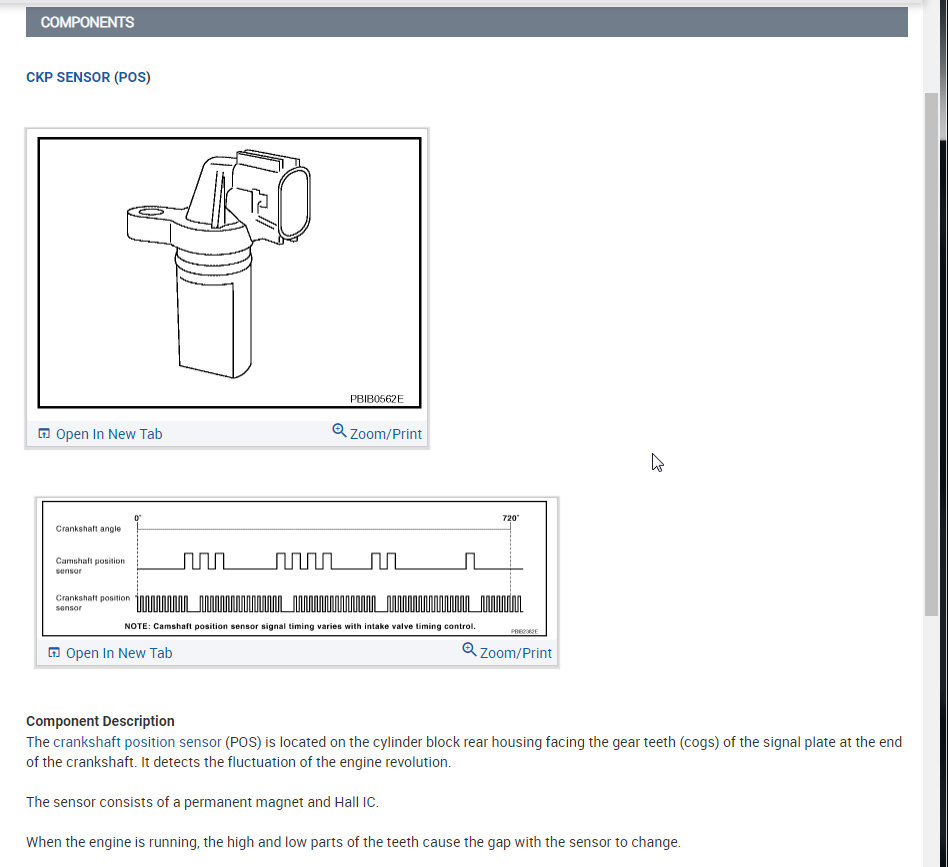

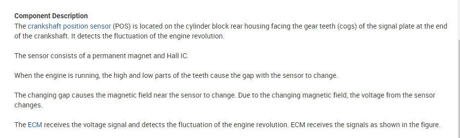

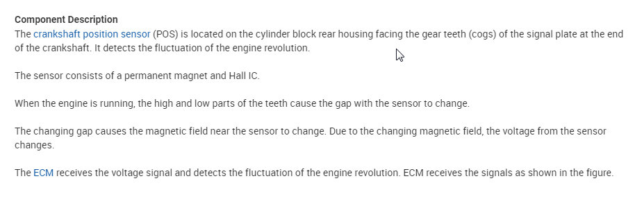

If this was not doing this prior to replacing the crank sensor then I suspect you either have an issue with this sensor or the air gap is not correct. I attached the way these sensors work. As you can see there is a magnet in the end of the sensor and it picks up the high spots of the tone wheel and that changes the voltage that the sensor is sending to the ECM and this is how it knows the position. With a weak signal the ECM may not start the engine until it figures out the position. If you still have the original sensor, pull this sensor back out and compare them if you have not done that. Just make sure the depth of the sensors are exact.
If they are the same, I would exchange for another one from the store. They should return it with no issues.
Aftermarket sensors are not that great so if you get another one, you may want to get your money back and then buy a sensor from Nissan. They are probably a little more expensive but are better quality.

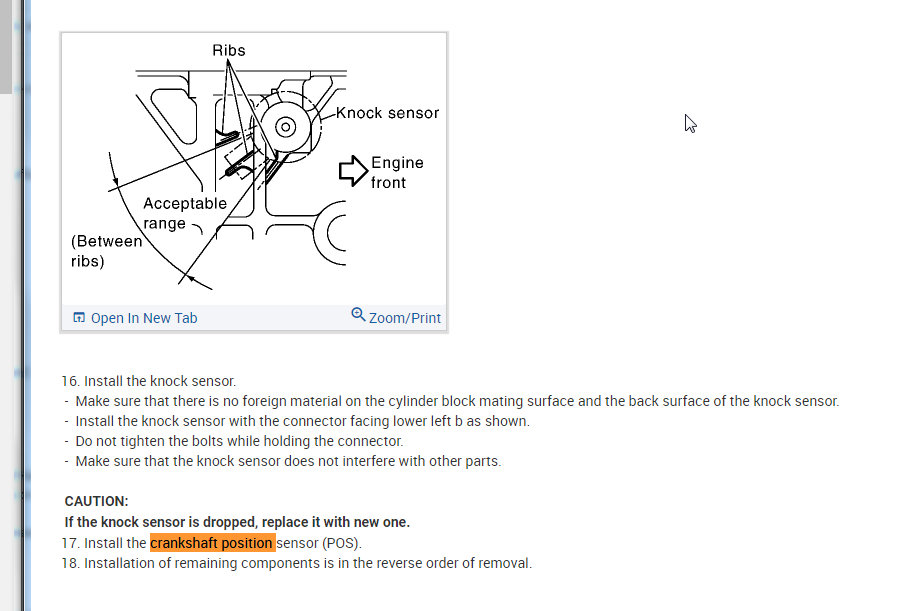

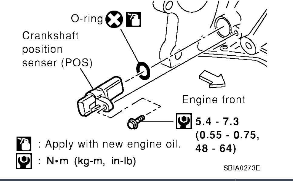

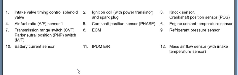

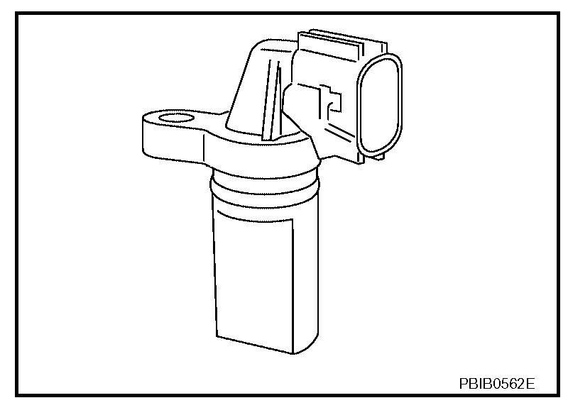

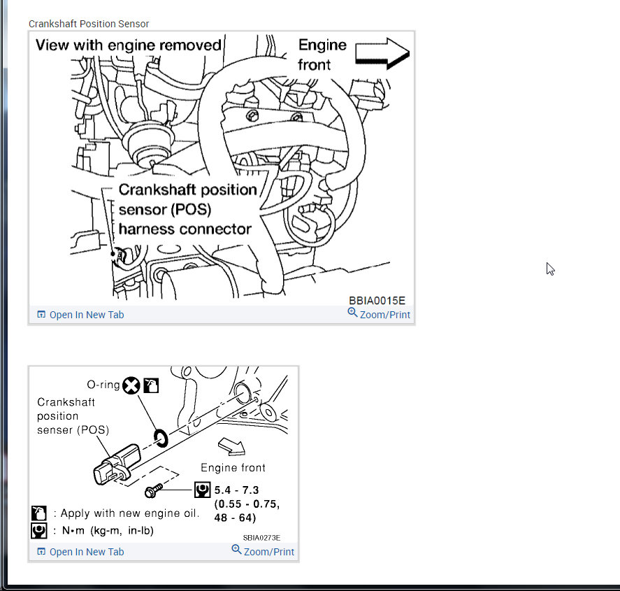

The crankshaft position sensor is located on the cylinder block rear housing facing the gear teeth (cogs) of the signal plate at the end of the crankshaft. It detects the fluctuation of the engine revolution. If you look at pic 1 below, it shows what the sensor looks like.
Here is a link that explains how in general one is replaced. Take a look through it and see if it helps.
On your vehicle, it really is nothing more than disconnecting the sensor connector, removing the retaining bolt, and gently removing it from the engine block. When you install the new one, place a small amount of motor oil on the o-ring to prevent damage when installing. Also, there are no relearn procedures required.

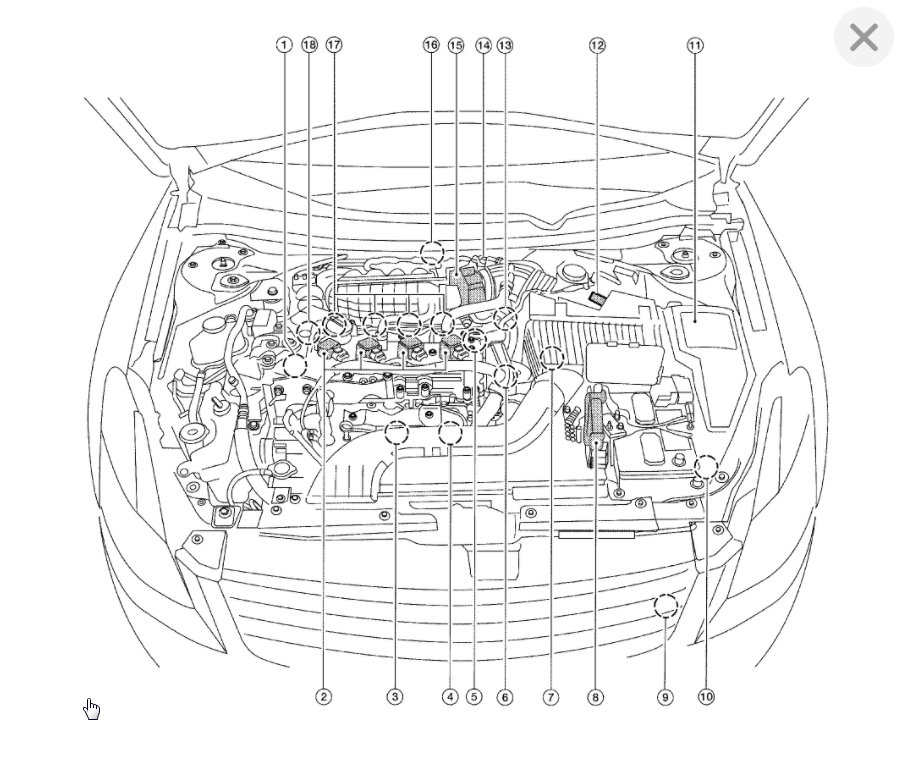

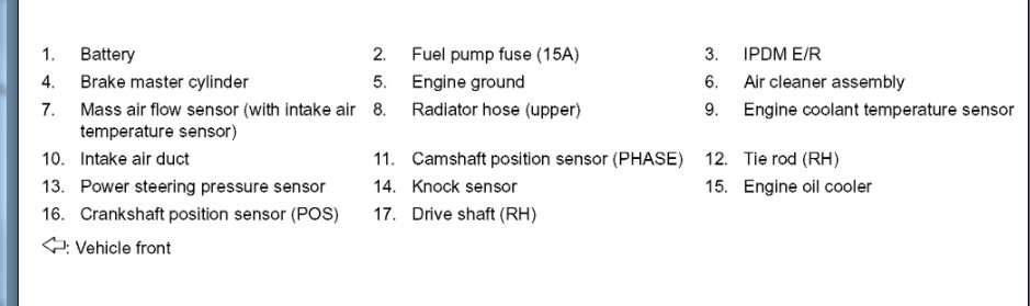

ERNEST FUENTES
  • 2006 NISSAN ALTIMA
Where is the camshaft & crankshaft sensor?
Sunday, February 21st, 2021 AT 6:04 PM (Merged)
KHLOW2008
  • 41,814 POSTS
Hi ernest fuentes,
Thank you for the donation.
The Camshaft sensor is located at rear of cylinder head. Item # 16 is tha cam sensor.
https://www.2carpros.com/forum/automotive_pictures/192750_CamSensor06Altima25LFig50_1.jpg
The crankshaft sensor is located on right rear of cylinder block, facing the gear teeth ( cogs ) of the signal plate at end of crankshaft, below the starter motor. Item # 3 is the crank Sensor.
https://www.2carpros.com/forum/automotive_pictures/192750_CrankSensor06altima25LFig152_1.jpg

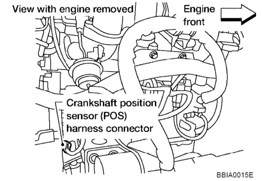

The sensor is at the back of the motor low on the block. I attached a couple of pictures for you of the location. It is held by a 10mm bolts and a connector.
