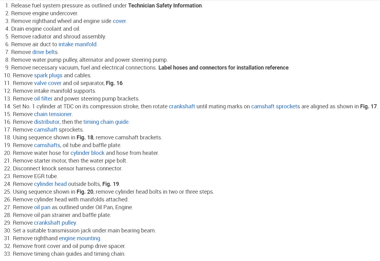

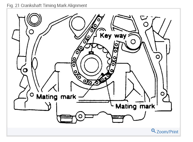

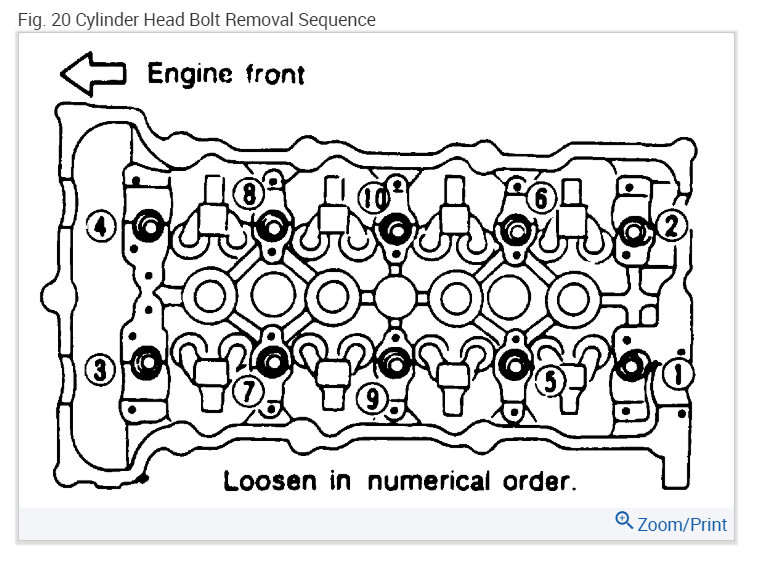

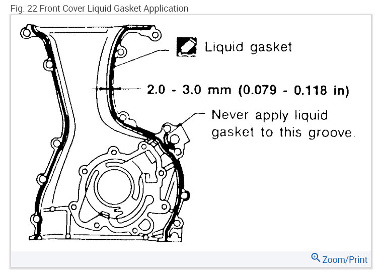

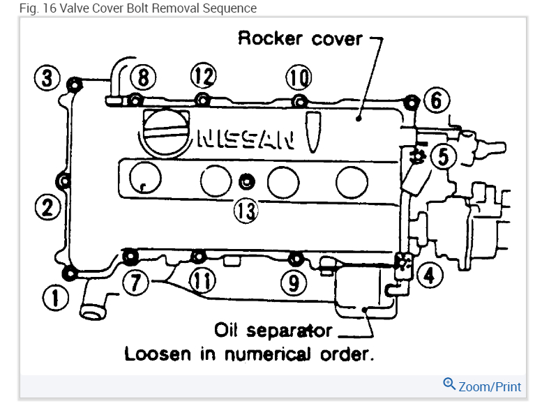

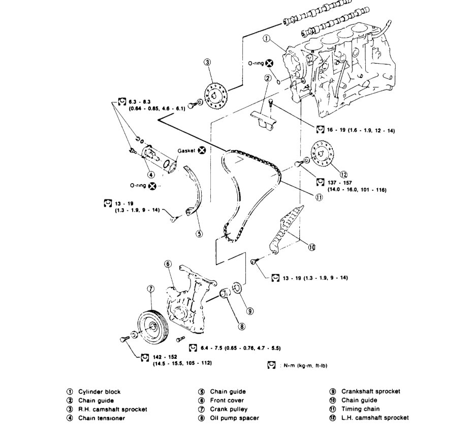

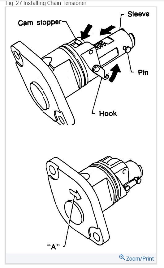

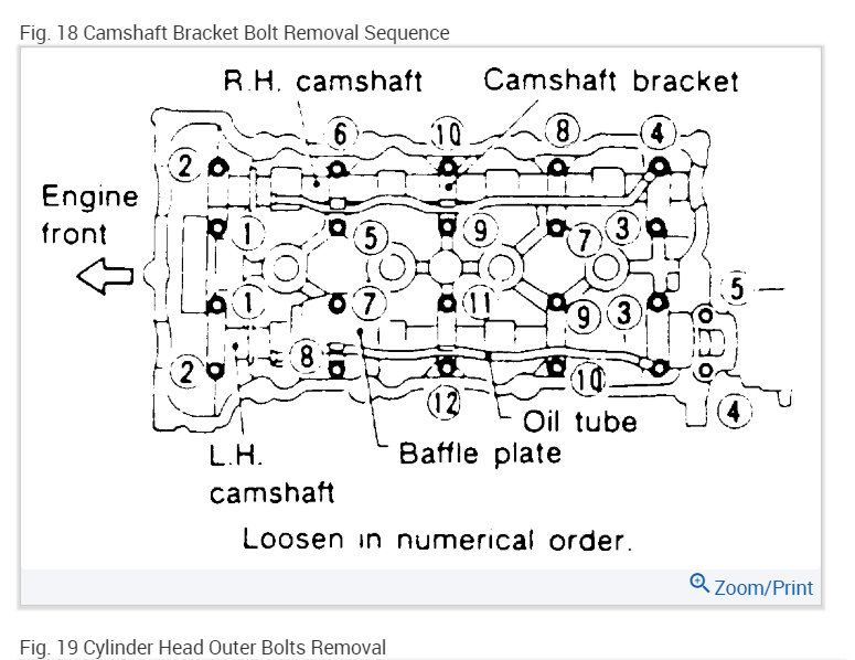

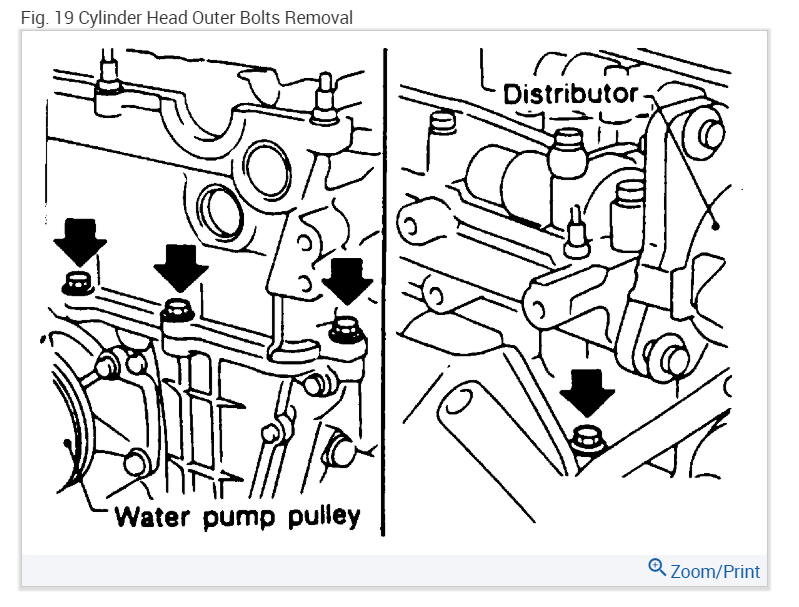

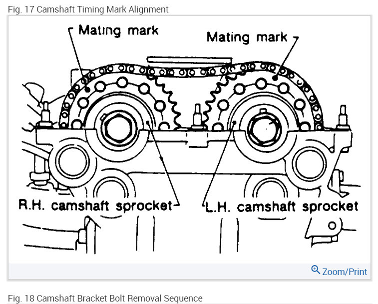

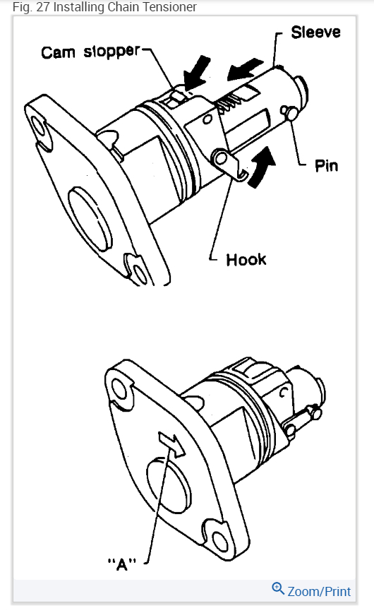

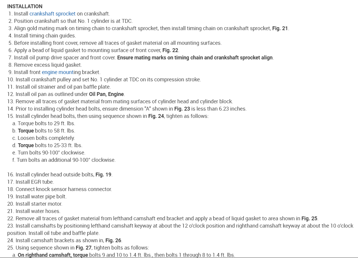

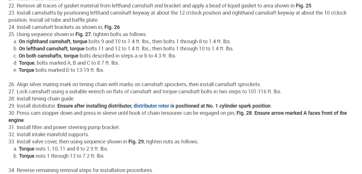

The 1995 200 SX has a timing chain. Here are diagrams below to show you how to do the job and the timing chain alignment marks. Check out the diagrams (below). Please let us know if you need anything else to get the problem fixed.
The 1995-1999 Sentra and 200SX (b14) either have a 1.6l or a 2.0 liter engine in them. Both have a timing chain. Engine noise: The timing-chain tension-er guide tends to break and the chain becomes very noisy. (1995)
I would replace it every 60,000 to 100,000 miles. Depending on how rough you drive it
If you hear a rattle coming from the timing chain area you should probably replace it.
