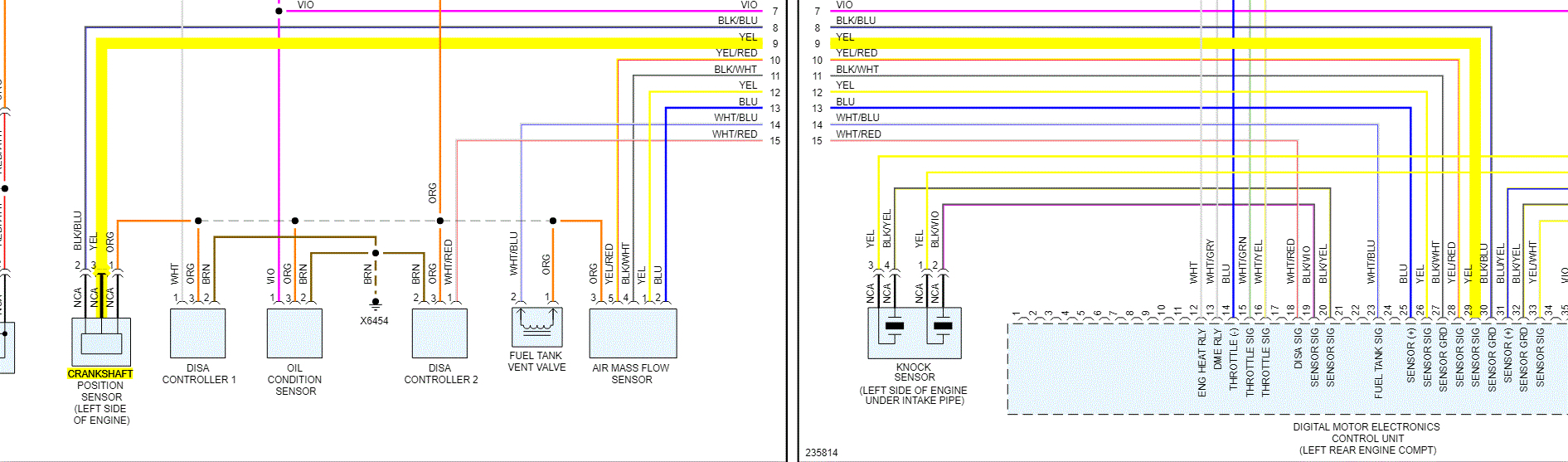

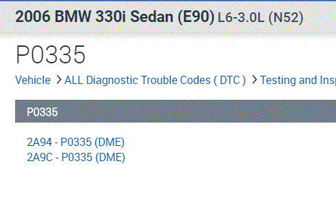

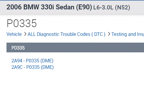

If you have replaced the sensor, then it is likely a wiring issue. The code you provided is general. There are two specific BMW codes. See the attached pic.
Now, if you can't get that, chances are it is related to the signal wire at the sensor. It is either open, shorted to power, or shorted to ground. So, check the wires to make sure nothing was damaged or pinched when the engine was installed.

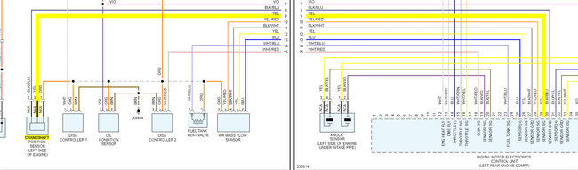

If you take a look at pic 2, it shows the signal wire is the yellow one in the harness. With the key on, confirm there is no power to it. With the key off, confirm there is no continuity to ground. If there isn't power or ground, you have an open circuit somewhere in that wire.

The engine crank and i have used a multi-meter to check voltage at the socket and with key on there is 12v pin1 orange wire, 5v pin 3 yellow wire and pin 2 is through to ground.
I have inspected the wires to the sensor and no cut where found.
At first when the engine was inserted it crank and started for some seconds then cut off. When i tried it again i noticed there was no spark to coil and no pulse to injector. I found a fuse was bad and replaced it and got back spark and pulse, after that the whole crankshaft sensor problem now started.

Here is what I'm seeing and why I suspect it is something with the signal wire. Take a look through this. This is specific to the manufacturer's code.
___________________
2006 BMW 330i Sedan (E90) L6-3.0L (N52)
2A9C - P0335 (DME)
Vehicle ALL Diagnostic Trouble Codes ( DTC ) Testing and Inspection Manufacturer Code Charts Digital Motor Electronics 2A9C 2A9C - P0335 (DME)
2A9C - P0335 (DME)
2A9C - P0335
Information saved in
DME
Fault code
2A9C - P0335
Fault text
Crankshaft sensor, electric
Fault description
Crankshaft Position Sensor 'A' Circuit
Condition for fault identification
Test condition:
Terminal condition: Terminal 15 on
Voltage condition:
Voltage in onboard electrical system > 10 V
Condition for fault memory entry
none
Action in service
1. Check signal wire for short to positive, ground, opens and
interference signals
2. Replace crankshaft sensor
Fault effect and breakdown warning
Driver information
Warning light:
NO
Service instruction
none

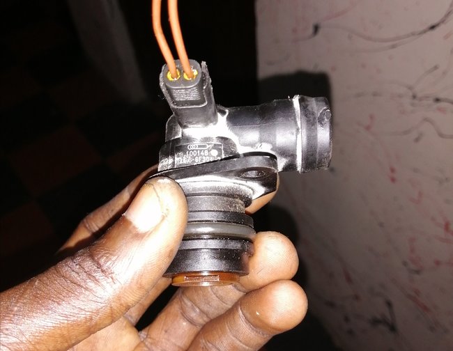

have seen the problem and it was the oil separator angle connector that bad. It was shot to the positive pin of the sensor which was also connected the crankshaft sensor wires. I have ordered for the parts and waiting for it to arrive.

Please how can i test the angle connector sensor with multi-meter? When i tested it gave me 4 omhs with the continuity sound on. Even the one a purchased read the same way.

The angel connector i bought was good i connected it an took the reading at the crankshaft sensor socket and the voltage did not cut.
Now am still getting the p0335 and the car won't start.
I just noticed that there is a loud sound of like metal jamming together coming from the engine anytime am starting the car.
And still saying crankshaft sensor.
