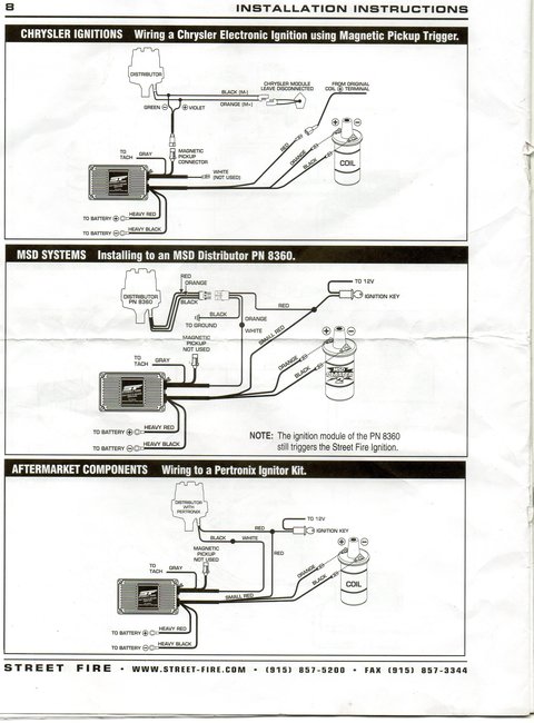

I just replaced my old ignition, coil and distributor with a new electronic ignition (Street Fire CD Ignition), coil and distributor (all electronic) but I cannot get my vehicle to fire up?
Now, I know enough about cars to figure out that it is not the fuel pump (I also replaced the old pump with a new stock one). There is just no spark being produced because when I spray Quick Start into the carburetor it will not even fire up for a second (which it should if there was any spark at all)?
The carburetor was also just rebuilt so I am ruling that out as the problem
My question to the forum is this; is the problem most likely with the way I set up the wire connections with the new electronic ignition, something wrong with the way I installed the new electronic distributor or could it be an issue with the new coil?
Thank you!

I replaced the original Mopar stock ignition system with a brand new "Street Fire CD" electronic ignition.

It is a Street Fire CD ignition with the part number 5520.
I think I may have found an issue with some of the wiring I did when installing this ignition. Using the Chrysler Installation Instructions option (top of page 8 of attached image) in paperwork that came with this ignition I see that there is a red wire that is supposed to be attached (that I did not attach) to a wire that comes "From the Original Coil Positive (+)Terminal "? I am not sure what wire this is? Can you tell me what wire they are referring to and where it is located?
Mar 1, 2019 at 10:41 AM
It is the wire from the ignition switch that powers the ignition coil. That will provide power to the entire unit.

I hooked that red wire from the new ignition to the positive terminal wire from the old coil (that I replaced with a new electronic coil) and she fired right up!
Running better than ever now!
