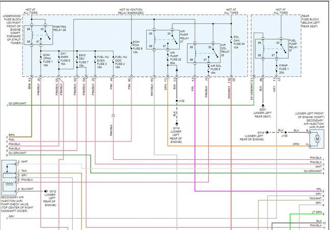

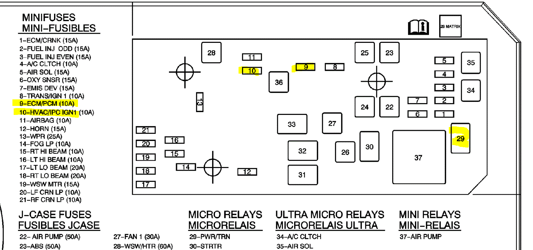

The P1682 is what I would focus on first. What it means is the ignition 1 voltage of the ignition main relay is more than 3 volts different than the ignition 1 voltage of the powertrain relay for more than 2 seconds.
To get started, check the two fuses I highlighted in the attached pic below (pic 1). These are located in the fuse box under the hood. In addition to checking the fuse, confirm there is power both in and out of the fuse. Here is a link you may find helpful:
Additionally, I highlighted a relay. Is that the one you replaced?
If fuses are relay are good, then we need to check the circuit. Here are the directions specific to your vehicle:

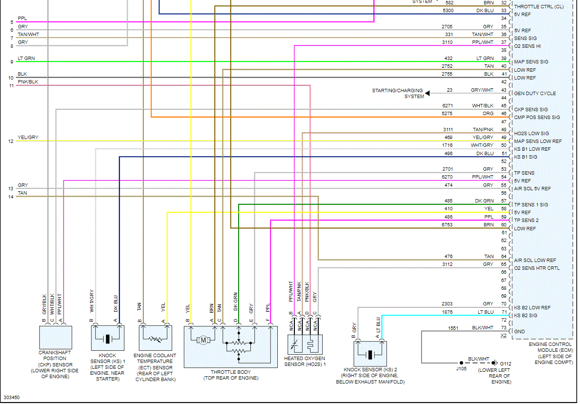

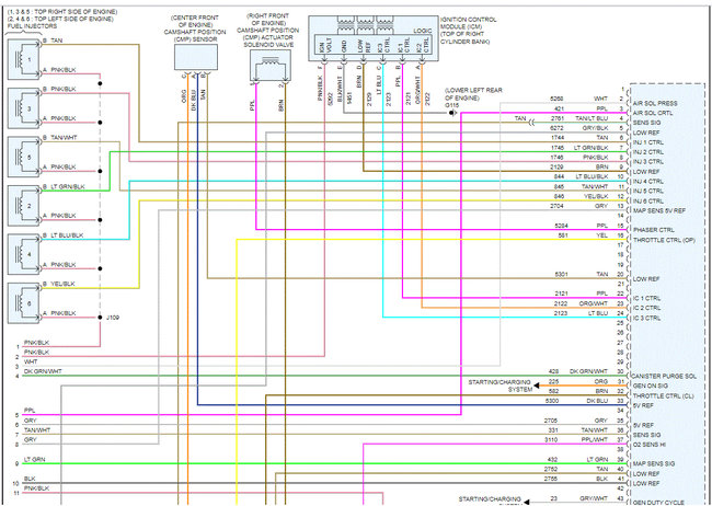

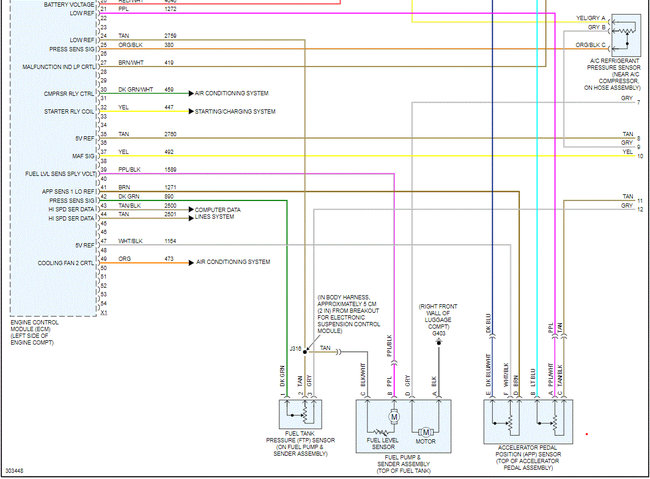

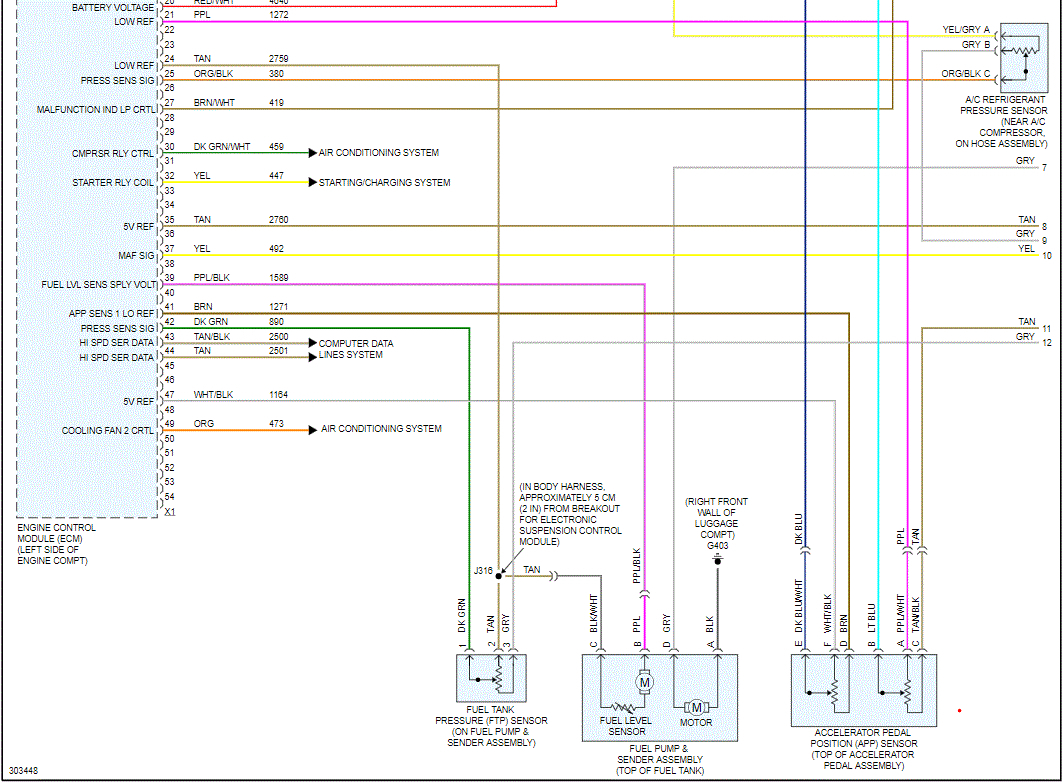

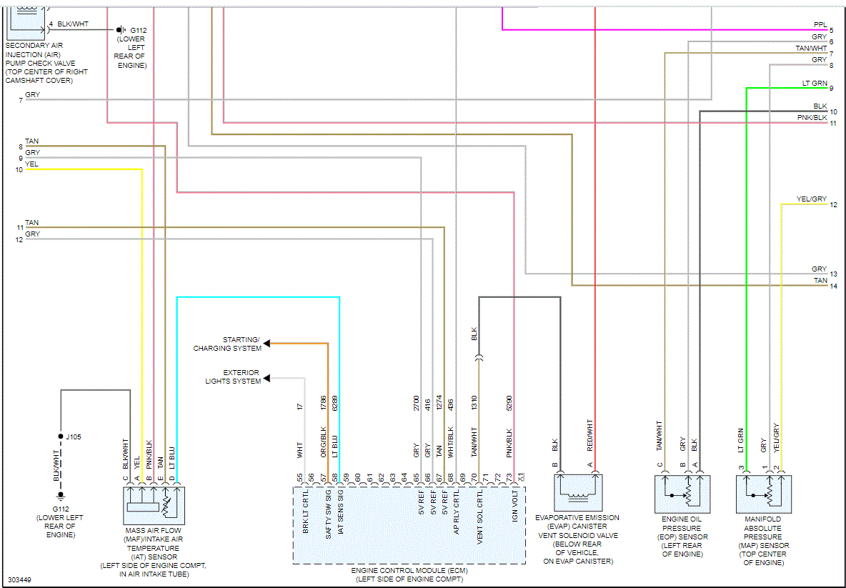

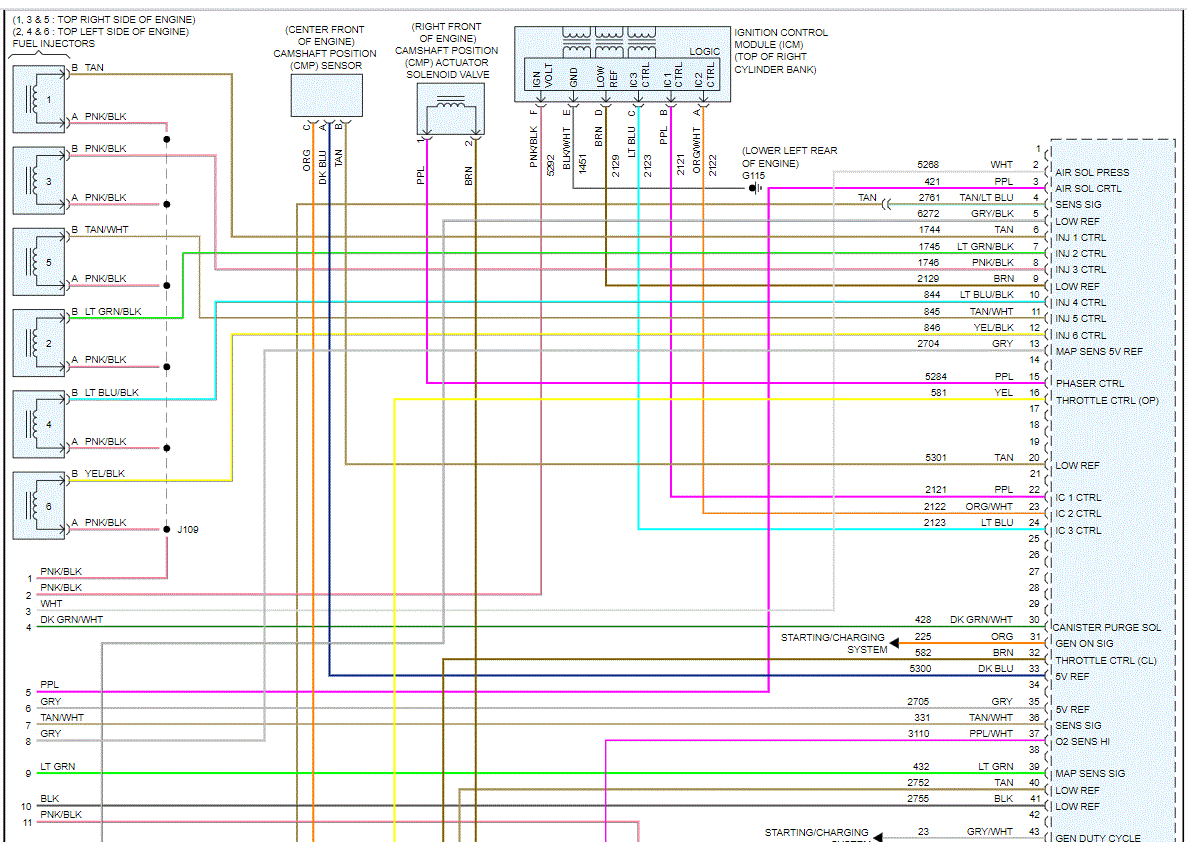

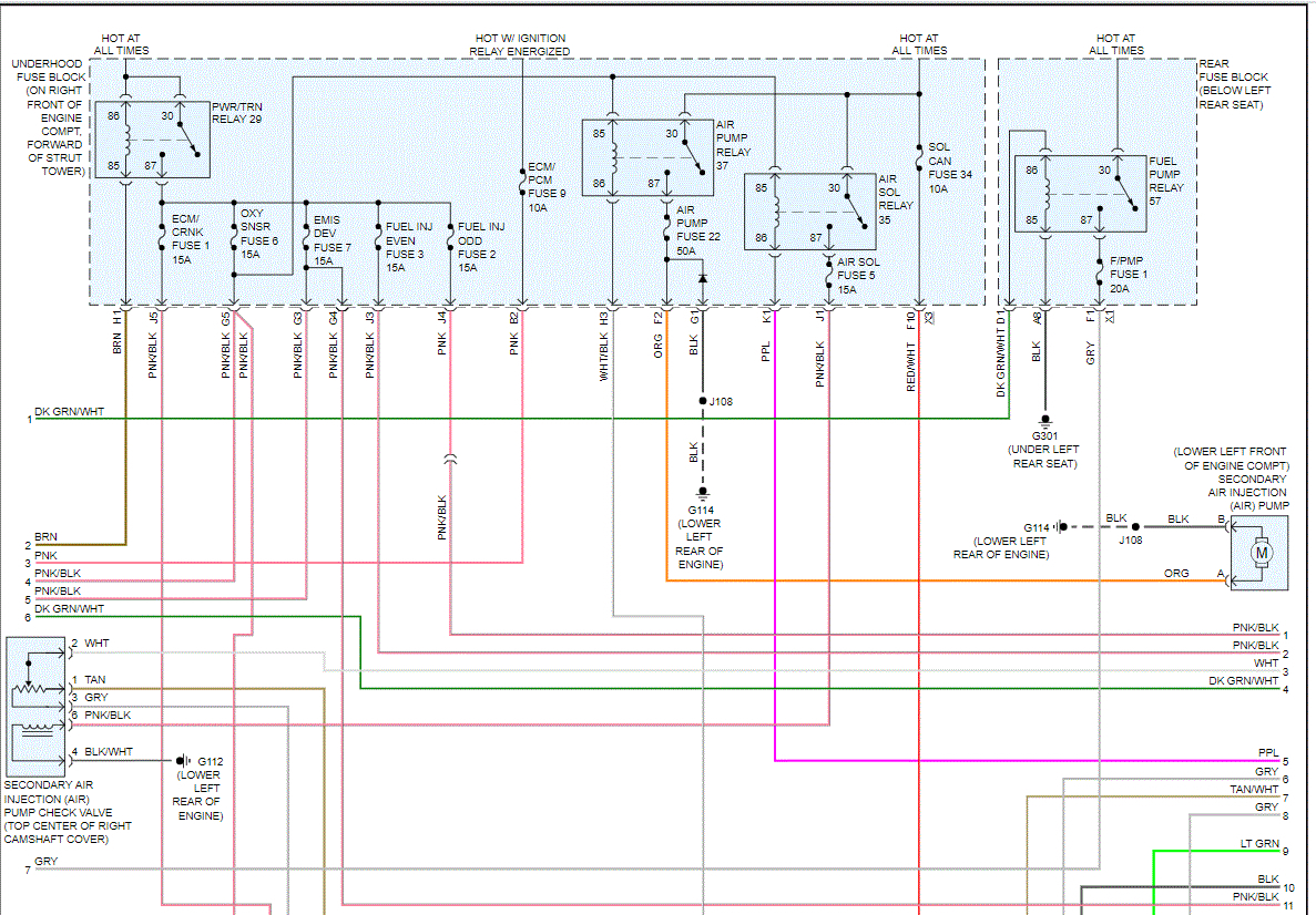

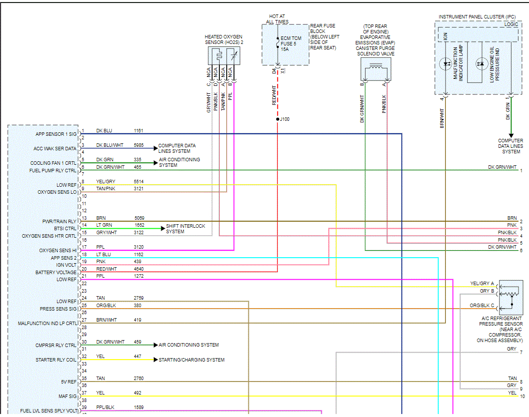

Starting with pic 2, I attached the entire powertrain management wiring schematic for reference. I had to cut each pic in half to make them readable, but I did overlap them so you can follow from one to the next.
I hope this helps. Let me know what you find or if you have other questions.

I believe I have located the source of the P1682 code, with your kind help Joe.
I verified fuse 10, then checked the powertrain relay. Everything checked out okay. I then tried to check the ignition voltage at pin X11-19 on the ECM. I was getting a sporadic (rapidly changing) voltage between 1 volt and battery voltage. Checking the wiring diagrams, I saw that this pin is connected to fuse 9 under the hood. I removed and tested fuse 9; perfect continuity, no sign of distress. I checked the voltage coming into fuse 9 with ignition on; steady battery voltage. I then checked continuity between the other terminal of fuse 9 and pin X1-19 of the ECM connector. Perfect continuity, reading in the u-ohms. So what's going on? I reset my meter to again test for voltage at pin X1-19, and plugged the fuse in. It wiggled.
Apparently there is a problem in the under hood fuse block. That connector is not making acceptable contact. At times I can get fuse 9 to make connection for a few minutes, but then it loses it again. I can only assume that the connections were already weak and overheated during the low-voltage crank attempt, causing the fuse to fail to connect. I have come across poor connections in other places with this car.
At this point I have two additional questions, if you would be so kind: how difficult is it to replace that fuse box (I am willing to spend the $150.00 for a new one), and what is the probability that this is the source of my problem? Specifically, during power on, does the ECM make the voltage check before checking for anti-theft? Recall that I am not getting the anti-theft warning light as I should be.

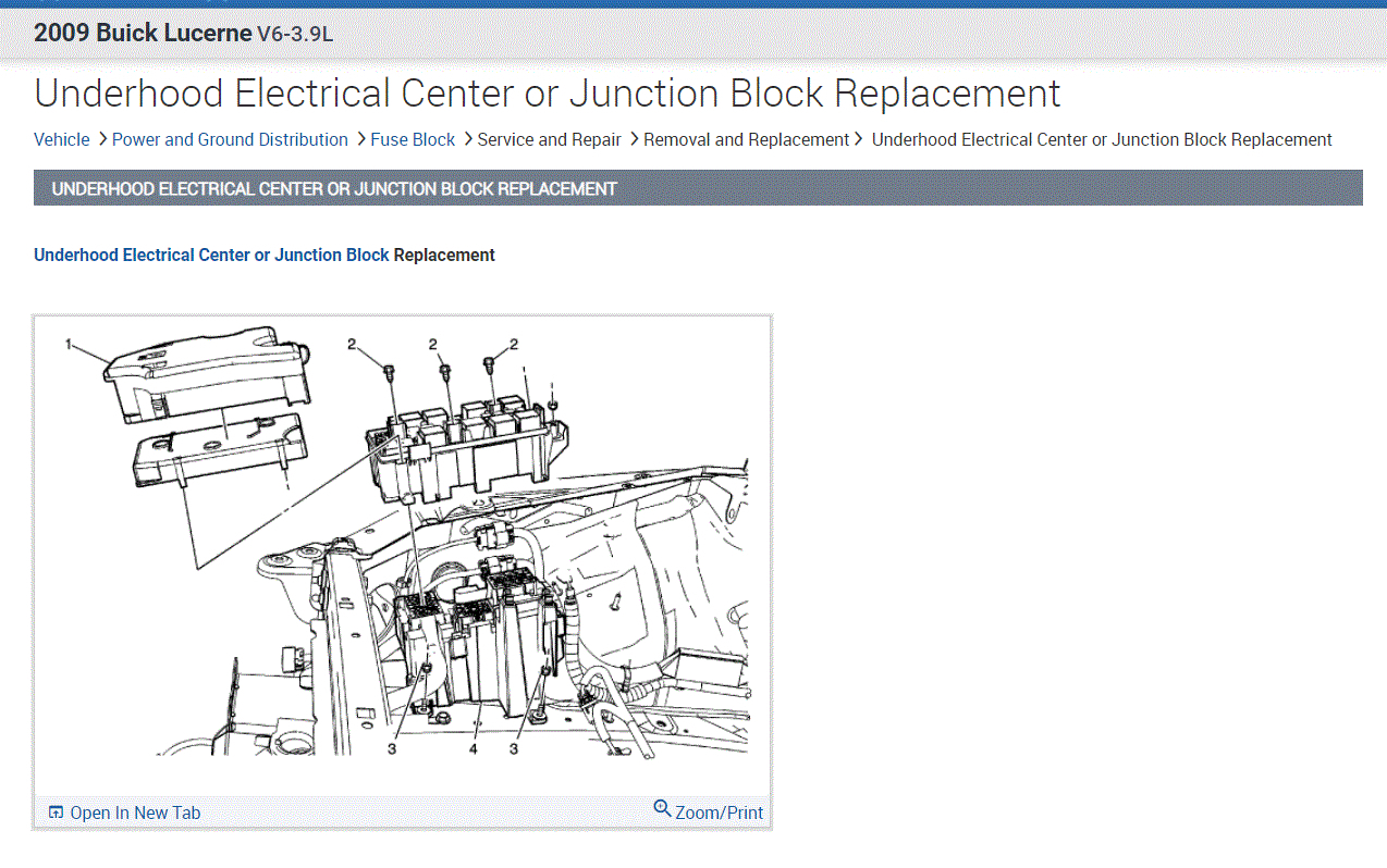

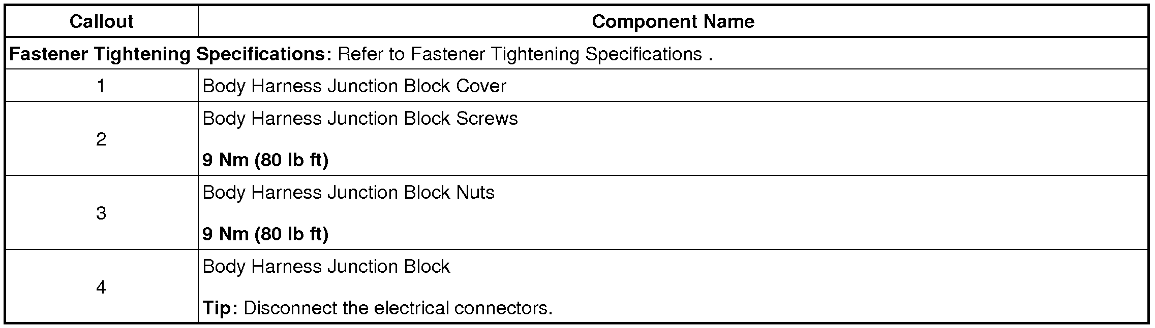

The under hood fuse box really isn't too bad. Once the battery is disconnected, it is basically and unbolt and reinstall the new one. If you look at the two attachments below, they are from my manual. They show both pics and directions.
As far as the problem, if you are losing voltage due to a poor connection, that certainly could cause the code you are getting. Before you replace the box, disconnect the battery and see if you are able to manipulate the connectors in the box to maintain good contact. You may be able to fix the one you have.

Wonderful! I already tried doing some manipulation on the box with no luck. I'll try again with it out of the car. My biggest concern was having to cut and splice wires back into the harness. That is a long, tedious job and the chances of making a mistake are pretty high. Not to mention it is asking for future issues. It looks like the box just plugs in, so that's no longer a concern.
