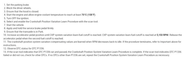

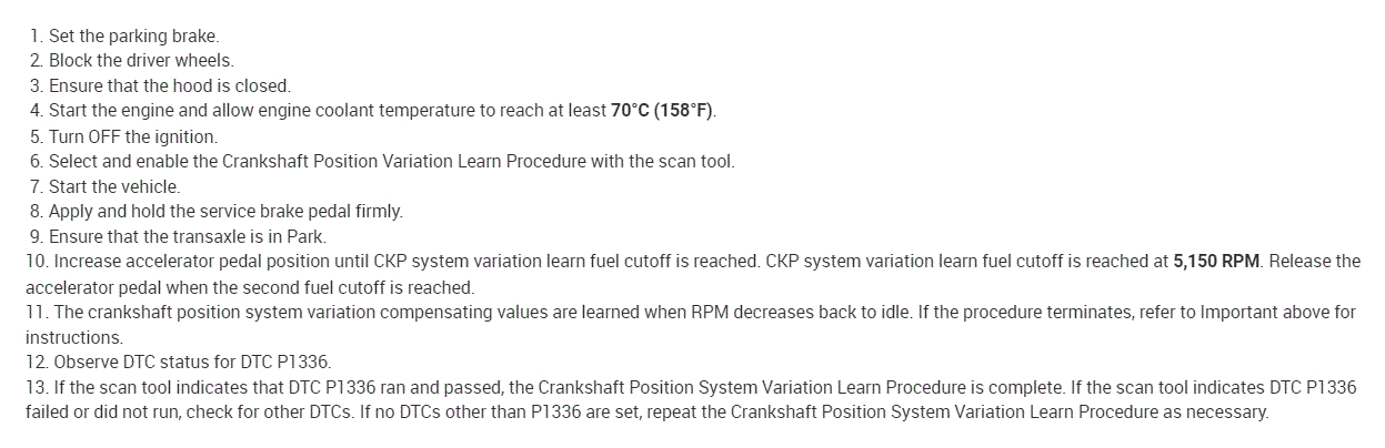

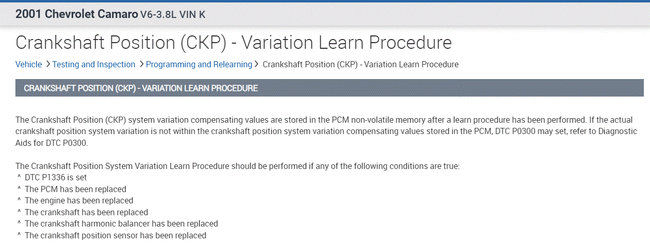

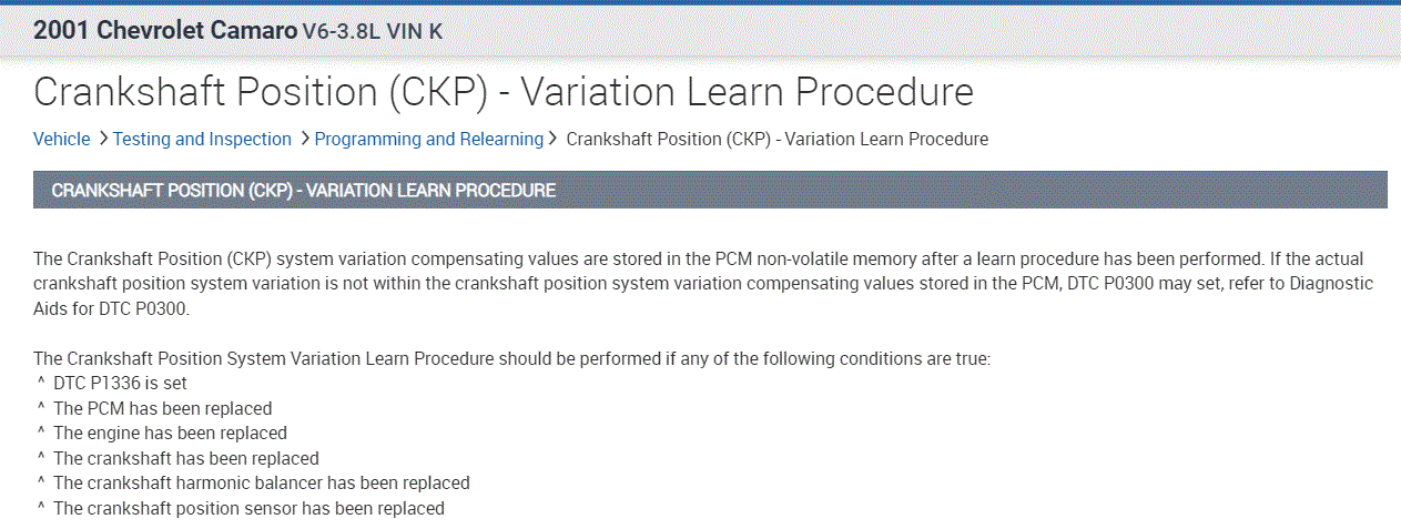

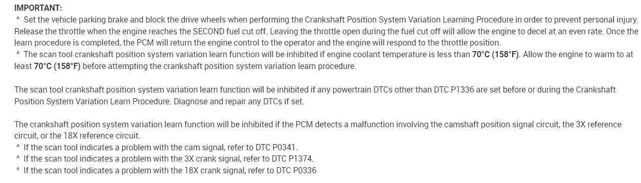

As far as a relearn, the only thing is a variation relearn. If you replaced the sensor, the engine should start and run.
Note: I made the assumption this is a 6 cylinder. If that is incorrect, let me know.
If you look at the attachments below, they are the variation relearn procedures for this vehicle. Take a look through this link and let me know if you have questions.

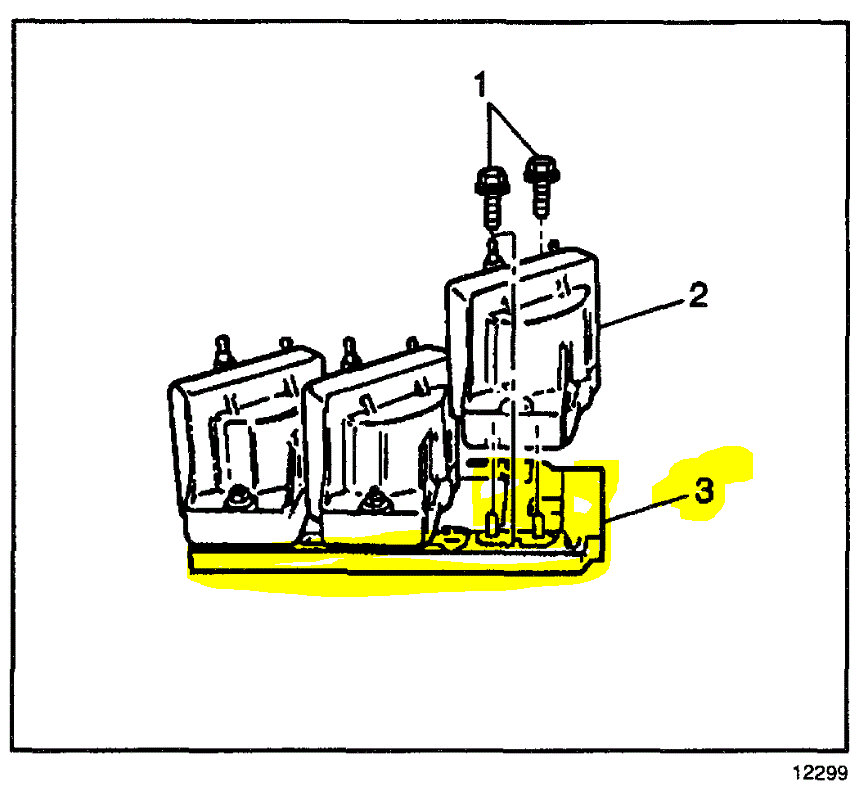

When this happens, does it start right back up or do you have to wait? It could be related to the ignition control module. That is the component the coils mount to. If that is bad and the vehicle doesn't immediately restart, check for spark at the plugs. Here is a link that explains how that is done:
https://www.2carpros.com/articles/how-to-check-for-ignition-spark
I attached a pic below and highlighted the ignition control module.
See pic below.
