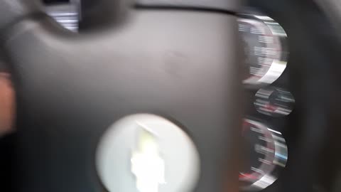

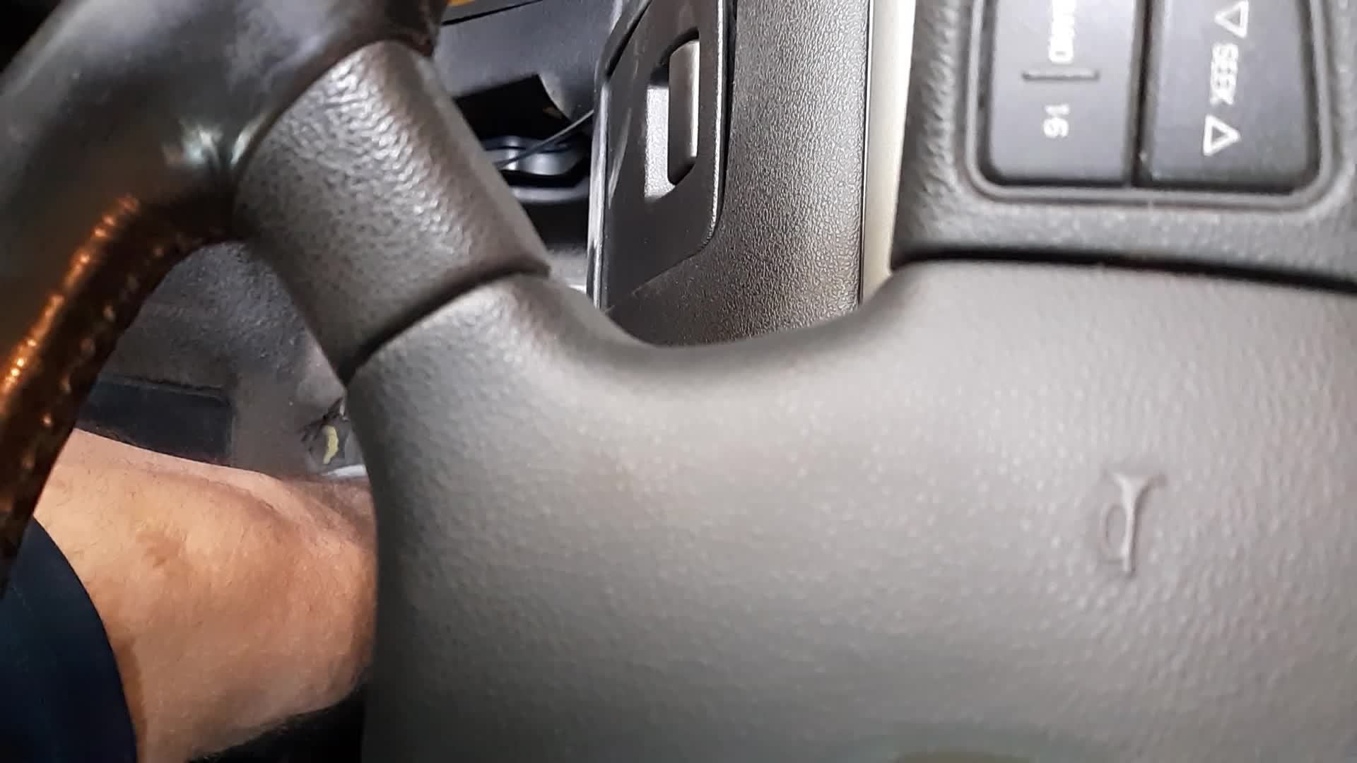

Here is a video. Hopefully you can hear it.
Aug 23, 2020 at 4:23 AM
Okay, thanks.
Sounds like the throw-out bearing.
YouTube video for replacement.
https://www.youtube.com/watch?v=6N6b5F2ChyE&t=1819s
