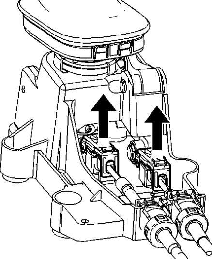

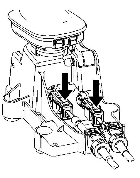

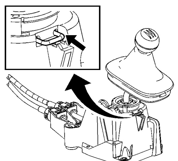

I put in a new clutch. I bleed the hydraulics , sleeve ect. I get 1st and 2nd and reverse? I will bleed it again and get 3rd and 4th, and no 1st and 2nd and 5th. now I only can get 5th?
May 15, 2019 at 5:46 AM (Merged)
HMAC300
  • 48,601 POSTS
if it worked ok prior to replacing clutch the cable for shifting may be out of adjustment or something got bent in shifter mechanism at trans.
remove cup holder, put shifter in neutral and remove clips at trans shifter may need to be moved slightly and lock clip at shifter.press and lock shifter cable retainers remove clipat shifter handle reinstall everything
