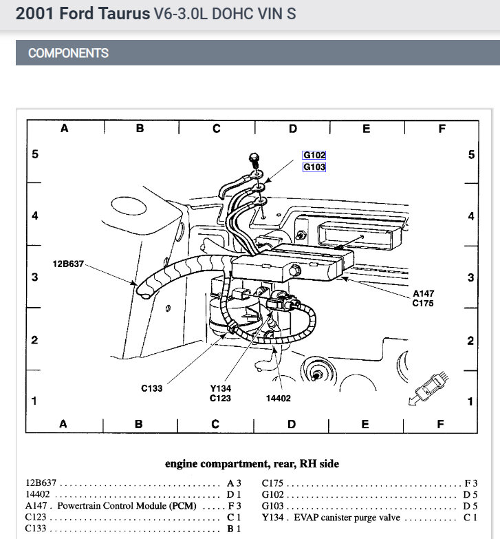

I recently replaced the battery on my car listed above with a slightly larger one (720cca vs own 650cca) and several new codes appeared when I started it. The check eng light came on as well as the ABS and my new codes are P0750, p0743, p0760, p1451, p01747, p0135. Did I screw something up? I left an important piece of info; I crossed the jumper cables before I replaced the battery. I did start it with the old battery a couple of times after that and no codes appeared, but I'm not sure if crossing polarity damage can be a delayed process or not. All fuses are okay.

So, I would clear the codes and see if they come back. It could be a glitch due to connecting the battery. If they do come back please start a new thread for each code.

I cleared the codes and unfortunately, they came back. As I stated in my original post, none of these codes appeared before my battery mishap.
So, I guess my question to you is, which code should I address first?

If all of these codes came up at once after the battery replacement, I would say the voltage surge took out the PCM, you can get a preprogrammed unit by searching Google or Ebay. Here is a guide to help walk you through the repair and I have included instructions in the images below for your car:
