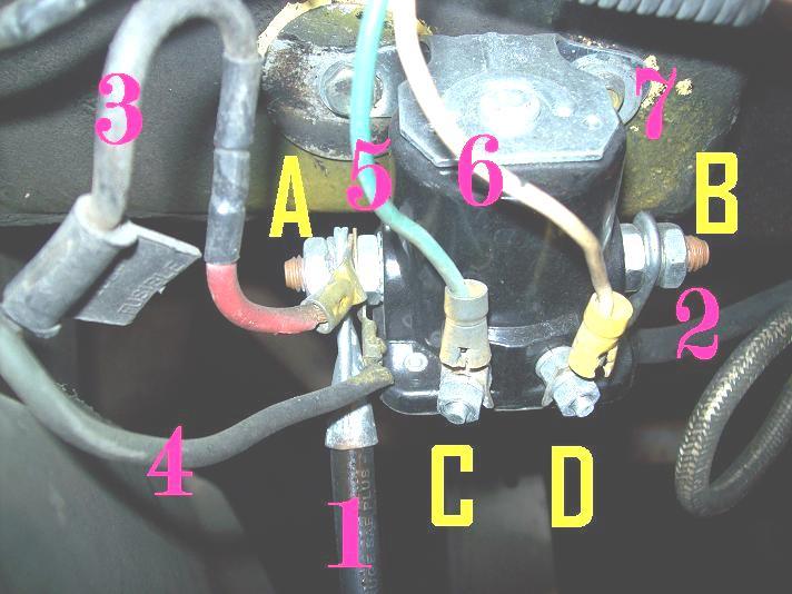

YOU ARE GONNA HAVE TO FIND WHERE YOUR WIRING DRAWS IT'S POWER FROM THE BATTERY
ON THE JEEP IT'S AT THE SOLENOID, WHERE THE POSITIVE BATTERY CABLE IS STACKED TOGETHER WITH A WIRE TO THE ALTERNATOR AND THE OTHER TO THE FUSE BOX
IN MY PIC (OF MY '46 WILLYS, WHICH I COMPLETELY WIRED TO CLOSELY MATCH A 1979)
"1" IS THE POS CABLE FROM MR. BATTERY
"3" RUNS TO THE ALTERNATOR (HAS A TAG ON IT)
"4" RUNS TO THE FUSE BOX (NO MARKING AT ALL)
THE 1st FEW INCHES OF BOTH OF THESE WIRES ARE FUSIBLE LINKS (THEY ARE RATED IN "GAUGE" SIZE) BASICALLY THEY ARE SACRIFICIAL WIRES, LIKE FUSES. THEY ARE AT THE BEGINNING OF THE WIRE TO BE PROTECTED, AND COULD BE IN OTHER LOCATIONS.
IN THE PIC, IT ALMOST APPEARS THAT 3 AND 4 ARE THE SAME WIRE IN A LOOP, THEY ARE NOT!
WHEN A FUSIBLE LINK "GOES", THE WIRE USUALLY DISINTEGRATES
YOU CAN TEST WITH A 12 VOLT TEST LIGHT FROM STARTING AT "GOOD 12V" THEN STABBED INTO THE WIRE AND GET NO VOLTAGE (OR VOLTAGE)
OR
LOOK FOR BUBBLED INSULATION/ BURNED IN HALF WIRE/ OR JUST GIVE THE BEGINNING OF THE WIRE A FIRM PULL, IF THE WIRE IS GONE INSIDE, THE INSULATION MIGHT STRETCH OUT LIKE A RUBBER BAND
*********LET'S INSURE YOU DID NOT PUT A REGULAR WIRE IN PLACE OF A FUSIBLE LINK!!!*********
I'M SPEAKING OF YOUR BURNT WIRE (WAS IT WIRE? OR FUSIBLE LINK?) CAN YOU DETERMINE THIS? YOU REALLY NEED A FUSIBLE LINK, TO REPLACE A BAD ONE!

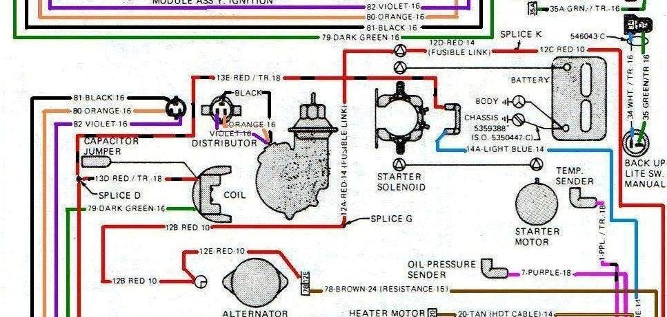

MY SECOND PIC IS A LITTLE CHUNK OF A 1979 JEEP CJ DIAGRAM. I SORTA ZEROED IN ON THE SOLENOID (MY OTHER PIC HAS MY WIRES REVERSED FROM THE WAY THE DIAGRAM SHOWS)
WHAT'S IMPORTANT IS THE BATTERY CABLE STACKED BESIDE THE "FEED WIRES" ON THE SAME BIG TERMINAL, AND THE STARTER CABLE ALL BY ITSELF ON THE OTHER BIG TERMINAL
2nd DIAGRAM SHOWS THE FUSIBLE LINK "VALUES/ GAUGE" THEY SPLICE ONTO THE REGULAR WIRES AT "SPLICE G" AND "SPLICE K"
IT APPEARS THAT THESE 2 WIRES CONNECT AT THE CIRCLE W/ TRIANGLE INSIDE, ACTUALLY, THE CIRCLE THINGEE IS 2 STAKE-ON RINGS STACKED TOGETHER.

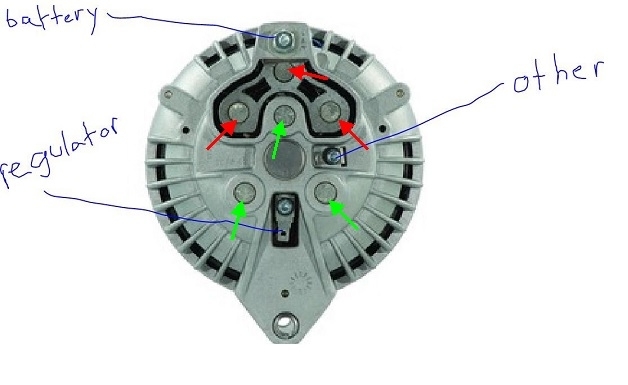

As a point of interest, I added some nifty arrows to the photo to show the diodes. The green arrows are pointing to the three "negative" diodes. Diodes all have two terminals and a polarity. Here the term "negative" just means which of those two terminals goes to ground. It is attached to the metal cover that is pressed into the alternator's rear housing. The red arrows point to the "positive" diodes. The metal block they're in is insulated from the rest of the housing, and it is where the output terminal is attached. That's the "battery" terminal is this dandy photo.
These diodes had an uncommonly low failure rate, but any time one diode fails, the most you'll be able to get under full load is exactly one third of the alternator's rated capacity. The full rated output for cars with air conditioning was commonly 55 amps, so if you found around 15 to 20 amps during the output current test, you knew there was a bad diode.
Not to complicate the issue unnecessarily, output current starts at ground, flows through a diode, one third of the stator winding, through another diode, then out to the battery's positive post. Those diodes are all that stands in the way of a direct short to ground. If one diode shorts, you still have the three in the other group to block current flow. It's when you have any one negative diode shorted AND any one positive diode shorted, that you have a dead short, lots of current flow, and a burned-open fuse link wire. Be aware the size of that fuse link wire depends on the current rating of the generator installed at the factory.

Ok, thank you for that. But I did find what I am sure is the. Culprit. Will post pics of connector to regulator. It is a differe plug style than what fits snug on the regulator. The reason it was missed...the parts store guy put it on for me. Anyway, its causing an overload to other wire on alternator. I put in new wire...will need to repair some that melted to red. Bought a new regulator. And ordered a new connector plug. That should do it. I'll update when done, & tested. Thanks again.

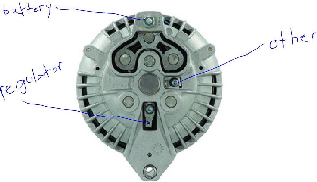

So is the system working? If not, lets clear up the wire colors. On cars, the fat output wire from the alternator is a black wire bolted to its terminal. The two smaller wires plug into the brush terminals. The 12-volt feed is dark blue, and the control wire going to the voltage regulator is green.
The dark blue 12-volt feed wire was often a red wire on trucks. When you mention the red wire, is it one of those smaller brush terminals which is also found in the regulator's plug, or is it the fat output wire?

ok on mine the 12v lead is red. otth
Dec 28, 2017 at 3:24 PM
CARADIODOC
  • 34,379 POSTS
Is that the fat output wire that's bolted to the large terminal on the back of the alternator or one of the two smaller ones that slides onto one brush terminal?
