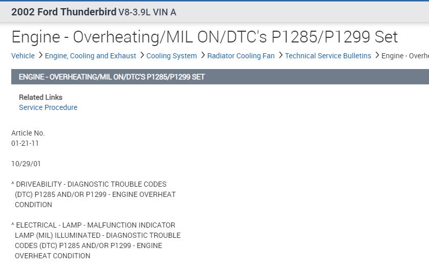

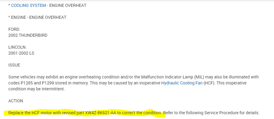

It's not working properly at all as it still makes the noise from the A/C when driving at rpms above 2.5k and especially as the engine gets hot then A/C stops blowing cold the noise gets worse, so I turn the A/C off as I am scared it's going to blow up. Have you read or heard much about an issue with a hydraulic cooling fan pump or the solenoid on the pump sticking? The T-Bird, Lincoln LS V8, and Jaguars kxe in 2002 had them and I think they went to electronic fan a year or two later. The pump is hard to find and expensive and seems you can't buy the solenoid by itself as it's discontinued.
Jun 28, 2023 at 9:25 PM
  • 110,194 POSTS
I've heard of them, but never had to work on one. I found a technical service bulletin related to overheating and the fan. I attached it below for your review. (Pics 1 and 2).
I took the updated part number and found a place that sells new old stock (nos) parts. Here is the link. Check it out to see if they can help. Note that the link is specific to the part.
Let me know if the codes indicated are present.
https://nospartsltd.com/product/xw4z8k621aa/
