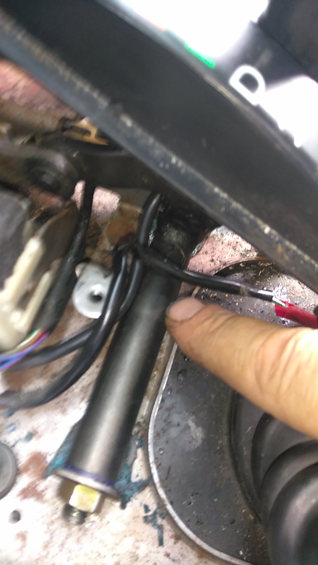

One of the thing it only starts in park and neutral which is good. I wound up switching out the bushings underneath the shifter on the t-bar. The shift lock control switch was not catching on the shifter pin so I fixed that too. It would not go into park. Now that is fine. But for life for me I just cannot figure out what else it could be.
Sep 13, 2017 at 11:16 AM
DANO1971
  • 32 POSTS
Here is the bushings I switched.
