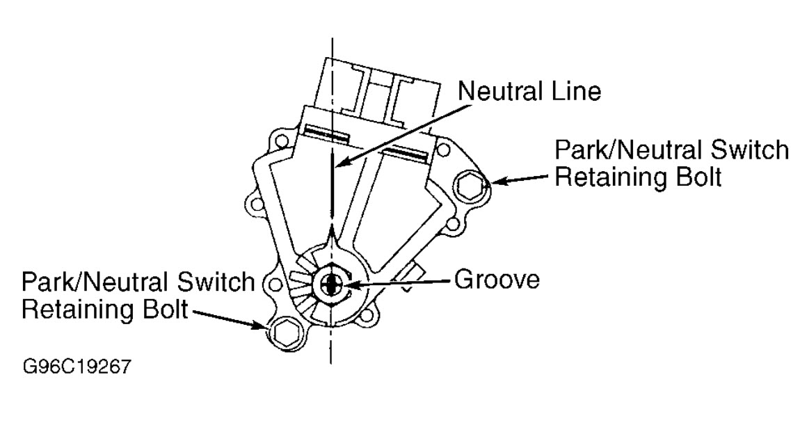

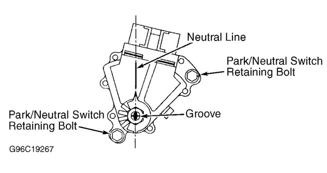

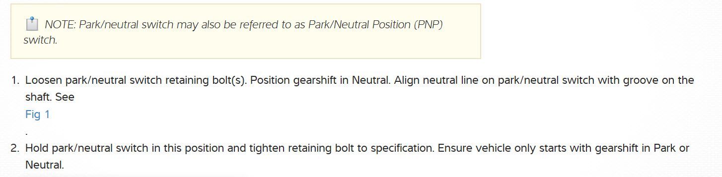

I am sorry on my last post I put I did not want to do it myself. I do need to do it myself because funds are low. I brought it in for emissions and it failed p1780 code came up. I have the part I have the neutral safety switch I was just wondering if you have any video showing how to do it on a older model Toyota 4Runner. Sorry about that.
Jul 1, 2017 at 12:01 PM
HMAC300
  • 48,601 POSTS
actually it is a transmission range selector switch. this is pretty easy to do put truck in neutral first and block the wheels. See pictures.
