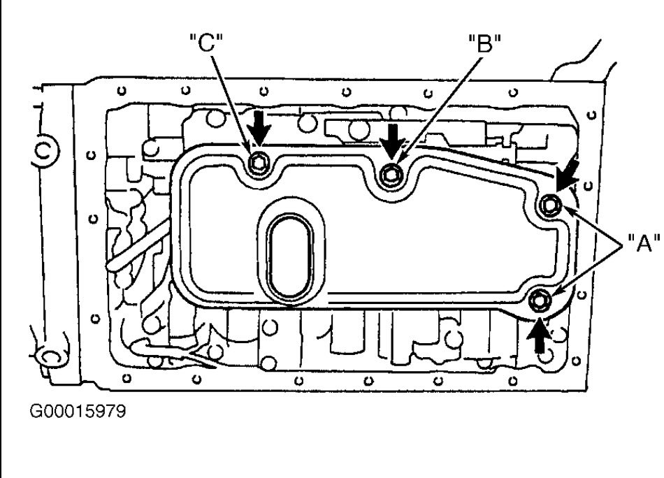

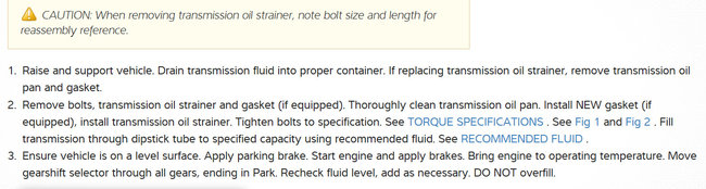

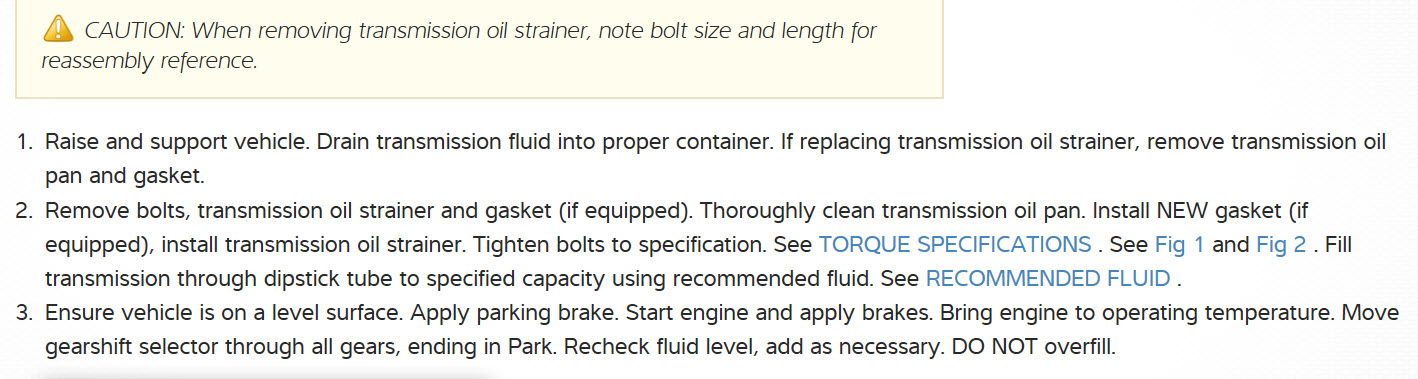

Transmission fluid needs changed. Transmission service kit (transmission fluid, filter and gaskets).

recommended fluid is DextronII or DextronII ATF. see pictures for how to do it.
