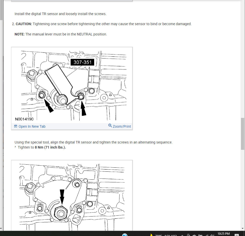

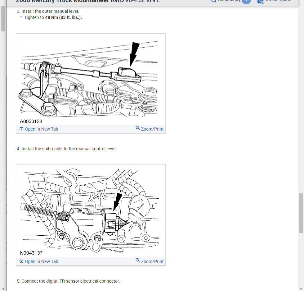

I need to change my neutral safety switch. Someone tried removing it but the center (larger) bolt is now just spinning. Has this messed up my transmission? Also, how to get this changed now? Thank you in advance for the help.
Aug 11, 2018 at 8:23 PM
Good afternoon.

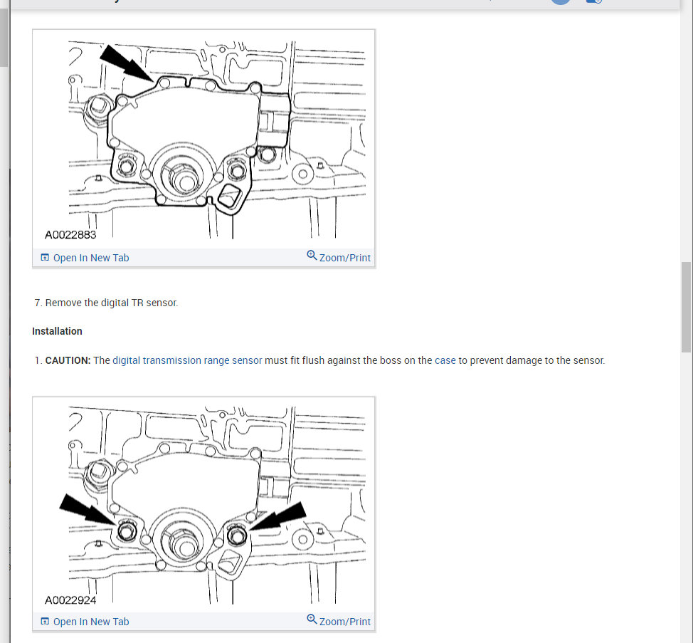

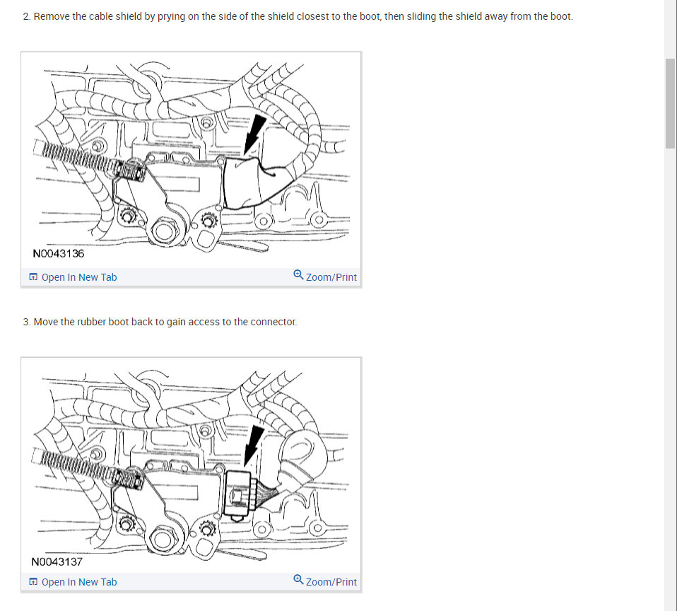

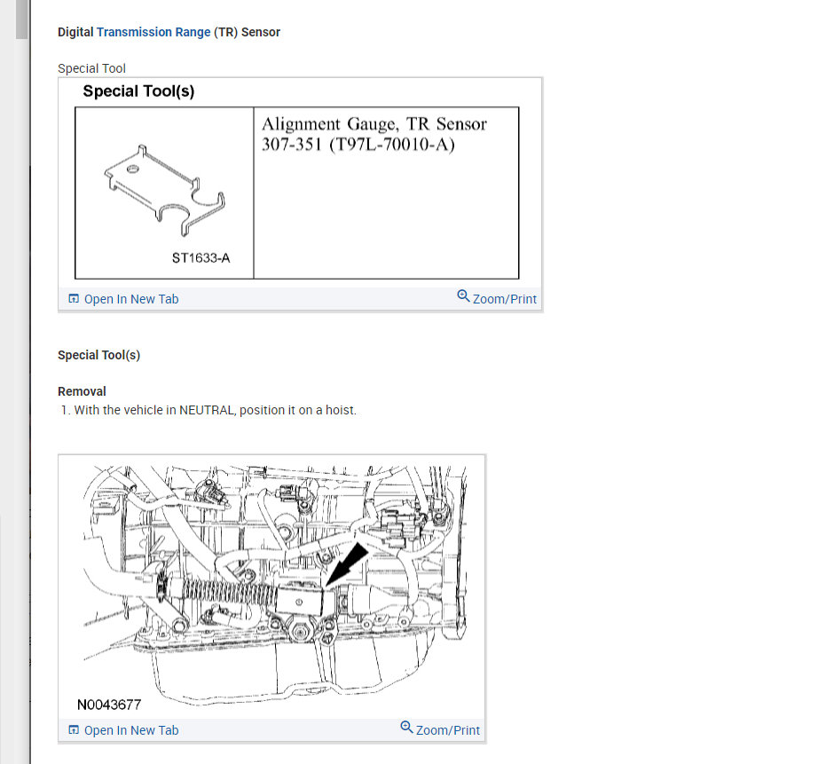

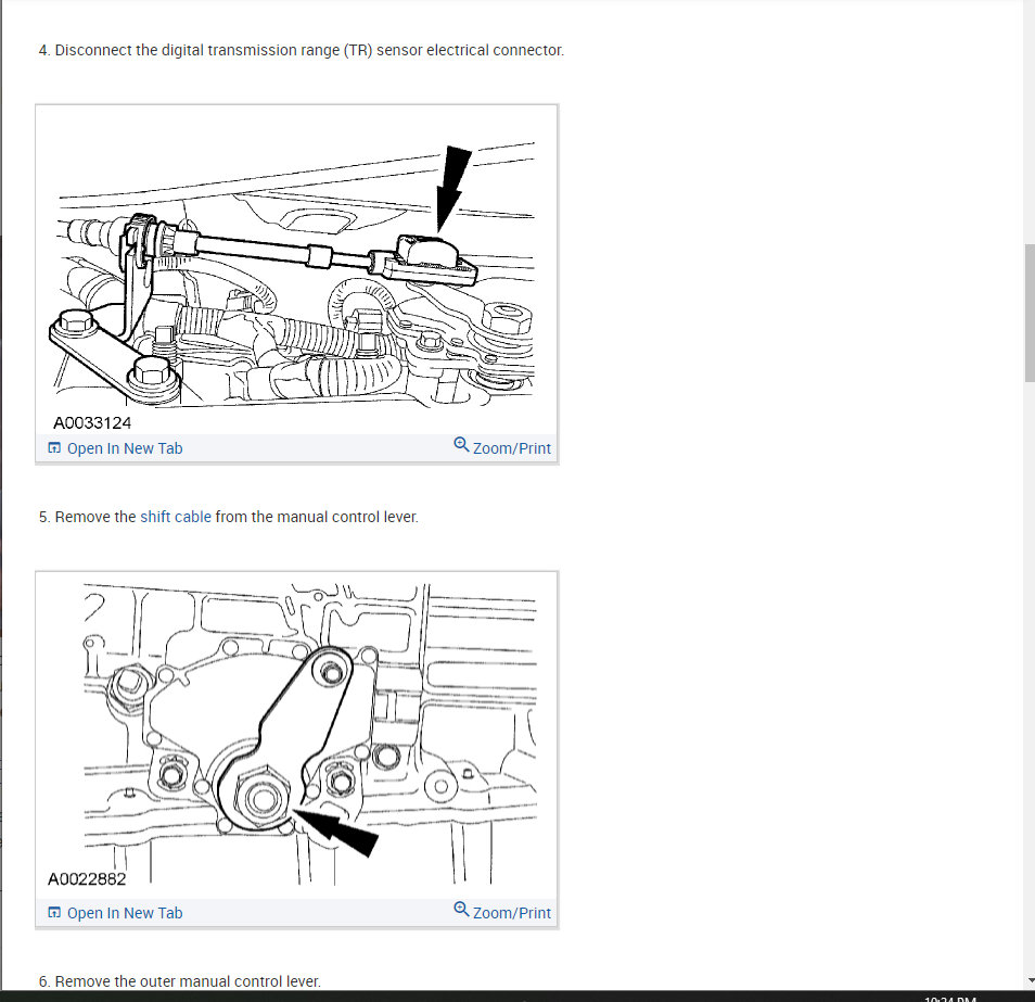

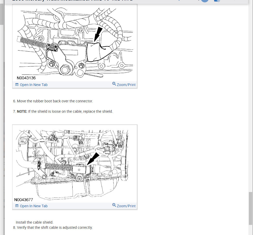

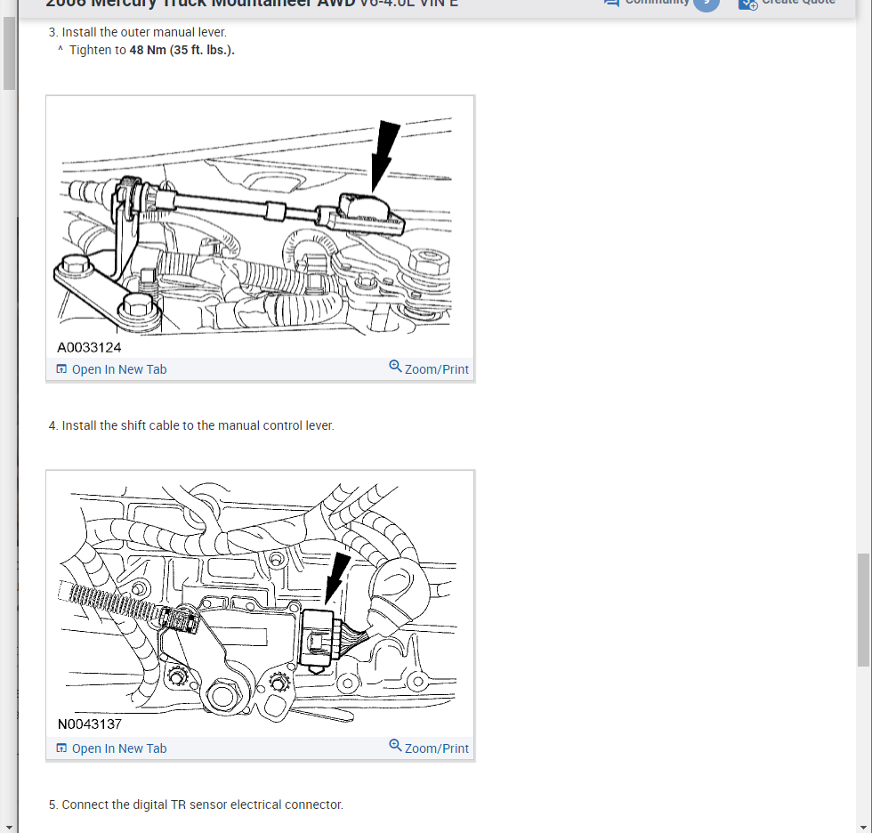

More then likely there is an issue with the shaft that the manual valve is connected to. You can try prying out on the bracket and see if the nut will catch. If not then I suspect the manual valve is broken which should be causing some transmission shifting from park to drive or even starting issue.
Please see below on the entire process on how to replace this switch

It definitely sounds like you have a bad neutral safety switch as that controls the gear showing as well as the starting in park and neutral.
Did they drop the pan and change the oil/filter in the transmission?
