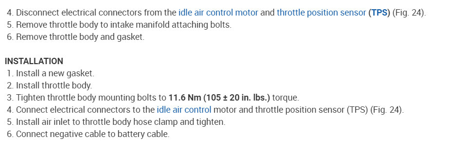

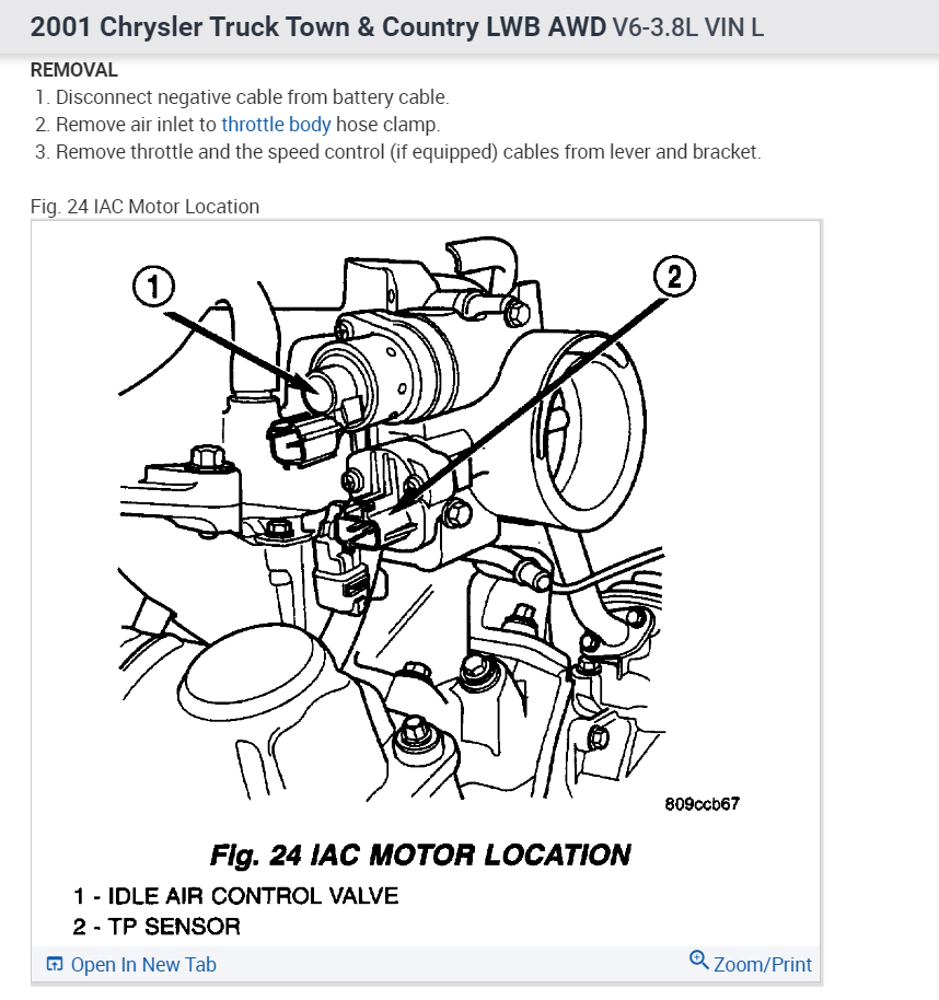

This can be due to worn out spark plugs, a dirty throttle body or a vacuum leak. Here is a guide to help us fix it with instructions below to show you how to do the repairs on your car.

This video shows how to service the throttle body.
https://youtu.be/Ui8zhMLp5EM
Check out the images (below). Let us know what happens and please upload pictures or videos of the problem.
