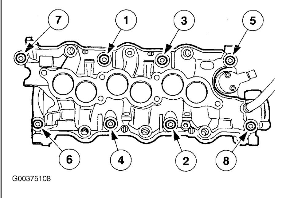

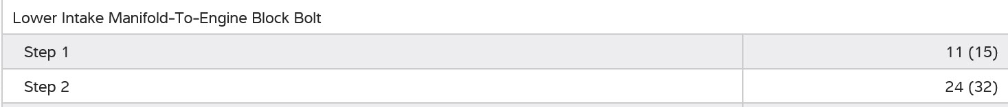

I have to replace the head gaskets on a 2000 Mercury Sable 3.0, I removed the following and need torque (and sequences) specs for the following:
Head Bolts
Exhaust Manifold Bolts
Lower Intake Bolts
Upper Intake Bolts
EGR Valve Bolts
Valve Cover Bolts

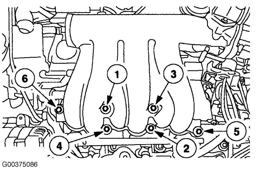

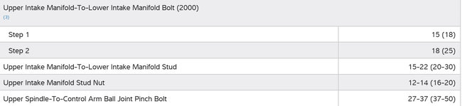

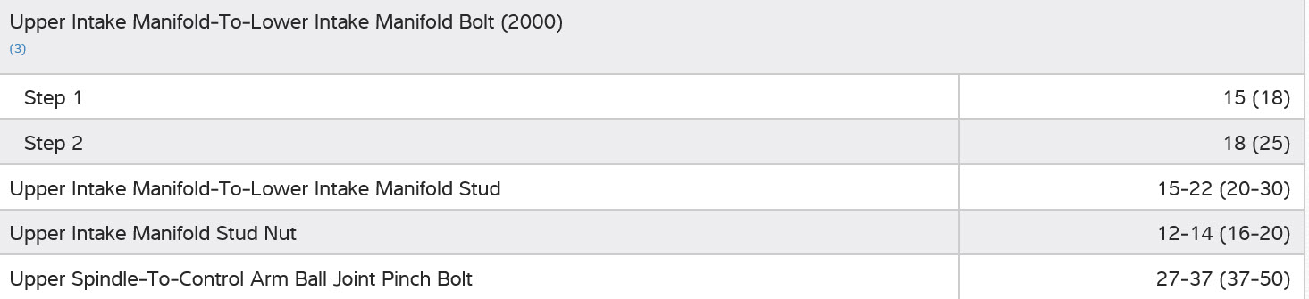

valve cover bolts 106 inch lbs. exhaust man bolts 15-18 ft lbs. all torques given in first line are ft lbs. unless otherwise like valve cover bolts. see pics in following email
Mar 29, 2016 at 7:08 AM
HMAC300
  • 48,601 POSTS
see pics

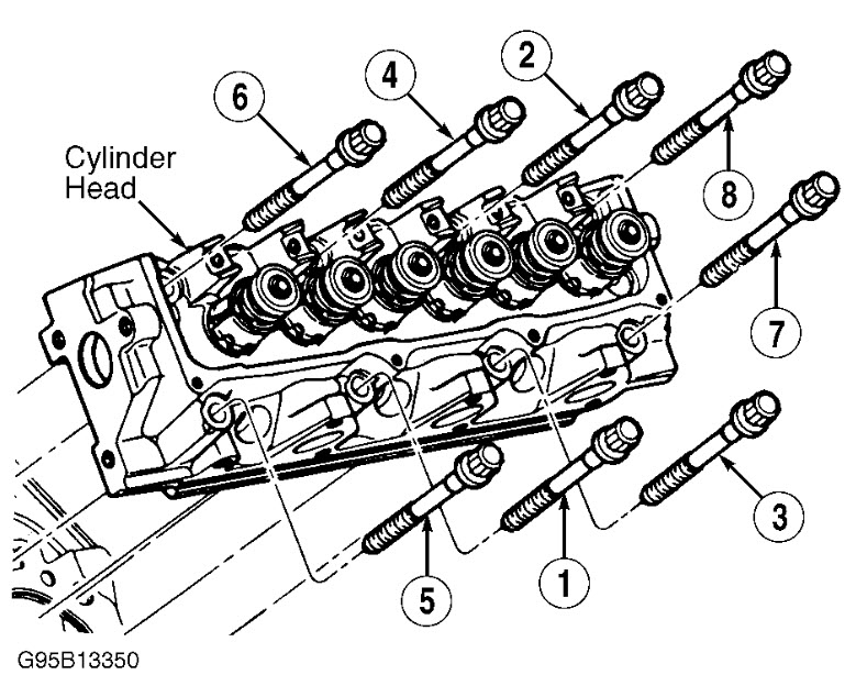

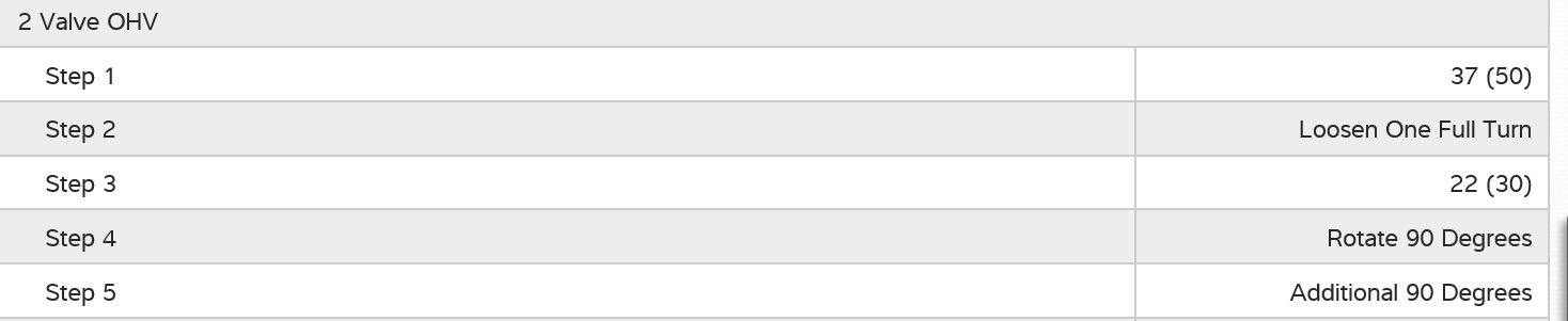

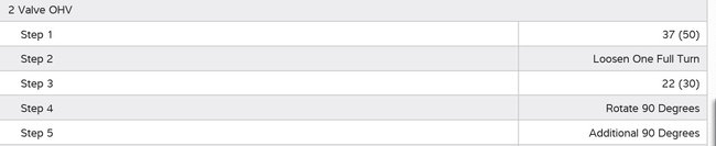

What about the head bolts Sequence, I don't understand that first image, why is step 1 tighter than step 3?
Mar 29, 2016 at 9:59 AM
HMAC300
  • 48,601 POSTS
step one puts initial torque to gasket not final
Mar 29, 2016 at 12:17 PM

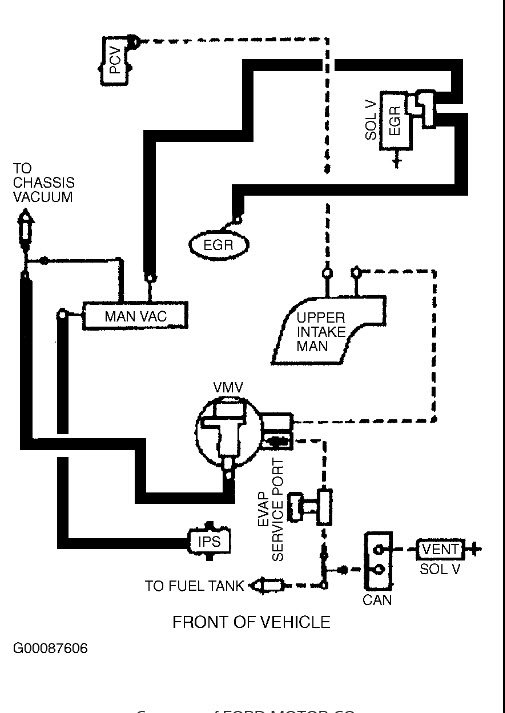

Thanks, also the EGR pipe that runs to the exhaust manifold, it appears to have two hoses coming off of it (actually one is missing and the other is on it but is not hooked up to anything, was like that when I got the car), where do those hoses run to?
Mar 31, 2016 at 7:00 AM
HMAC300
  • 48,601 POSTS
you need a ford manual for that we don't show that stuff here is vacuum diagram
Mar 31, 2016 at 7:08 AM
MCASDORPH
  • 30 POSTS
Actually I just found a illustration on it, those two from the EGR Tube run to the Delta Pressure Feedback EGR apparently.. That should be everything I need, Thanks for the help
