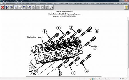

1993 Mercury Sable 6 cyl Front Wheel Drive 81000 miles
how much do you tighten you heads bolts down with a torch wrench?
Wednesday, July 9th, 2008 AT 9:17 PM
MERLIN2021
MECHANIC
17,250 POSTS
Step 1 59, step 2 loosen one full turn, step 3 37, step 4 68 these are Ft LBS 3
