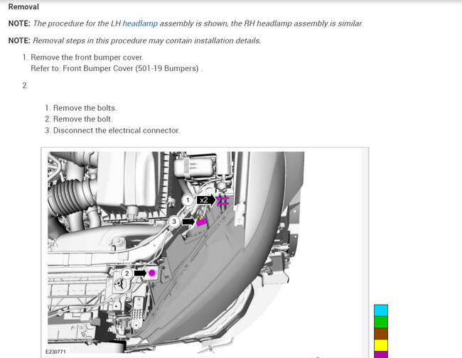

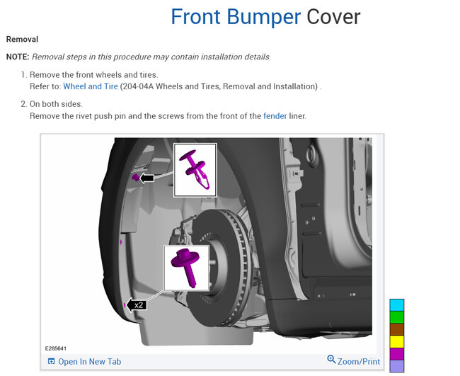

Need a diagram please.
Apr 17, 2023 at 8:10 AM
AL514
  • 5,668 POSTS

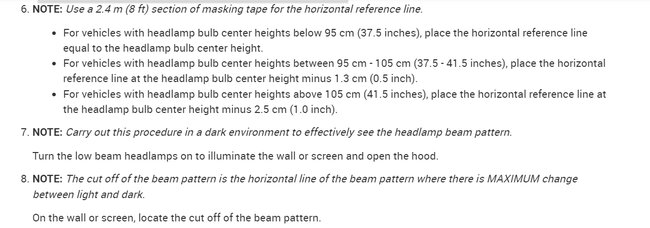

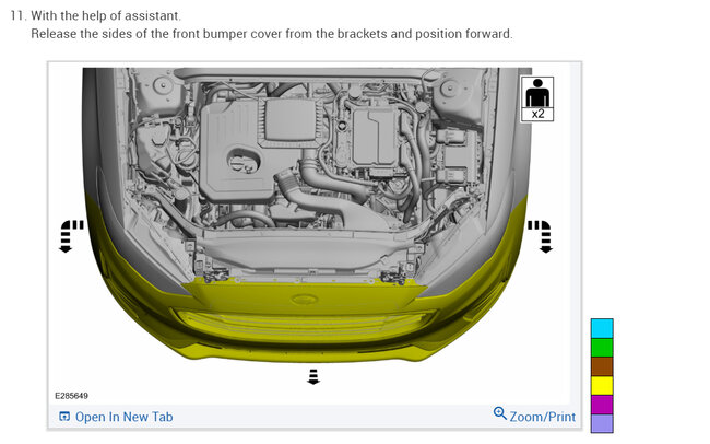

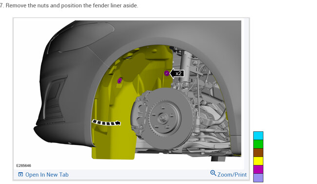

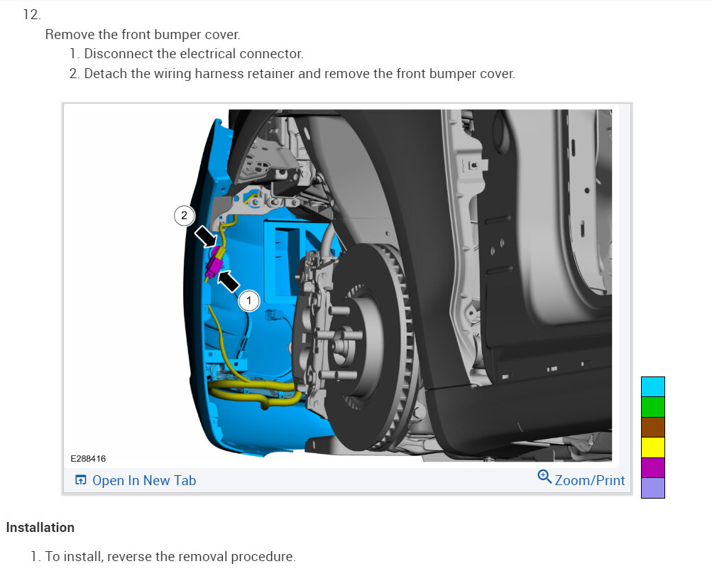

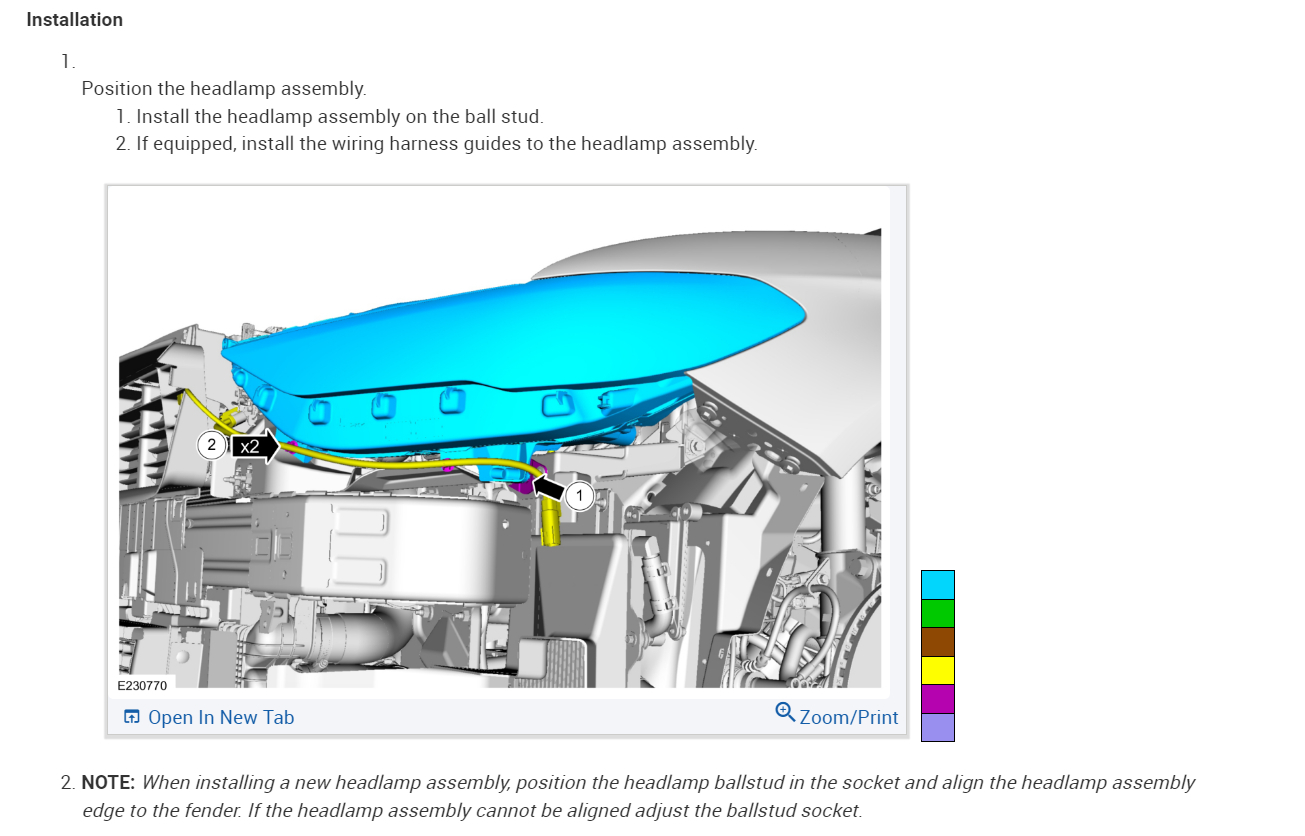

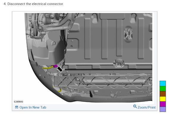

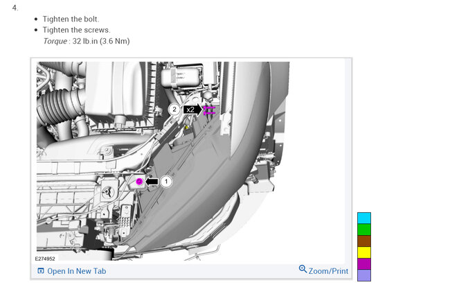

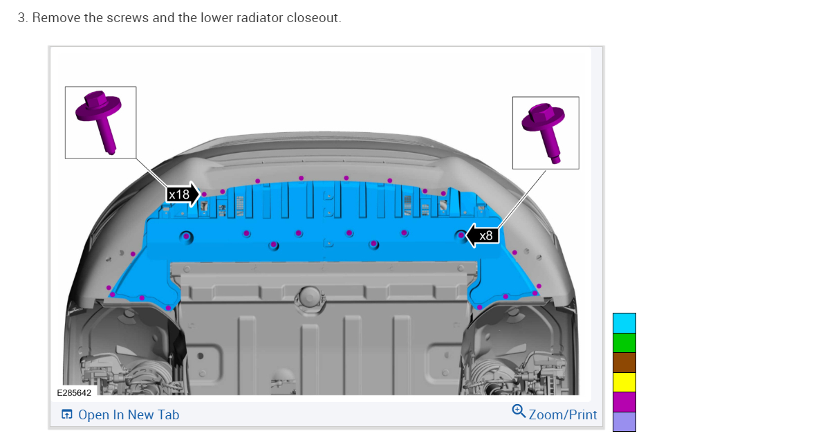

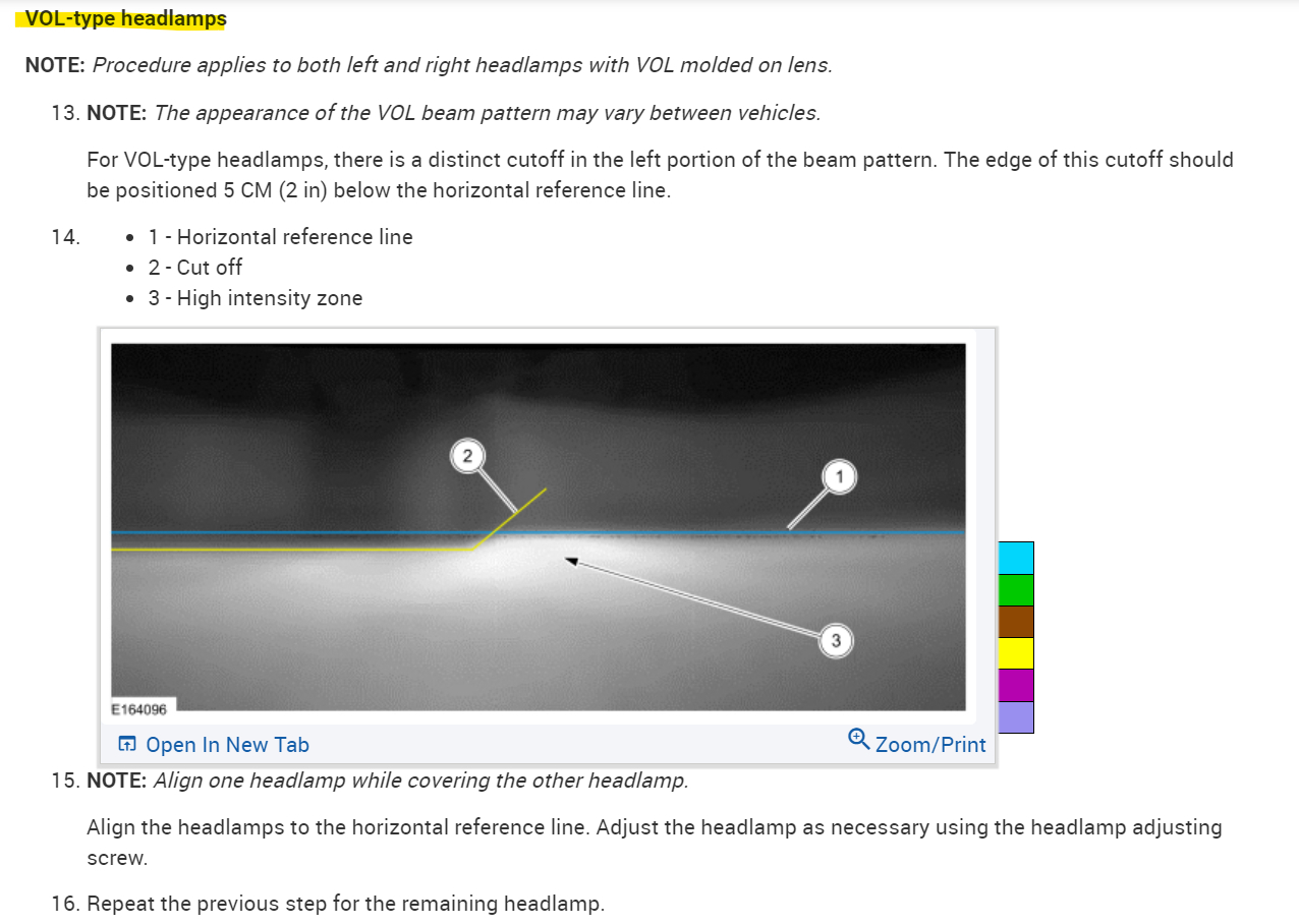

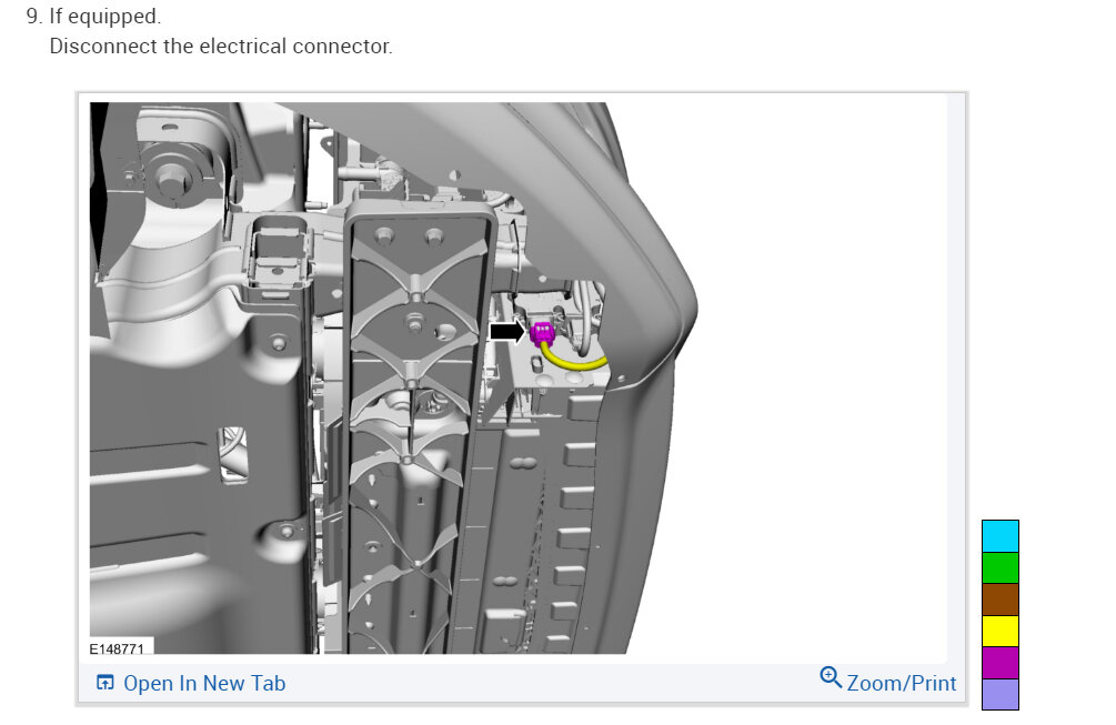

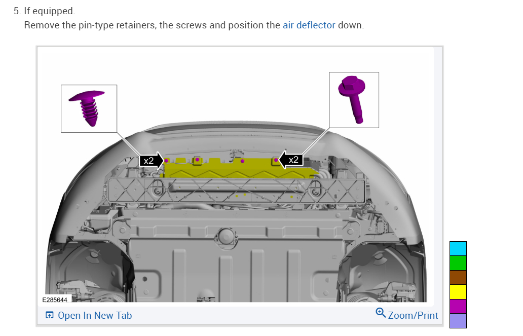

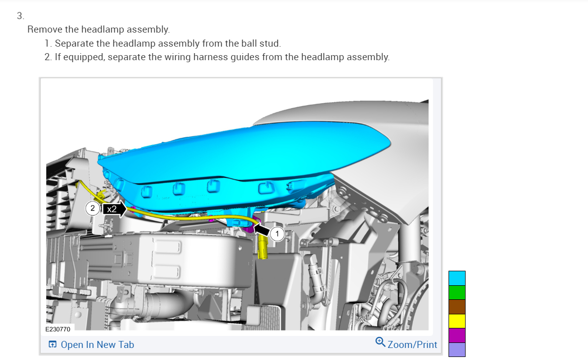

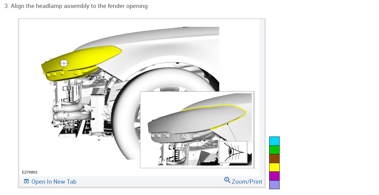

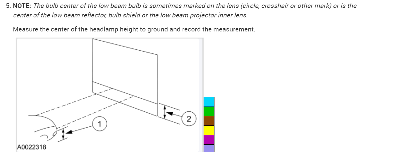

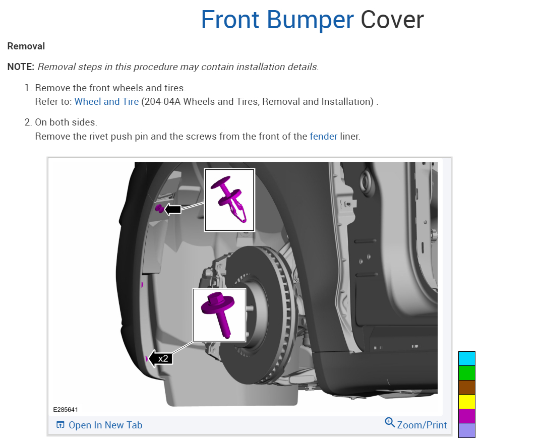

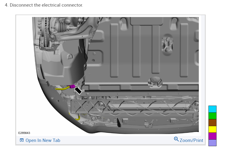

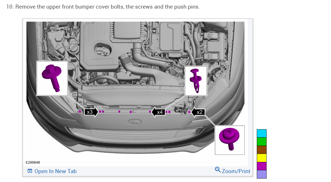

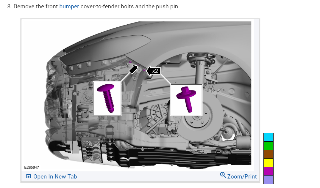

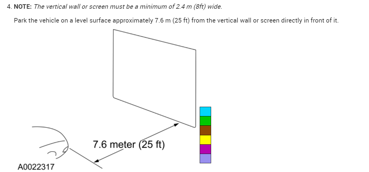

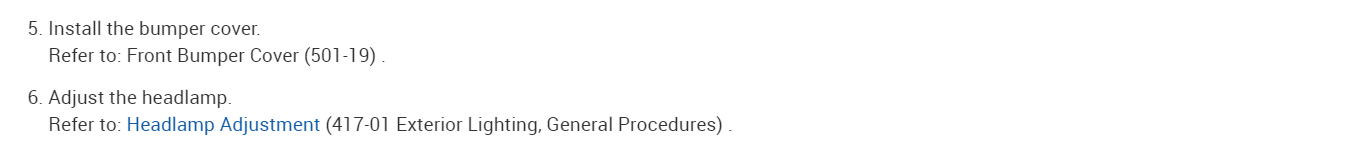

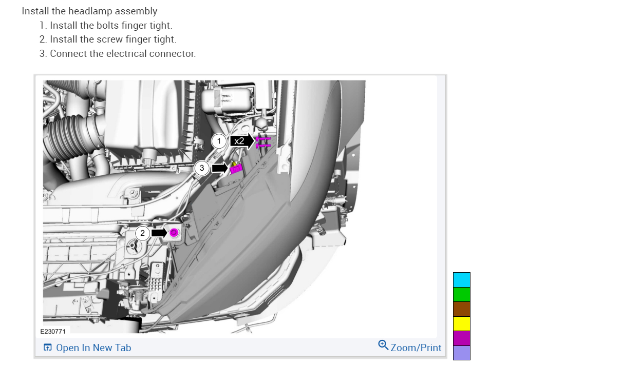

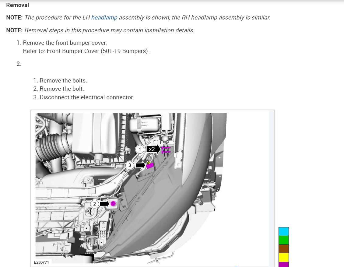

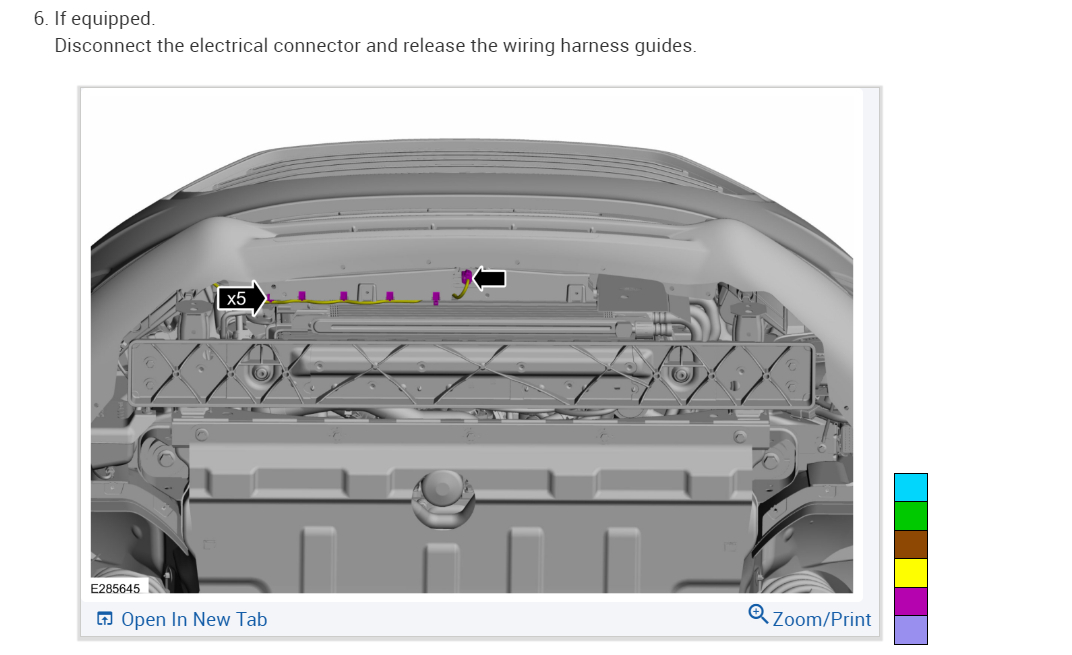

Hello, these are the steps for removing and installing the headlamp assembly, I will still have to pull up the Bumper cover removal steps and the Aligning the Headlamp steps.

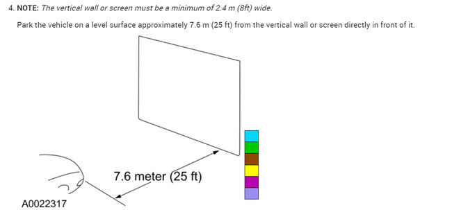

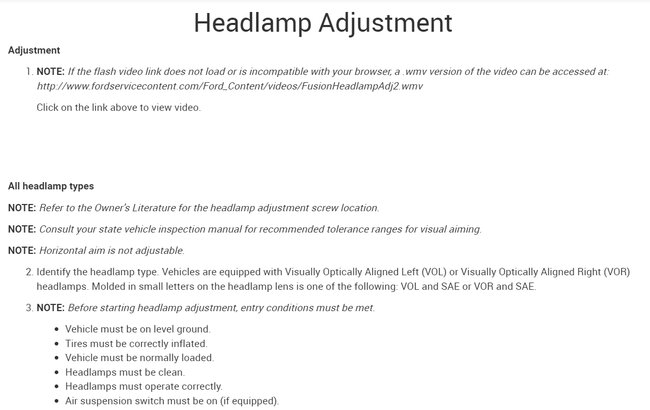

Diagrams 8 to 18 are for the front bumper removal. And I will post the Headlamp Adjustment instructions shortly. It looks like there is a video shortcut from Ford for this, so hopefully the shortcut is still valid

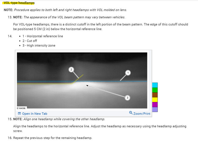

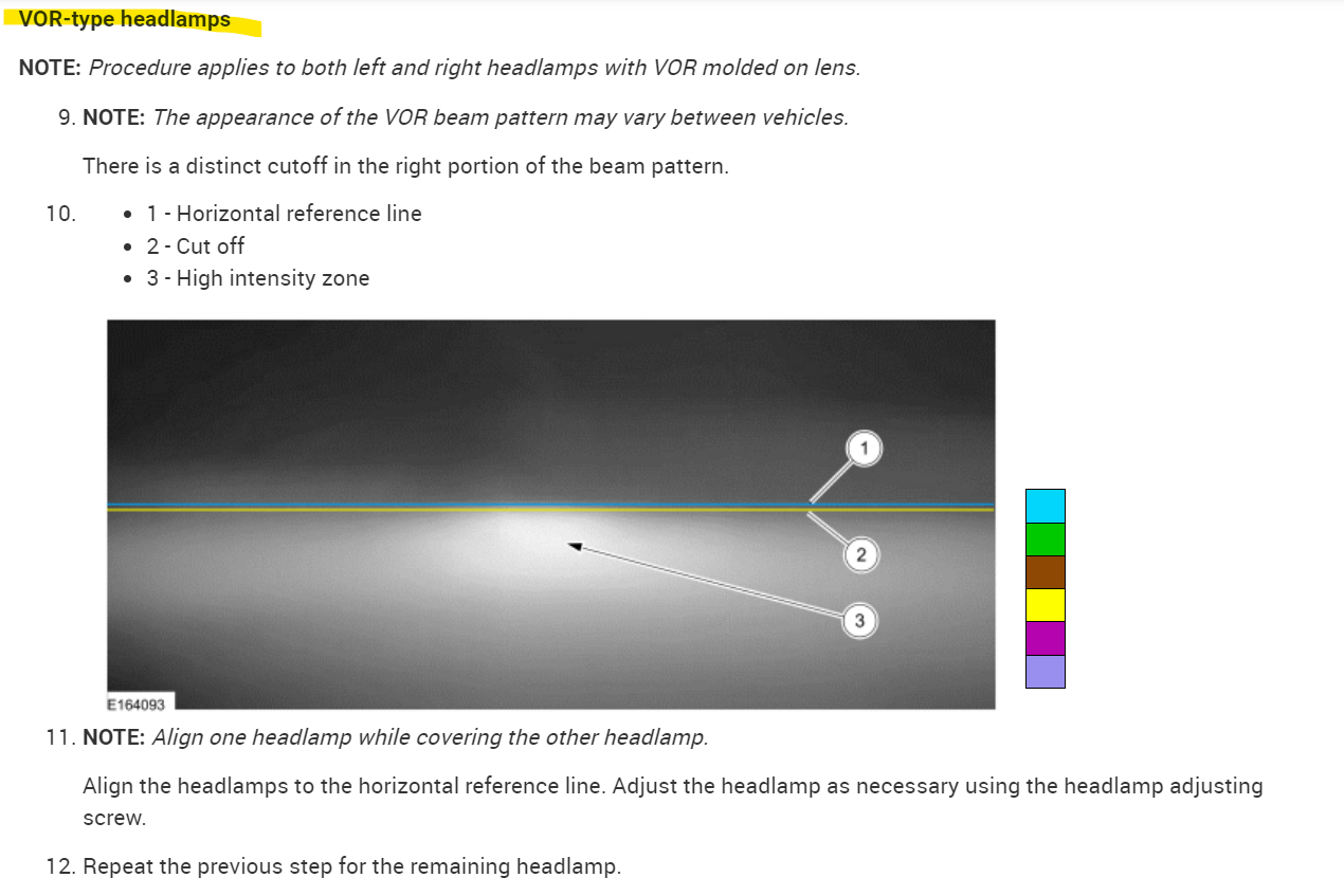

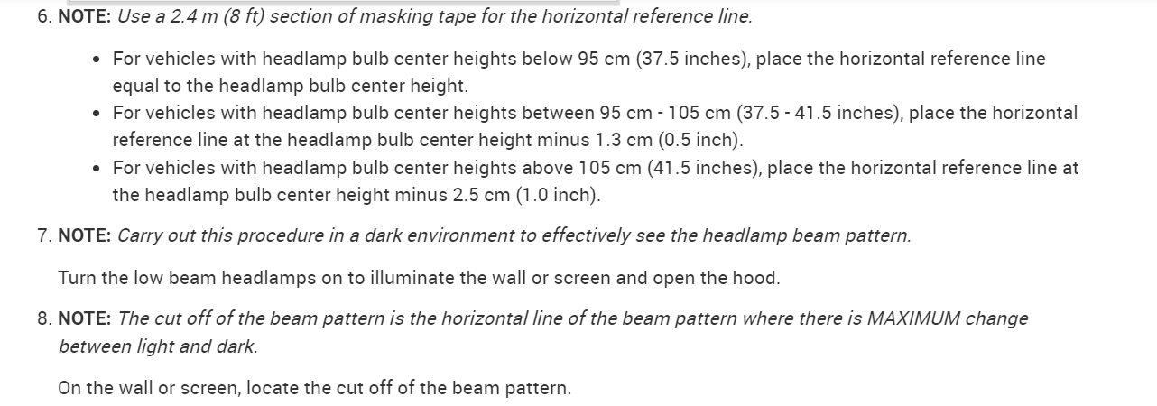

Diagrams 19 to 22,23,24 are for Headlamp Adjustment. The Ford video Link is below. It leads to a video download. I just tried the link, so it is still active. But on diagrams 23 and 24 service info mentions VOR and VOL headlamp assemblies. They appear to be different types of molded lens for each.
http://www.fordservicecontent.com/Ford_Content/videos/FusionHeadlampAdj2.wmv
