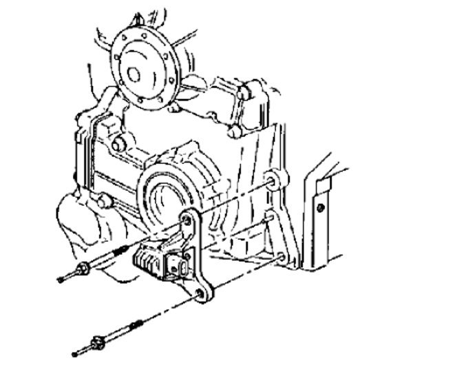

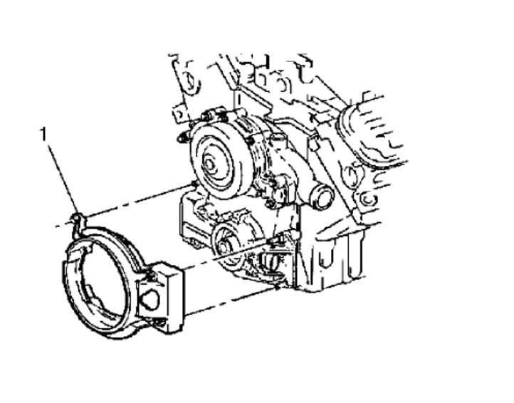

Also, I Want to know where a puff of smoke came from Couple of times when I was Cranking the Engine for a long time, Maybe that'll help Me in figuring this out... The smoke came from Behind the Engine, what is around/Back there that can Produce smoke?
Seems a typical place where the car catches fire from..

It sounds like you have a crankshaft angle sensor that has gone bad. Here is a guide that will show you what you are in for when changing the sensor out.
and some diagrams on what it will be like on your car. (below)
