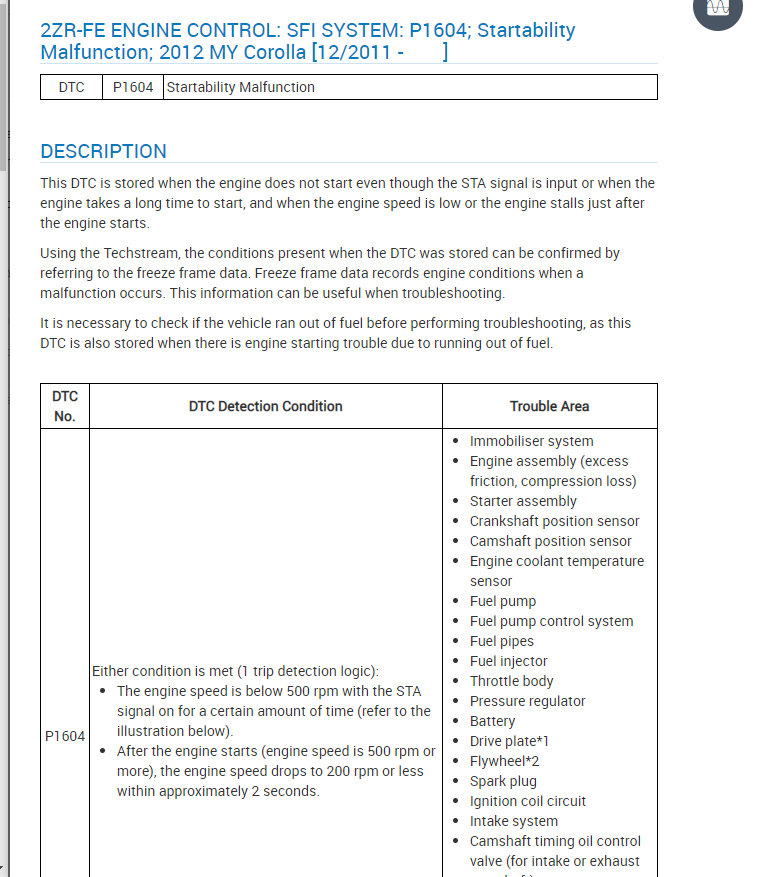

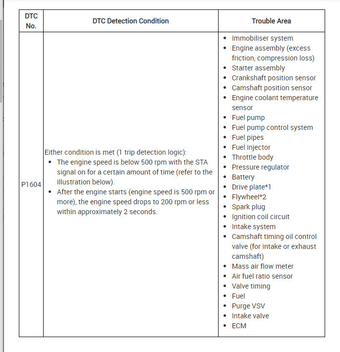

This code is just telling you the engine did not start when you tried to start it or it started and then stalled. Usually we already know that since the engine didn't start. :)

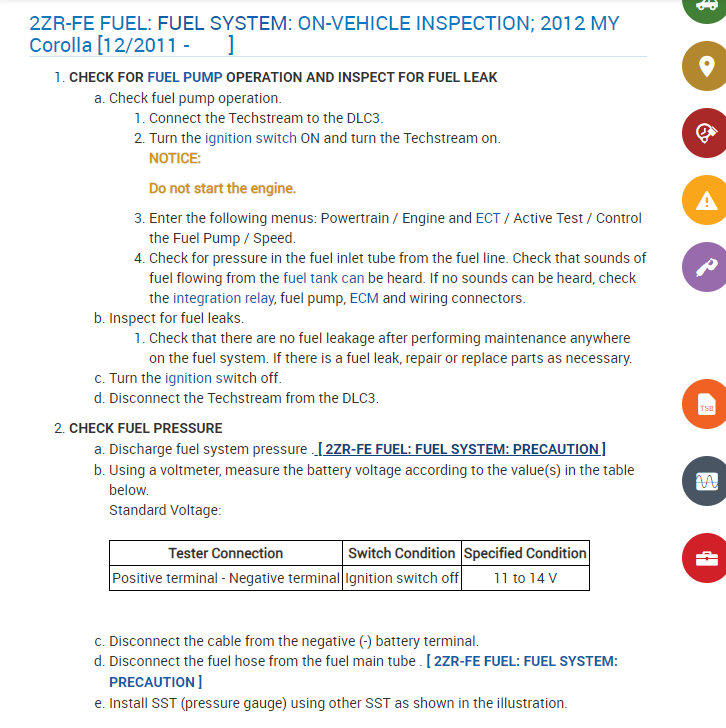

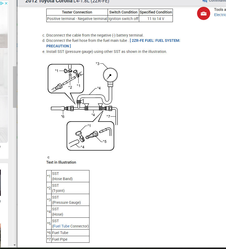

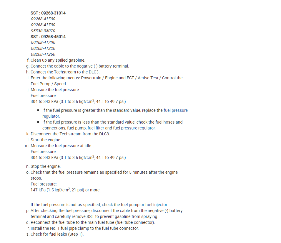

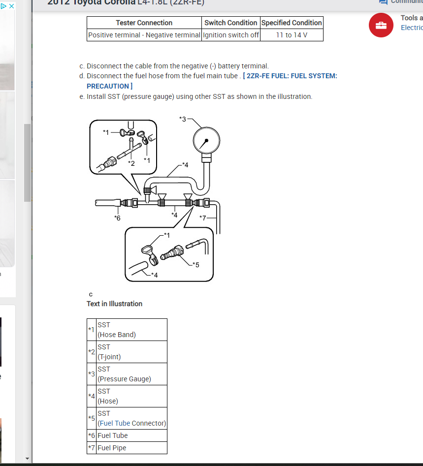

However, they give a lot of different tests to try and diagnose this code but I suspect the advice you got was correct. So let's start with the fuel pump by checking pressure.
Here is a guide that will help with this:
I am attaching the info below of the code and how to check fuel pressure on this vehicle. This is one where it does not have a Schrader valve so you need to remove a line and splice in the gauge.
You will see on the info on the code that the fuel system is one of the causes and the fact that the engine does start and run after a few tries points to the fact that this is a pressure related issue.
Please run through this info and let us know what you find with this and we can go from there.
