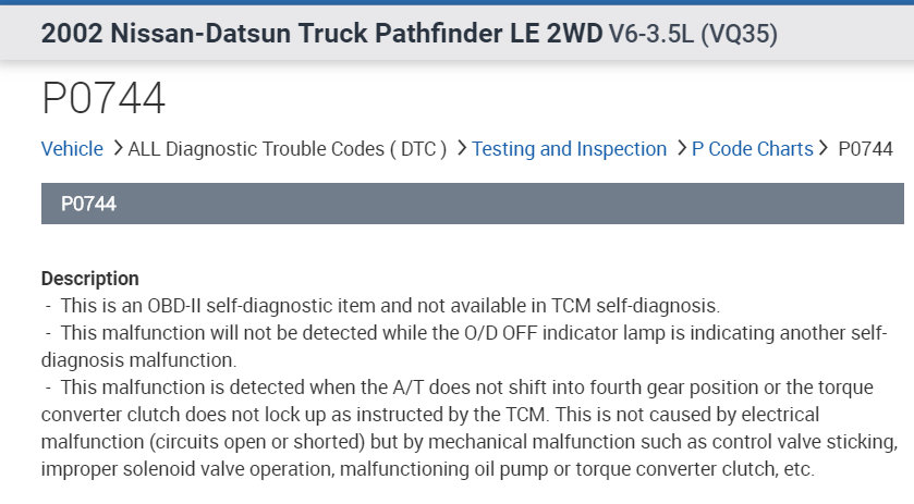

It's throwing code p0744 as well. what could that be?

Anyway DTC P0744 is in association with the transmission TCC Solenoid. I have included a description of it in the diagrams down below.
