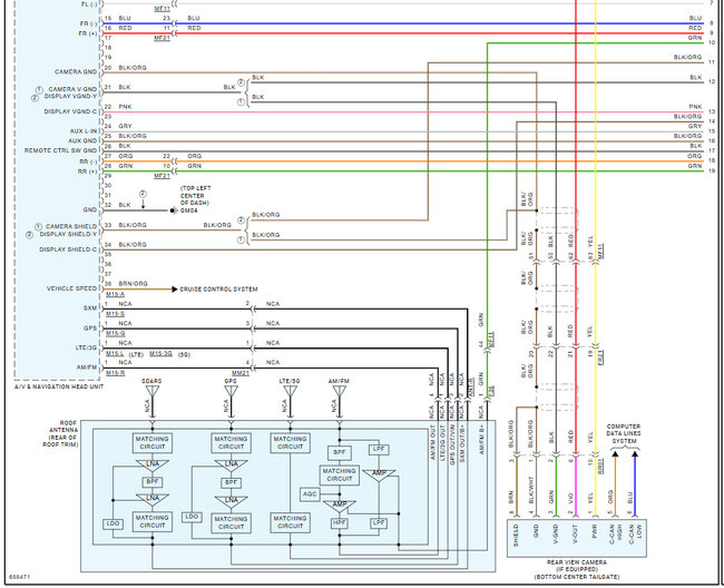

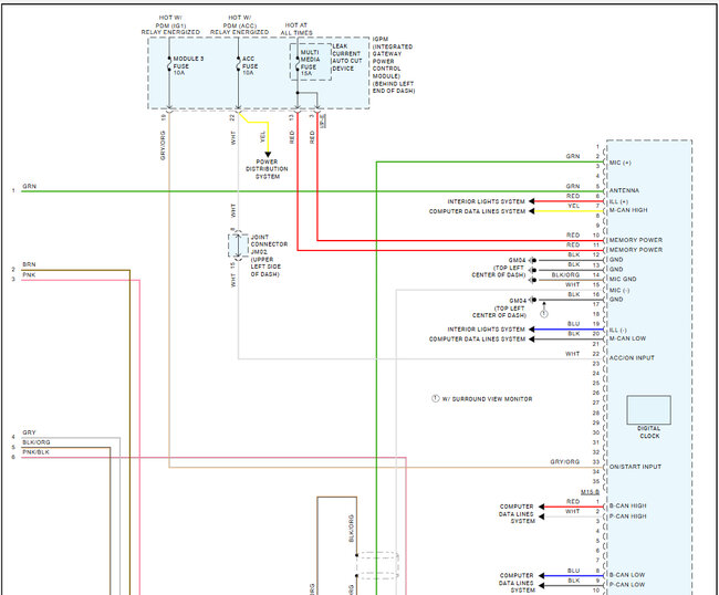

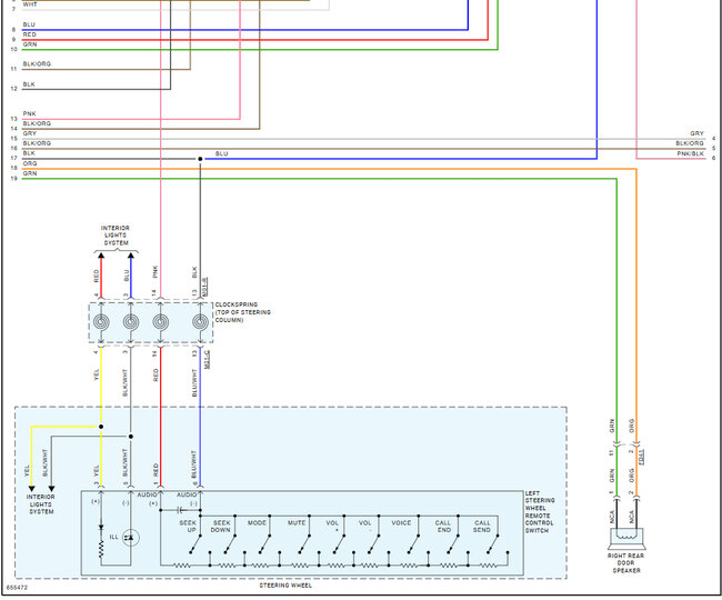

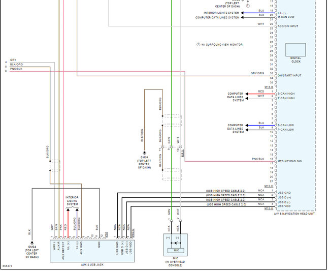

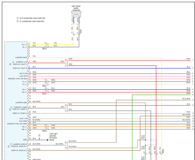

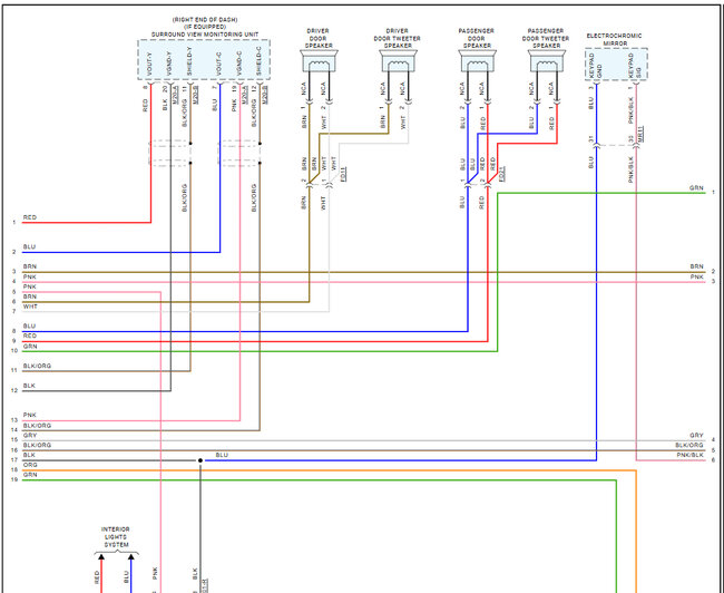

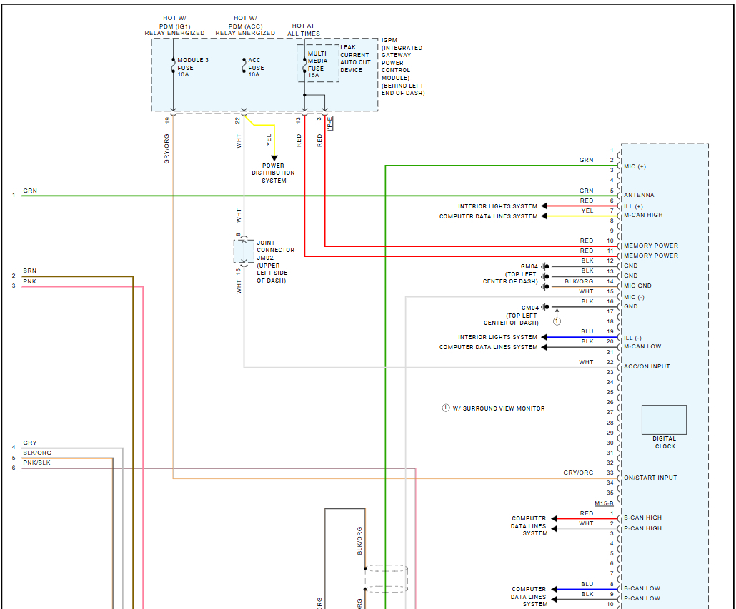

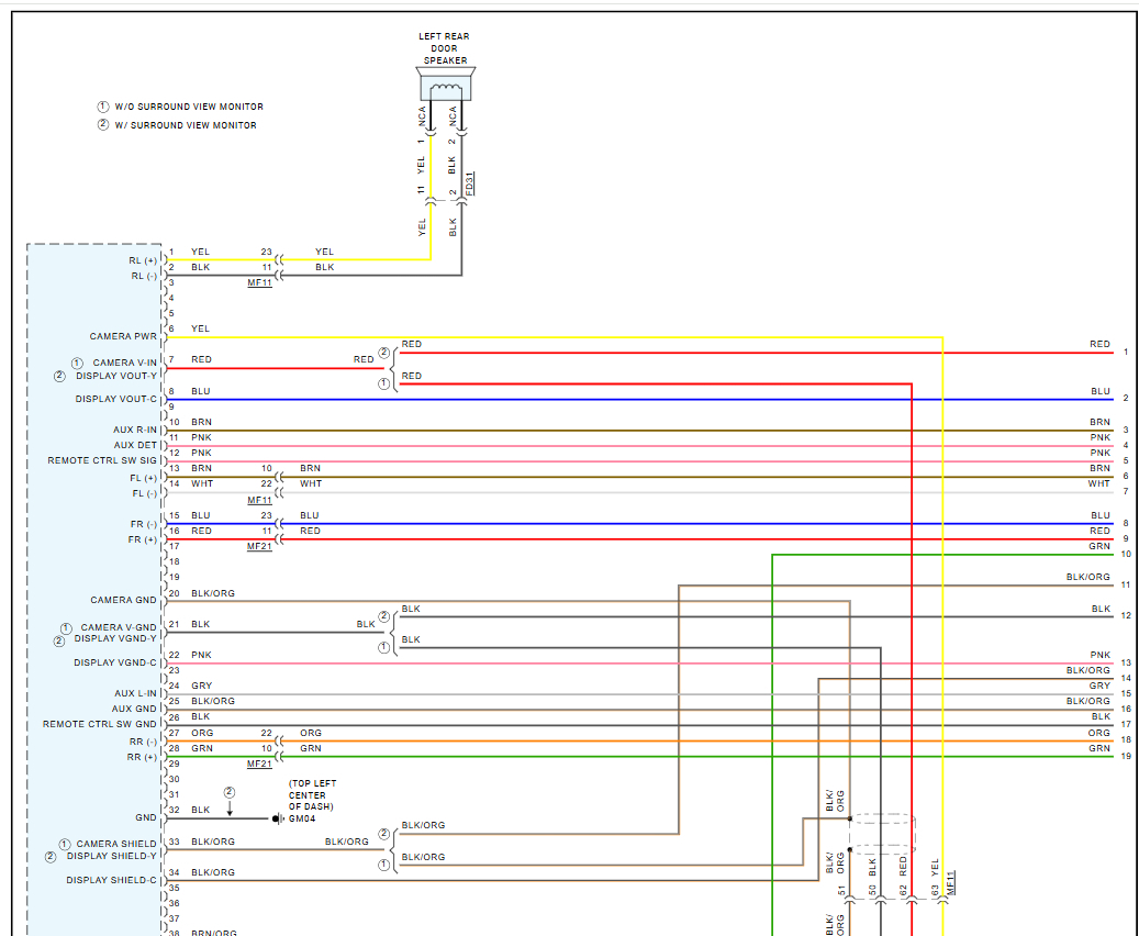

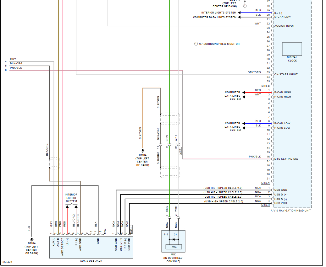

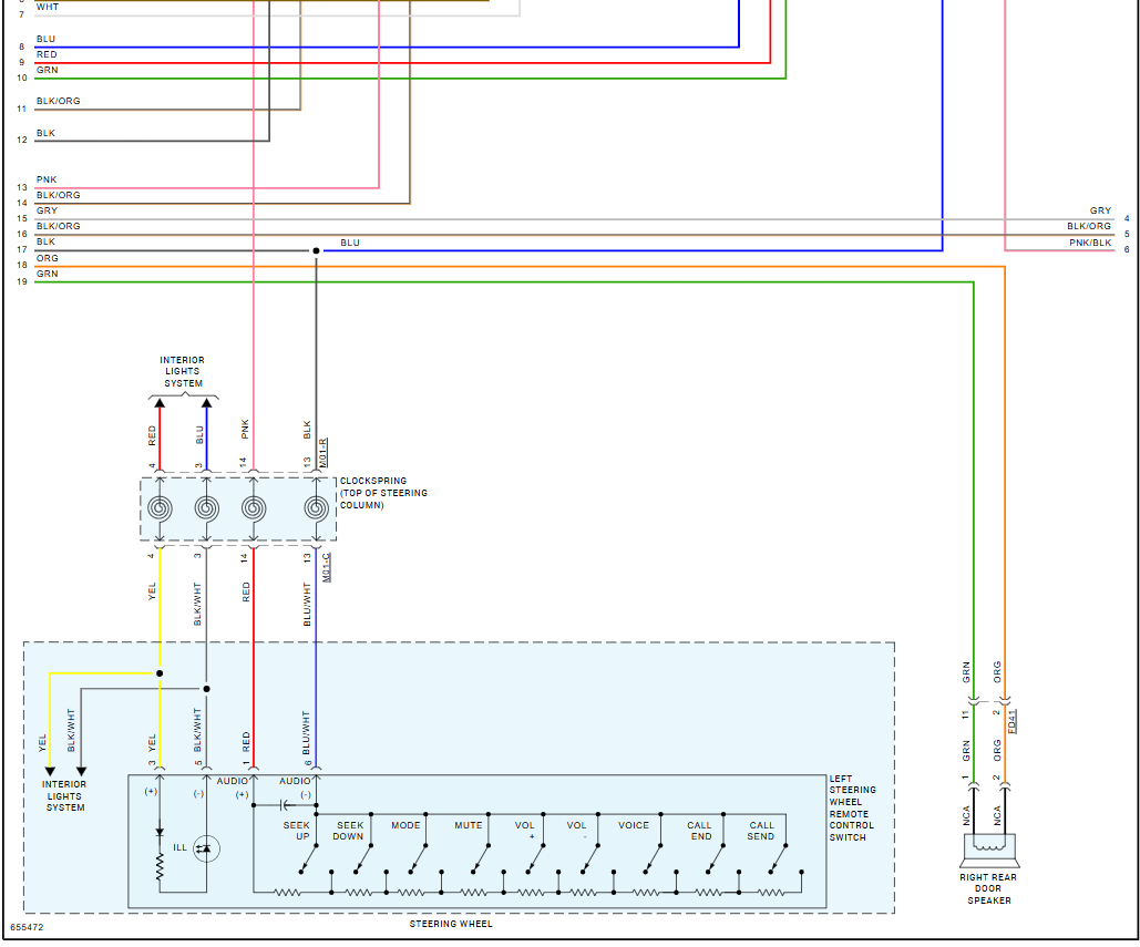

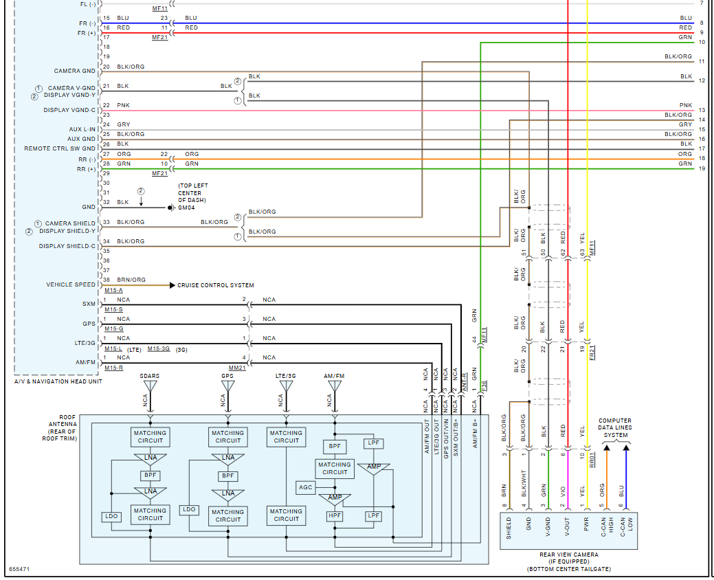

I am looking to find the vehicle reverse + signal for install of an aftermarket stereo.
I was looking for the pinout of the factory radio to see if it was in that harness.
If not, I need the location of the reverse signal + that I can tap into.

No Pinouts, only the radio wiring diagrams is all we have for this car. Check out the images (below). Let us know if you need anything else.
