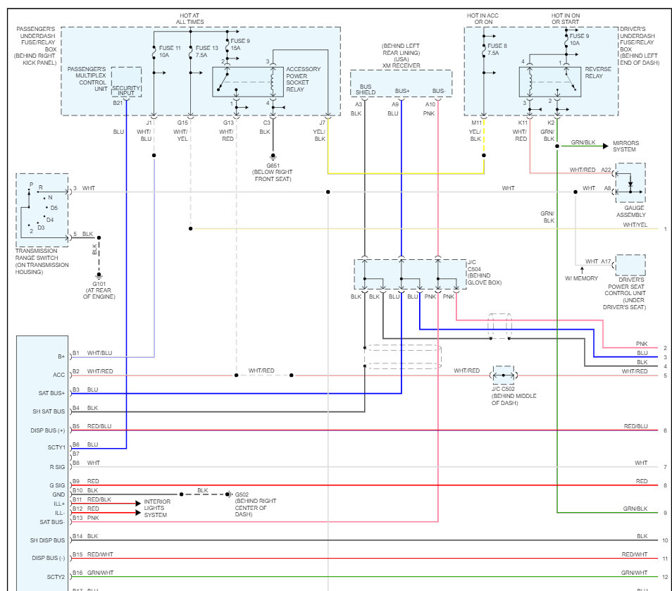

I purchased the vehicle listed above early this summer with a navigation screen that didn't work. I bought a used navigation system to replace the screen. It's the screen, stereo, and navigation all in one. It all worked except the screen. The screen doesn't work in the one I just purchased either. What I want to know is can I just replace screen?
Nov 6, 2023 at 10:01 PM
  • 55,222 POSTS

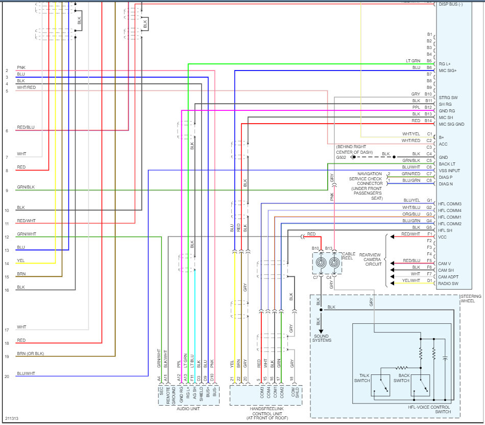

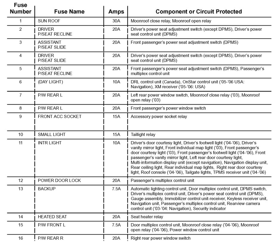

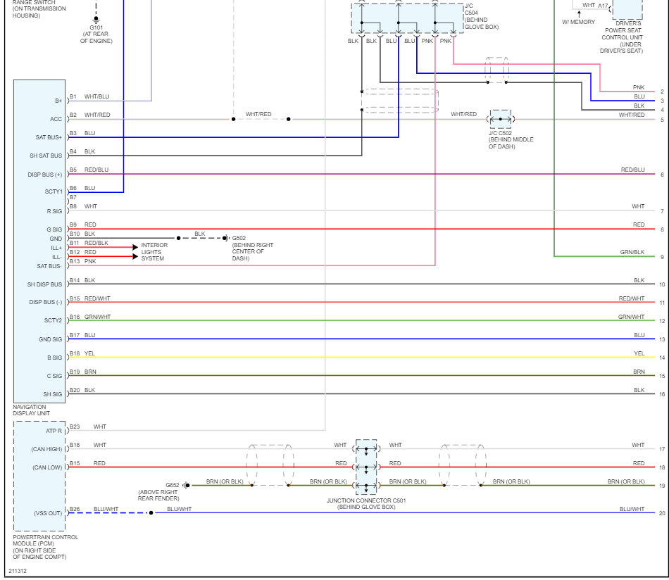

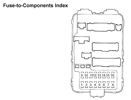

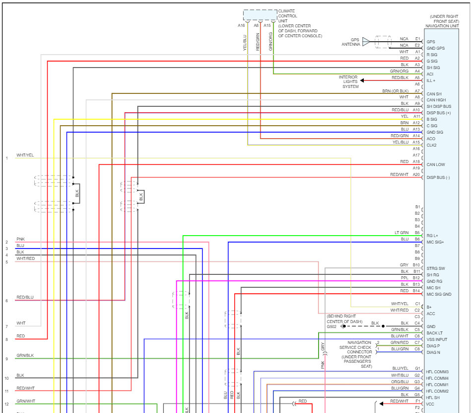

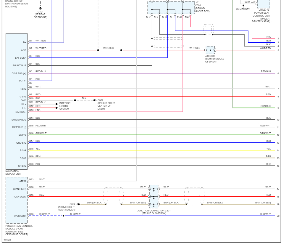

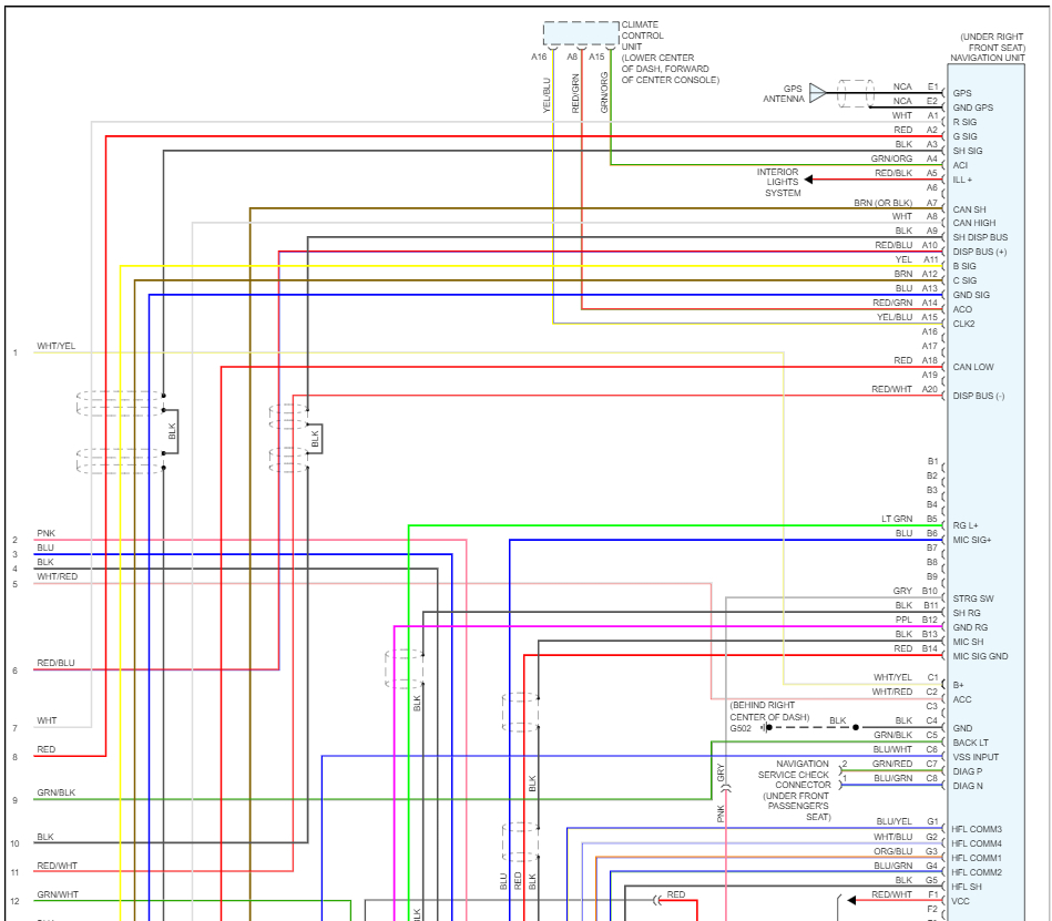

The fact that both units don't have the screen tells us the screen might not be the problem. I would test the fuse #11 and fuse #13 in the fuse panel on the passenger's side behind the kick panel. here is a guide to help and I have included the navigation wiring diagrams so you can see how the system works:
Here is the fuse location as well. Check out the images (below). Please let us know what happens.

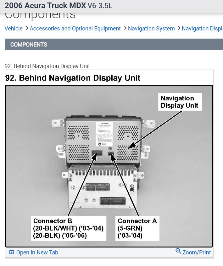

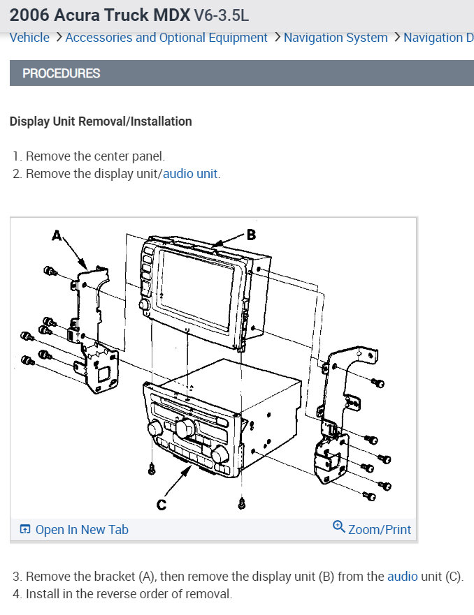

Okay, it sounds like you a bad replacement Navigation unit. What happens is the display driver overheats and goes out, which is common. Here are the instructions on how to change the nav unit out. Check out the images below. Let us know if you need anything else, please.
