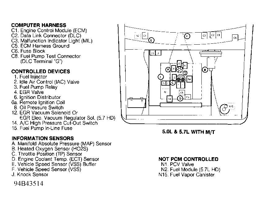

Ok. You can try this. Ive done research and found a technical service bulletin that describes all the symptoms you describe. It says to unplug, inspect, and replug the ECM plugs. They have levers on them that must click when properly closed. No kidding. If that yields no result im leaning towards the catalytic converter starting to come apart. I say that only because you said the truck "acts" like its getting gas then takes off. Let me know what you find

Thank you very much for your time given to try and answer my question. I am sorry but I cant seem to find out what you are referring to as ECM plug; I thought that had something to do with the firing of a diesel engine but obviously no mechanic so duno.
Where will I find the emc plugs to inspect?

Heres a diagram. Pics worth a thousand words
