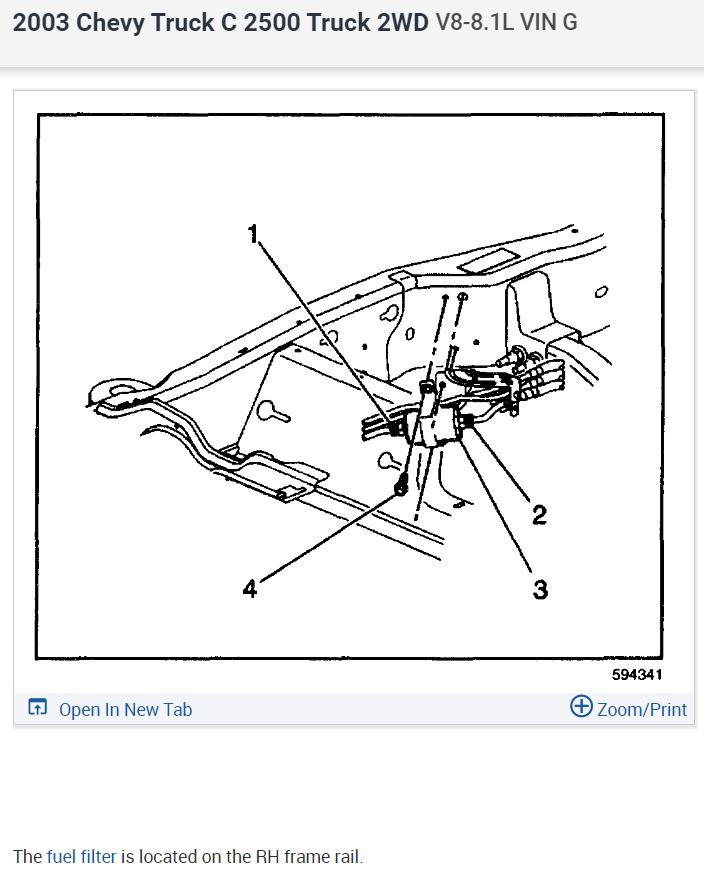

So, I just bought this truck and when you go to crank the truck and turn the key to the run position it’s trying to crank and takes like 6 or 7 tries before it starts. I have taken the ignition switch out to illuminate the ignition lock and it still does it. I have tried putting it in neutral and it will work how it’s supposed to, but you can’t turn it to the start position. Would you maybe have a solution on things to check? The previous owner said he changed the ignition housing and that’s when it apparently started doing it. Please help. I don’t want to burn my starter up.
Apr 2, 2024 at 9:42 AM
  • 55,224 POSTS

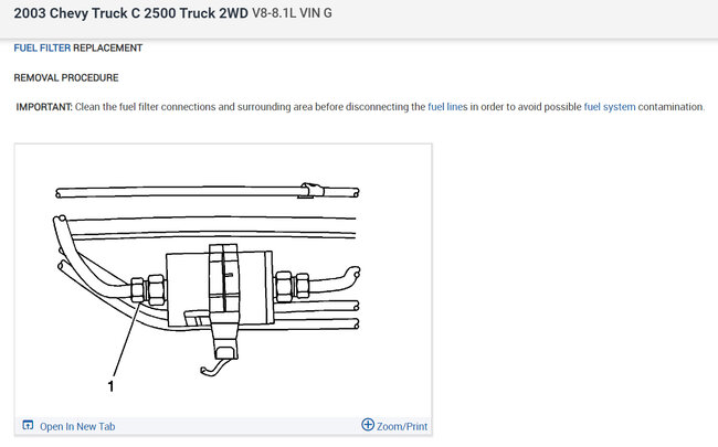

It sounds like the fuel pump might be getting weak, but I would change out the fuel filter first to see if that makes a difference. Here are two guides that can help with instructions and the location of the fuel filter for your truck in the images below:
https://www.2carpros.com/articles/how-to-change-a-fuel-filter
This guide can help as well:
https://www.2carpros.com/articles/engine-cranks-excessively-before-starting
Check out the images (below). Please upload pictures or videos in your response to the problem so we can see what's going on.
