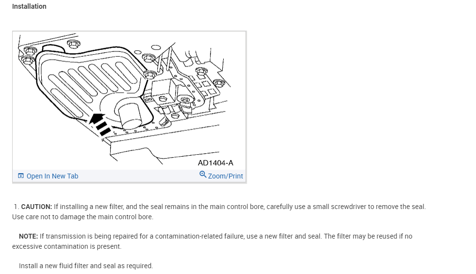

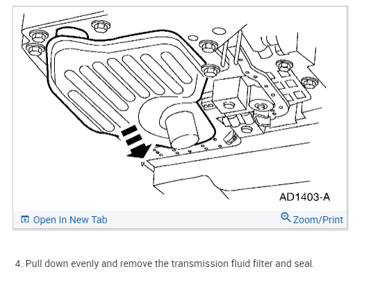

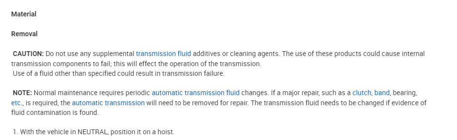

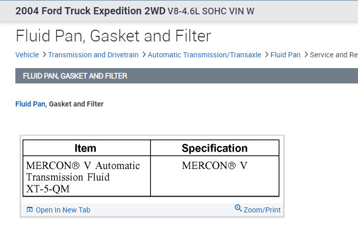

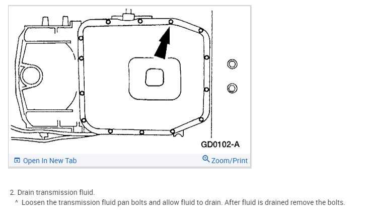

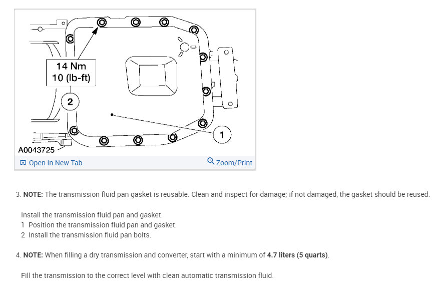

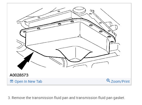

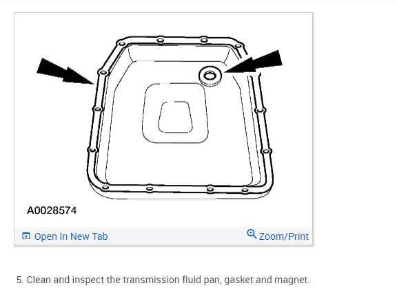

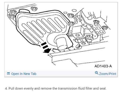

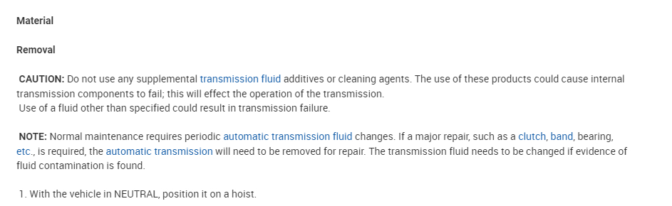

If it is black/brown and smells burnt, the next thing to do would be the removal of the transmission pan to inspect if there are indications of metal shavings, excessive clutch material, and so on. Also, you will be able to see the filter for inspections as well.
I attached the directions below to access the filter. If you remove the pan and see debris, take a few pictures of it and upload them for me to see before cleaning.
Let me know what you find.

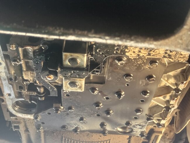

PATRICK ATKINS
  • 14 POSTS
This some.
Apr 21, 2023 at 6:30 PM
  • 110,244 POSTS

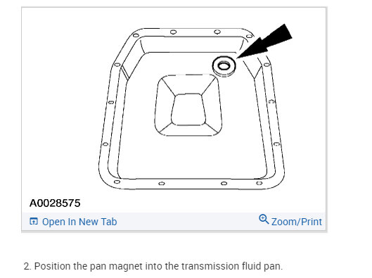

By chance, do you have a pic of the pan itself especially where the magnet sits in it? Did you notice any metal shavings in the pan? Also, looking at your pic, I see places where it appears to be dark color dirt build up. Am I correct? If so, I have a feeling that is clutch material.

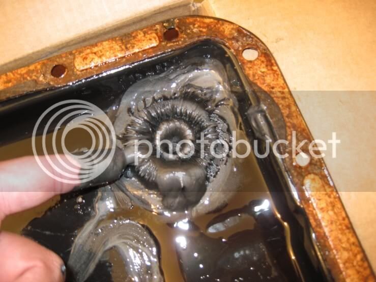

PATRICK ATKINS
  • 14 POSTS

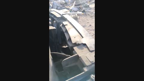

It kind of look like this.
Apr 22, 2023 at 12:57 PM
  • 110,244 POSTS
Is that from your vehicle? That is a mess. If that is clutch material, I feel it likely needs to be rebuilt.

PATRICK ATKINS
  • 14 POSTS
No, that is not my car.

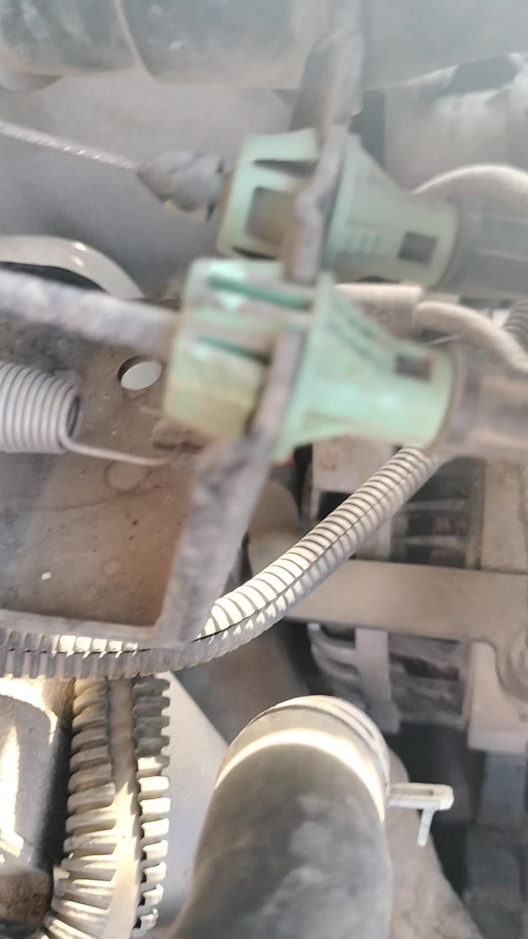

When I start my car it sounds like a little bad.
Apr 22, 2023 at 11:55 PM
  • 110,244 POSTS
I'm glad to know that pic wasn't from your vehicle. LOL When you say something sounds bad when started, how would you best describe it? Also, is it loud enough for you to record and upload for me to hear?

But the sound is not coming from the transmission it's coming from the engine area.

Take notice if the sound is louder at the rear of the engine when the transmission is bolted to the engine. Also, see if it is louder under the vehicle or above. You can even go as far as checking it between left and right.
Apr 30, 2023 at 11:41 AM
PATRICK ATKINS
  • 14 POSTS
It louder in engine area.
May 17, 2023 at 1:13 AM
  • 110,244 POSTS
It could be related to the torque converter which is right behind the engine in the transmission bell housing.
Don't laugh, but if you can, pick up an automotive stethoscope. Most parts stores have them for around five dollars. Use that to see if you can locate the source. Check the bell housing area to see if that is where it is loudest.
