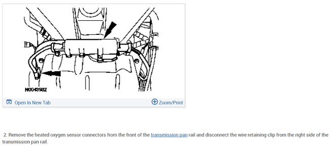

My transmission makes a railing noise when it starts running and shifts into 3 shifts then it runs fine.
Jan 23, 2024 at 6:50 AM
  • 55,224 POSTS

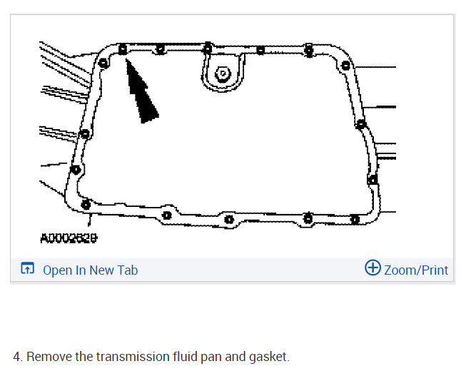

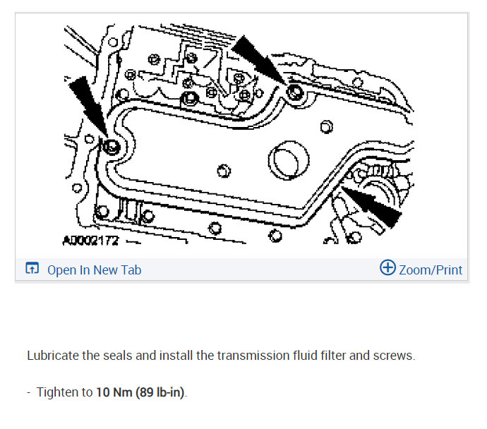

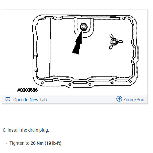

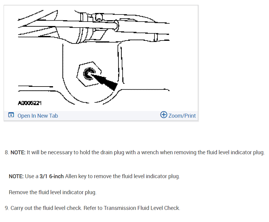

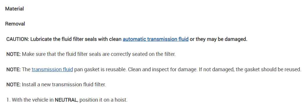

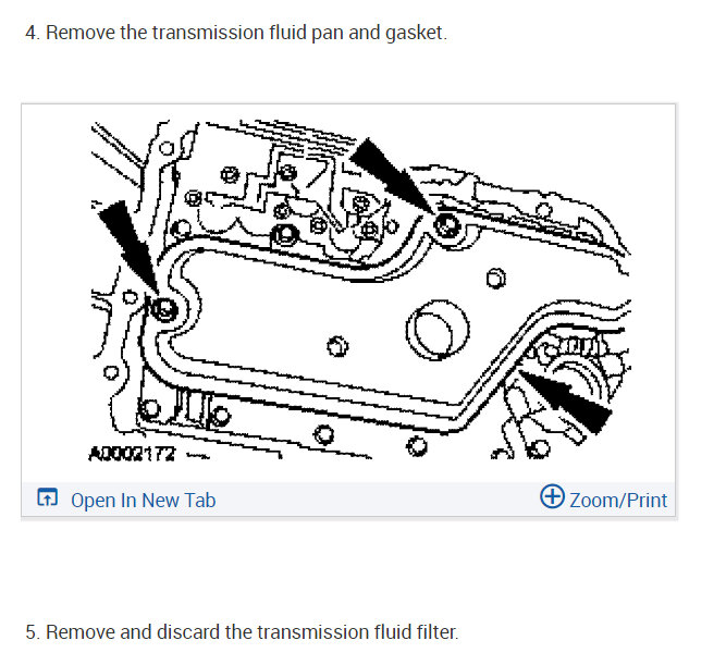

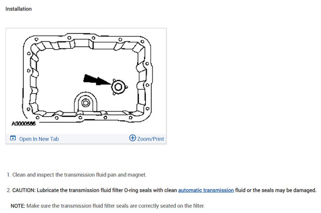

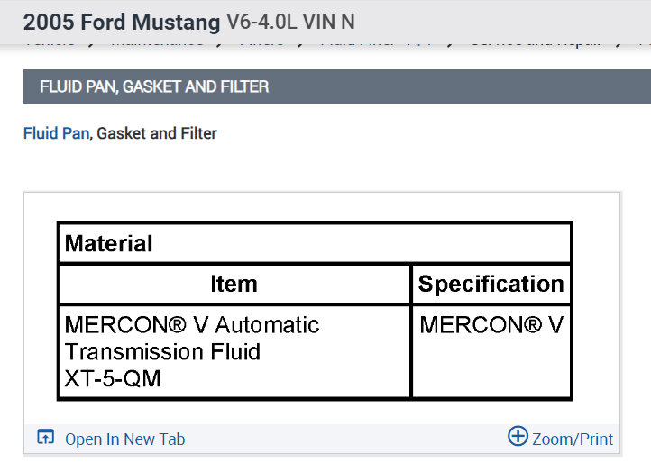

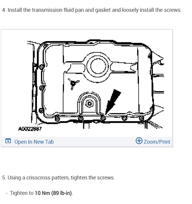

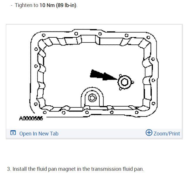

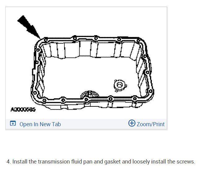

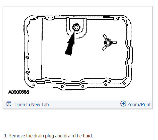

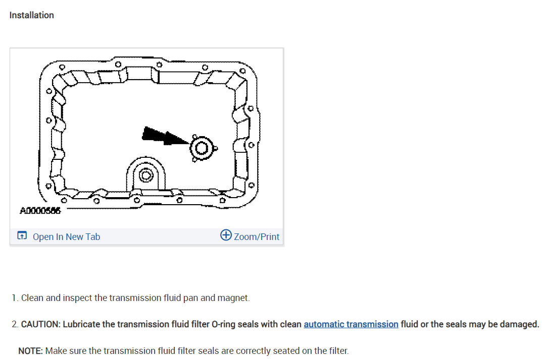

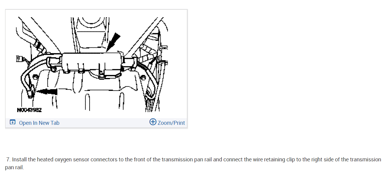

That is a bummer, you might want to try changing the fluid and filter, but it sounds like you have a planetary gear set that is bad inside the transmission, and it will need to be rebuilt. To be sure, can you please upload a short video of the car making the noise? This guide can help, and I have included instructions in the images below for your car.
Also, while the pan is off you can look for metal which is a sign the transmission is hurt internally.
here is a video of a transmission removal in a similar car:
https://youtu.be/3vJAojsrfuU?si=0DJ1A-hB9VPEvfZn
Check out the images (below). Please upload pictures or videos in your response to the problem so we can see what's going on.
