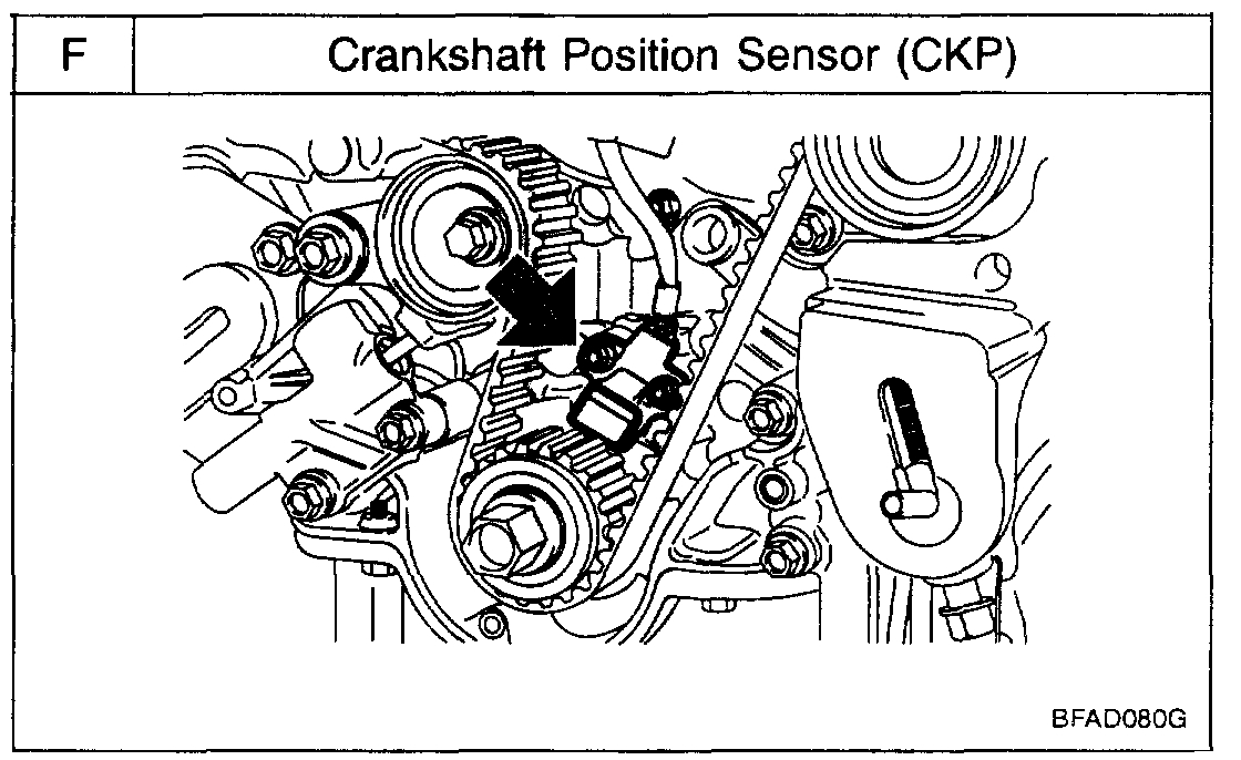

My vehicle does crank and starts, but if turn off i will not start again until it has cooled off.

Based on your description, it sounds like you may have a bad crankshaft position sensor. Take a look through this link and see if it mirrors your vehicle's symptoms.
If you feel that is the issue, here is a link that shows in general how one is replaced:
Now, this sensor is a tough one to access. With that, we need to be sure it is the problem. Here is what I suggest. You will need to get what is called a live data scanner. What needs to be done is this. Connect the scanner and go to live data. Find engine RPM. Once you find it, crank the engine. If there is no RPM signal, the most likely suspect is the sensor I mentioned.

I attached a picture of the sensor. It is located behind the timing cover and not easy to access. That is why I recommend confirming it is the issue.
One last thought for you. On this vehicle, once the engine is running, it will continue running if the sensor fails. However, it will not restart. It is my belief that once the sensor cools off, it will work again until it gets hot. Then, when it's hot and you turn the engine off, it won't restart again until the sensor cools.
