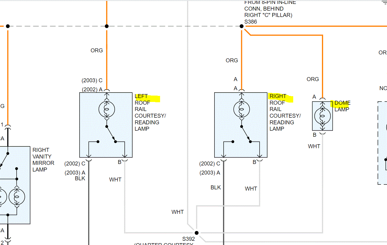

So yeah, my interior lights above each door will not go out. where and what fuse can I pull to stop that if any at all?

Is the dome light staying on as well? I ask because they are all tied together. If you look at the attached picture, it shows the wiring to these lights and the dome light are the same circuit. I did note there is a switch shown for each light. Check to see if they are bad.
Let me know. As far as a fuse, the body control module powers these.
Let me know. If that isn't the case, the next thing to do would be to remove the bulbs. Let me know if I can help.
