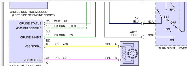

We are trying to fix cruise onthis vehicle and was wondering what chance replacing speed sensor would do the trick

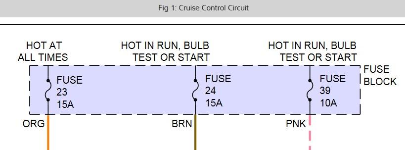

Note the cruise fuses. At the moment, I can't rule out the cruise controls on the steering wheel or the wiring in the steering column.

Sorry about that, forgot the fuses.

Thanks for your reply, I took a shot and replaced speed sensor and it changed nothing, I hesitate to replace servo, however I did see a you tube video that suggested cleaning corrosion from mechanical part of servo as a fix. I wonder if those 'piston' could freeze and then short out. The one in the video showed 3? I have also tried different switch lever, but have not changed harness for switch lever. Anyway thanks for your reply once again

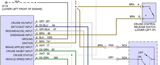

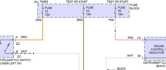

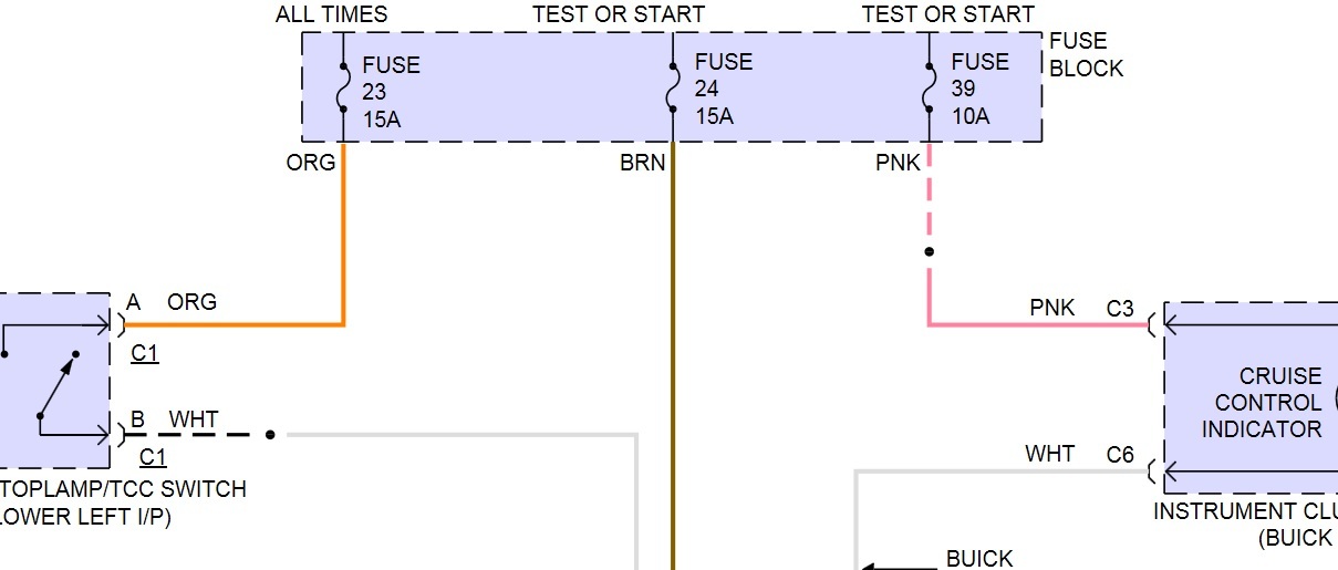

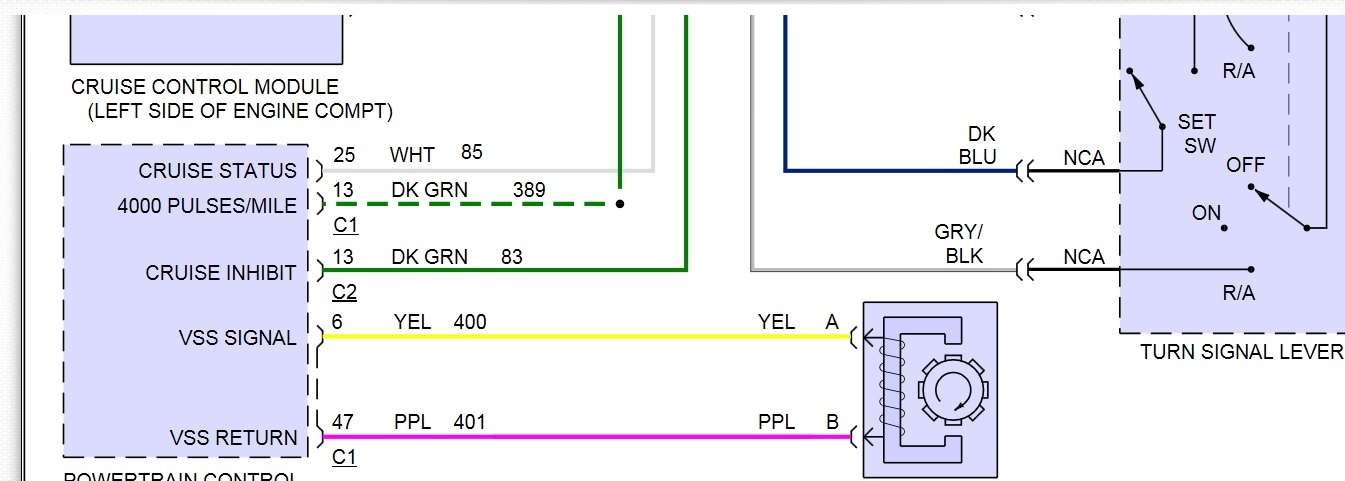

Were there any codes for the cruise control? Here is wiring diagram for cruise. Follow the wiring diagram for cruise, see if you can find a problem, voltage or ground.
