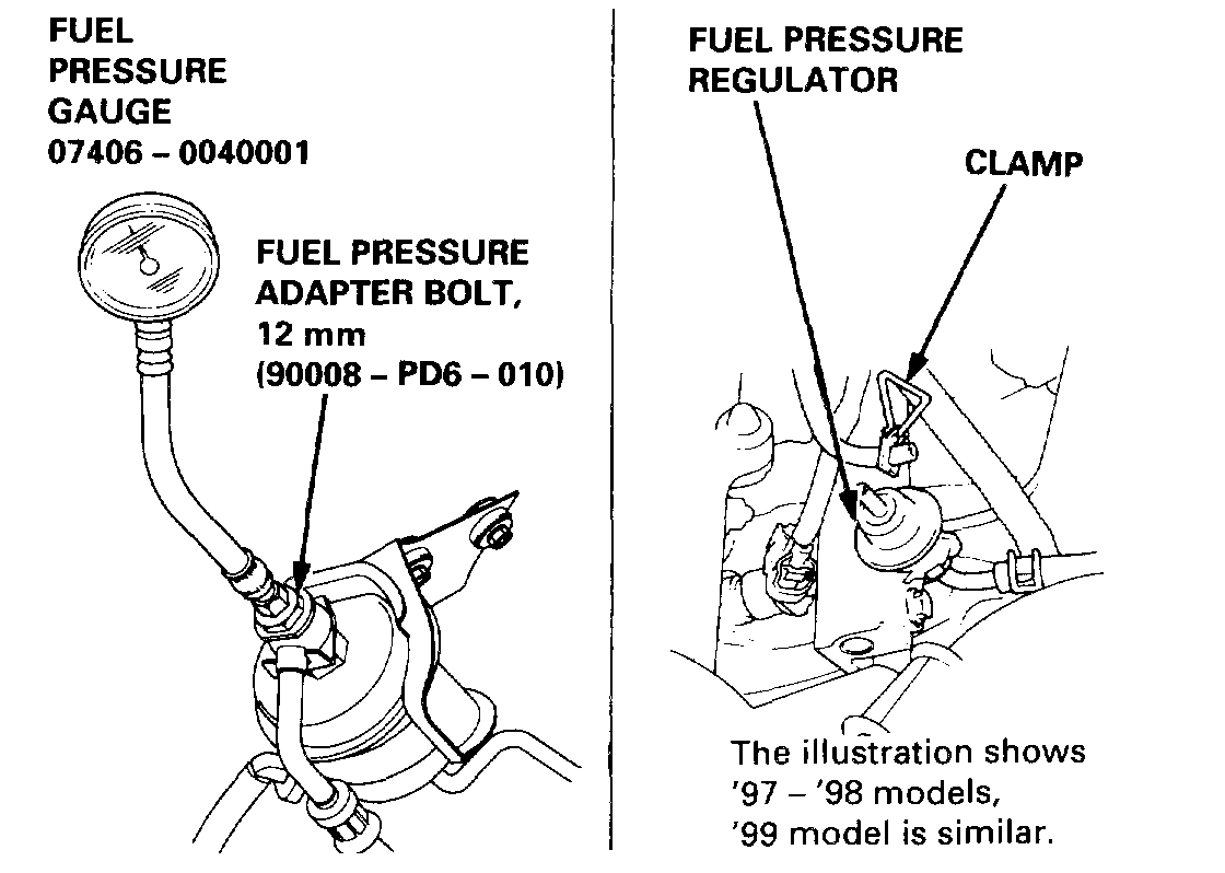

Here are the directions specific to your vehicle for checking fuel pressure. The attached pics correlate with the directions
COMPONENT TESTS AND GENERAL DIAGNOSTICS
Inspection
1. Relieve fuel pressure.
2. Remove the 12 mm banjo bolt on the fuel filter while holding the fuel filter with another wrench. Attach the 12 mm fuel pressure adapter bolt and the special tool.
3. Start the engine. Measure the fuel pressure with the engine idling and the vacuum hose of the fuel pressure regulator disconnected from the fuel pressure regulator and pinched. If the engine will not start, turn the ignition switch on (II), wait for two seconds, turn it off, then back on again and read the fuel pressure.
Pressure should be:
270 - 320 kPa (2.8 - 3.2 kg/Sq.cm, 40 - 47 psi)
4. Reconnect vacuum hose to the fuel pressure regulator.
Pressure should be:
220 - 260 kPa (2.2 - 2.7 kg/Sq.cm, 31 - 38 psi)
If the fuel pressure is not as specified, first check the fuel pump.
If the fuel pump is OK, check the following:
- If the fuel pressure is higher than specified, inspect for:
- Pinched or clogged fuel return hose or line.
- Faulty fuel pressure regulator.
- If the fuel pressure is lower than specified, inspect for:
- Clogged fuel filter.
- Fuel line leakage.

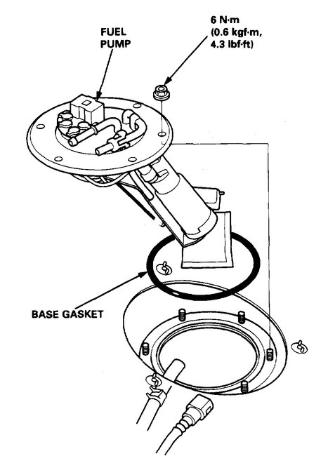

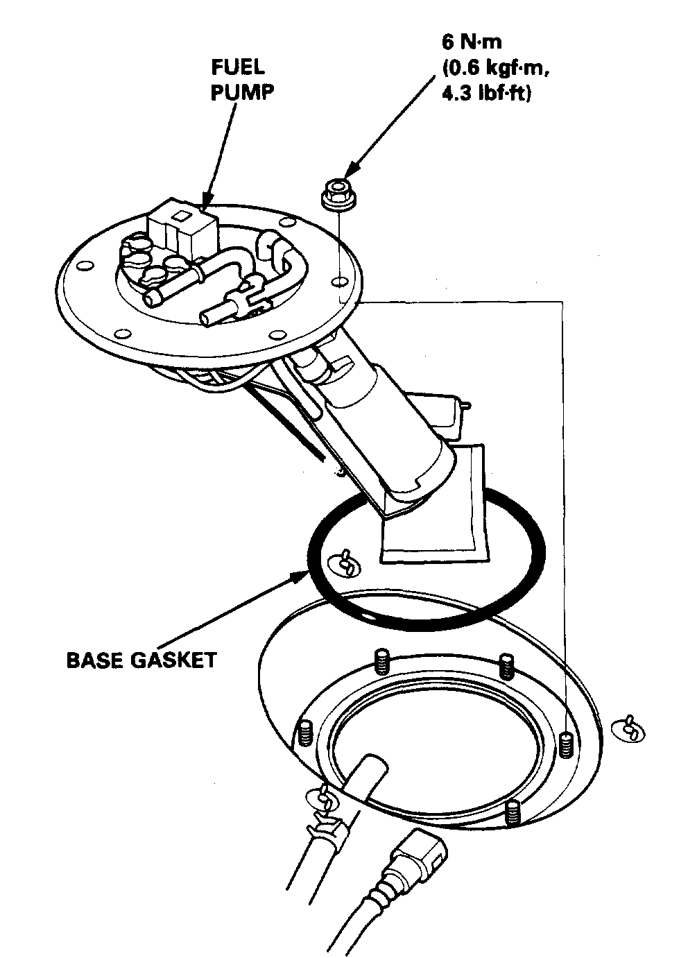

REPLACEMENT
WARNING: Do not smoke while working on fuel system Keep open flames away from your work area.
1. Fold the left rear seat cushion forward, and remove the base frame cover.
2. Remove the access panel from the floor.
3. Relieve the fuel pressure.
4. Disconnect the fuel lines.
5. Disconnect the 5P connector from the fuel pump.
6. Remove the fuel pump mounting nuts.
7. Remove the fuel pump from the fuel tank.
8. Install the fuel pump in the reverse order of removal.
